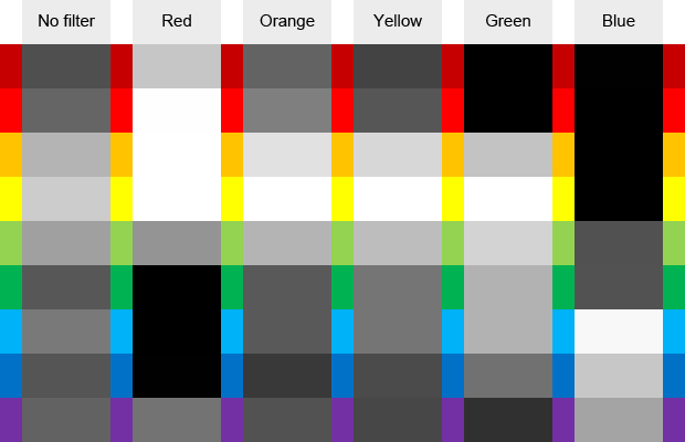

is there a resource somewhere that shows specific effects of specific filters
( maybe before and after images ). is there a definitive resource for this sort of thing?

I often refer to this chart for a rough idea of how a filter will affect colors in a scene:
