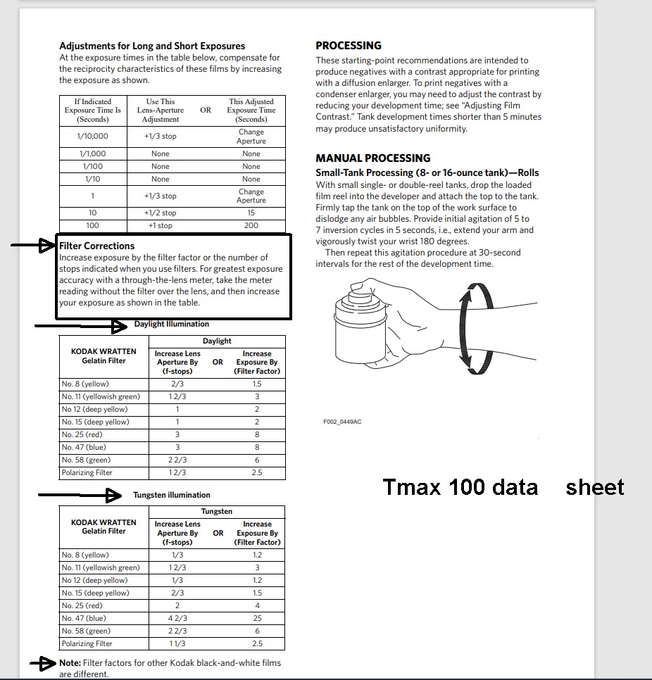

Tmax data sheet from Kodak says to take meter reading through camera without filter then apply the factor Kodak provides for each filter type.
Kodak's recommendation is the basic, "standard" way to use filter factors. It will yield good results in most cases. Use this method first; if you're happy with the results, then there's no reason to change to a different way of applying factors.
All the other methods in this thread are refinements of the above with the goal of either modifying the factors for deviations from average in illumination, overall subject color, etc., or to better visualize the effect of the filter (e.g., the metering-through-the-filter technique I describe above). All these different methods require a better knowledge of color theory and the spectral response of your film and meter as well as quite a bit of testing to be useful at all.
