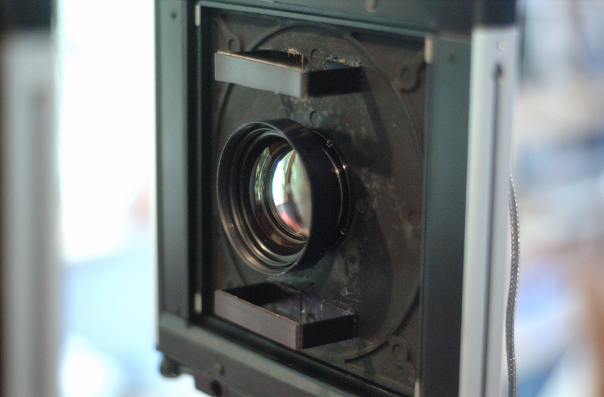

I just bought a Sinar camera and the person who sold it had done the most ingenious thing.
On the back of the lensboard he had glued two pieces of metal. They were c shaped, but square, so that each has a flat surface about two inches behind the board and i little behind the lens. They are steel. On each of his filters he glues two small flat magnets. Such that the filter simply magnetically sticks on behind the lens. No screws, no tape. They are fast to add or remove and can be stacked. Furthermore, there is no vignetting because they are much larger than the rearmost element on the lens.
I can post some pictures later, but all my memory cards are full and my digital camera's batteries havnt been charged in a while.

I would love to see pictures when you get a chance

What a great idea. I put velcro buttons on the back of lensboards and velcro on my 4 x 4 filter frames.

Here is a photo to describe what i spoke of before.
