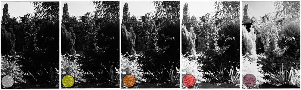

It's probably a bit late, but I did a comparison of various filters on infrared film.
I've attached it below.
The film used is Maco IR820C, but you'll get virtually the same effect on HIE.
The order is: No filter, Yellow, Orange, Red, Hoya R72
Hope this is of some use

Thanks Ben. This gives me really good look at what effect I can get with the filters that I already have.
Tony
