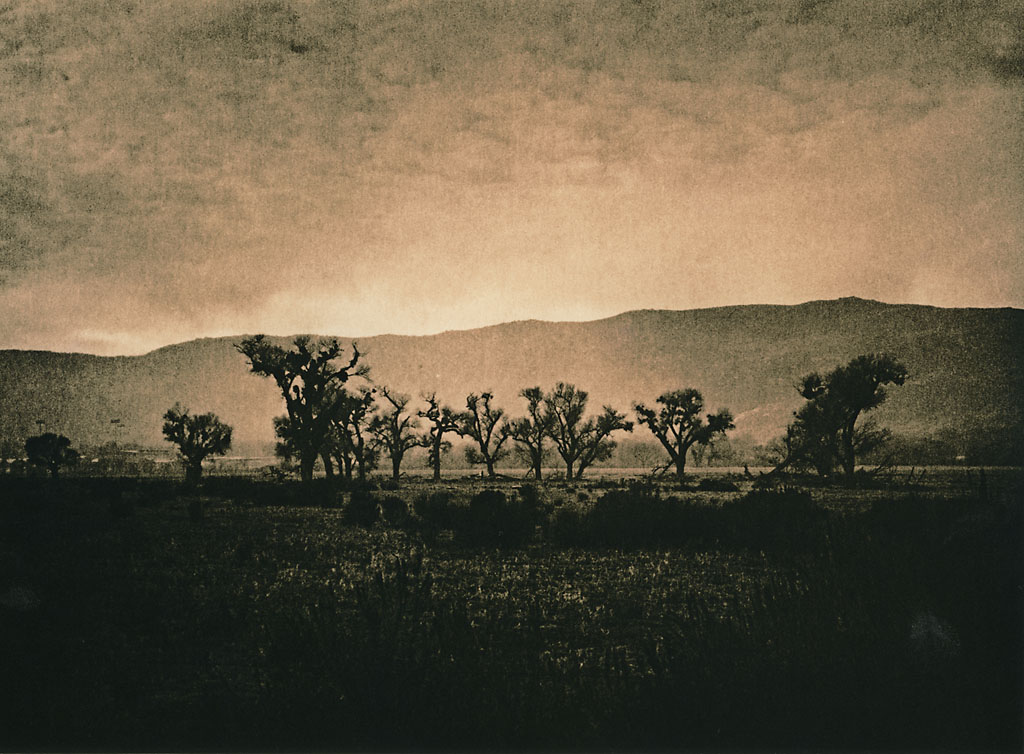

The image below was from a high-contrast scene and the grass in the foreground kept going all black before the clouds started showing any detail. This took a +3.5 stop exposure with a lot of burning in the sky and some dodging in the center of the image. I got one print I liked on old Forte Fortezo paper, but haven't been able to recreate it yet on new Foma 131 paper. Every paper is different and your choice of developer type and dilution will also make a difference.

Love the image!
The colours, the sky and sun...
Great print! But, I agree, it is difficult to get the same result with a different paper (and even with the same paper...).

Love the image!
