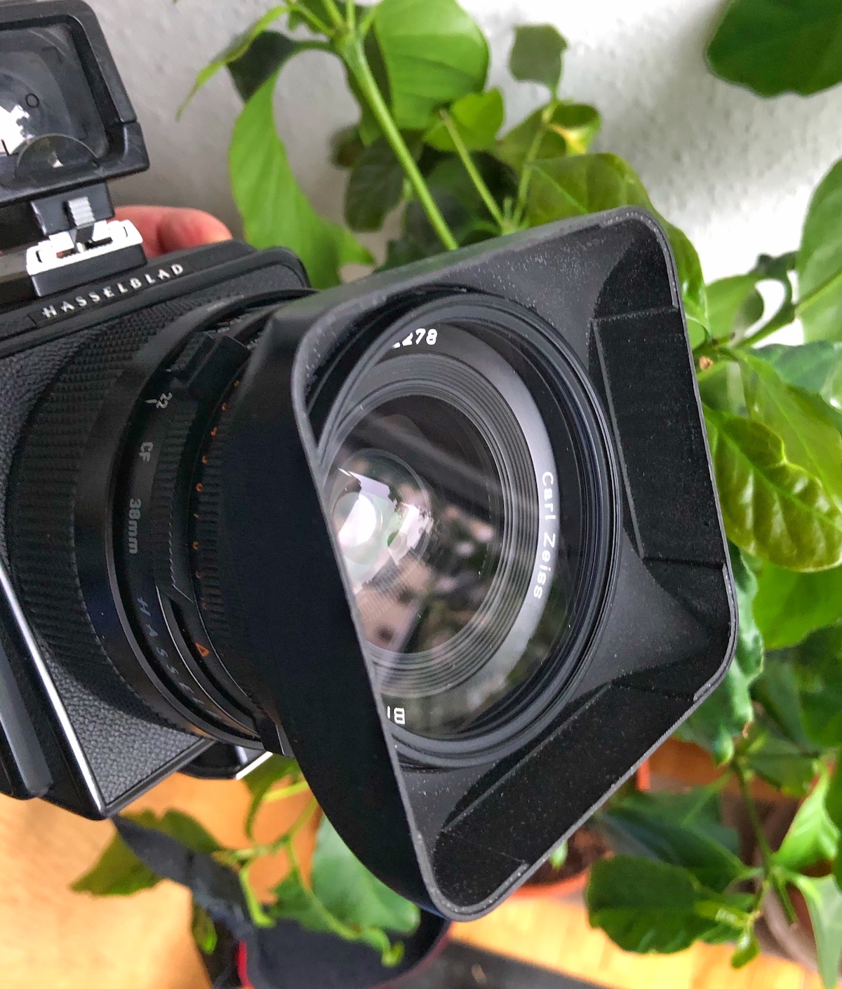

A partial follow-up:
I purchased the Heliopan B60->67mm step-up ring, and a Heliopan 67mm UV filter as the latter was priced fairly - and I had never tried this filter brand before. My other 67mm filters are B+H and have the approximately same thickness.
The adapter+filter is flush with the lens, thus allowing to add or remove the original Hasselblad hood without removing the step-up ring or filter.
The Heliopan filter is "slim" and about the same thickness as a "slim" B+W. The total extension combined is 8mm.
All metal is brass and has an assuring heft to it.
I will do an additional follow up regarding potential vignetting with this combo when I have developed the film.
Well congratulations, Nitroplait... good to see that you succeeded in accomplishing your goals. I must admit, although exceedingly spendy ... that's a very nice looking adapter. :smile: One thing to keep in mind, as with all short lens hoods, you might need to be aware of potential flare since the glass surface of the filter is a lot closer to the end of the hood than would be the glass surface of the lens without a filter. Just one more thing to be mindful of.
A final follow up:
Results from the above combo (902SWC with Heliopan B60 to 67mm adapter and a slim Heliopan UV filter) confirms that it causes no vignetting (as several posters have correctly stated).
A B60 to 67mm adapter with the SWC is very convenient as it allows you to use a much larger range of filters with your camera.
Thanks for the comments in this thread.
