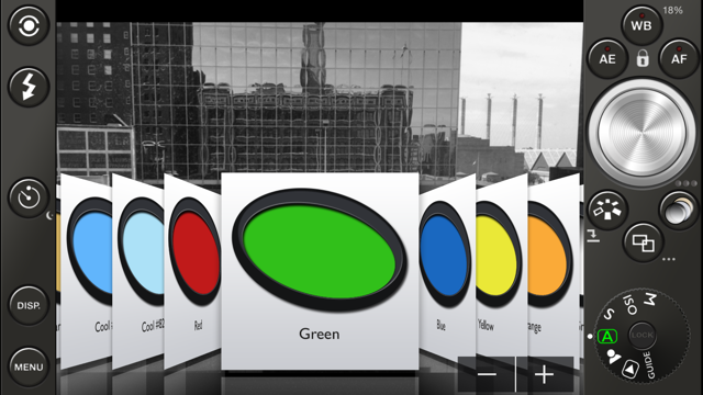

If you want to pre-visualize how a filter may impact a scene, and you have a smartphone, there are some very good apps that simulate this. I have an iPhone 6S+ and I use an app called 645PRO (shown above) which has many digital simulations of legacy b&w film types like Tri-X and HP5 in it, along with graduated and solid filters of all types including green... I use it sometimes like the way I used to do Polaroid 554/54 before visual - to help me understand it before I make the exposure of an important image. Hope that helps you.
