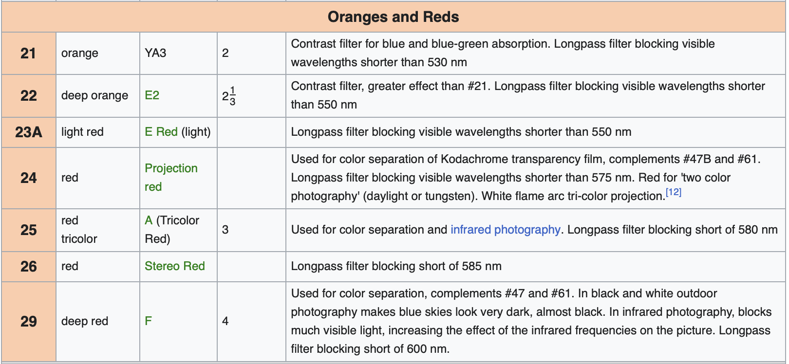

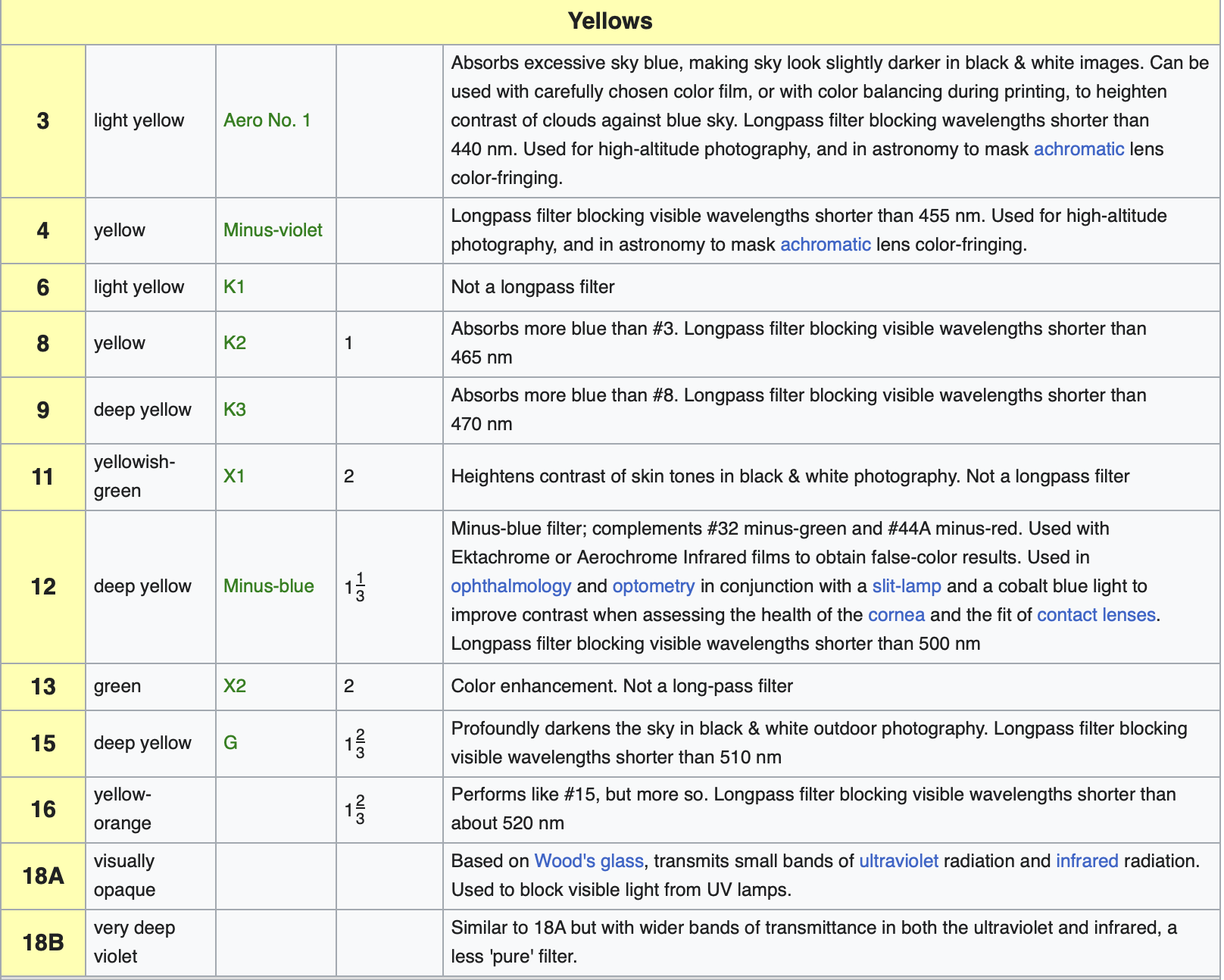

Wratten numbers for yellows and reds (from Wikipedia). I often see #8, #12, #15 and #25 on the used market. Tiffen seems to still make most of them. B-W only has #8 in yellow, I believe (at least, that's the only one available at B&H).

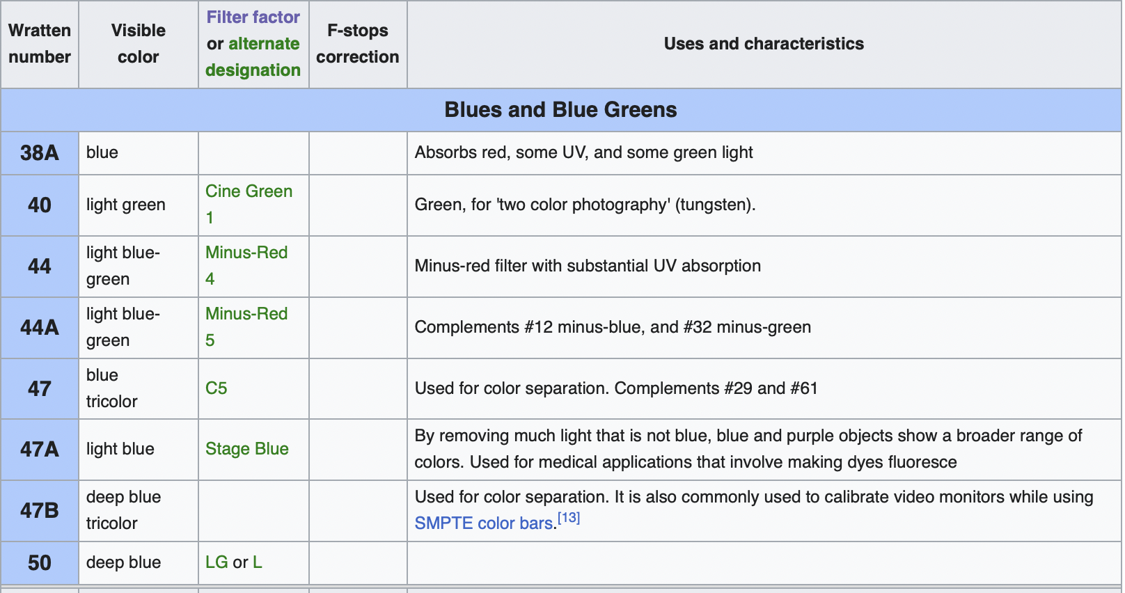

Try to find a full Wratten Filter Handbook at a used book store or website. It contains their considerable entire range of gel filters along with spectral charts, density values, and fading characteristics for each one. Of course, that doesn't tell you the specifics of glass filters from other manufacturers, but should provide a reasonable approximation. The list just posted is just a fraction of the options, but does include the most of the popular black and white contrast filters, plus a few rare examples.
The designations in green represent the older Wratten series numbering system, like you find in Ansel Adams writings.

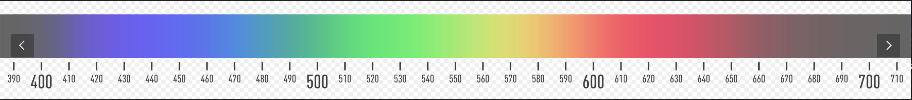

When you look at the actual wavelengths blocked, you understand why yellow #8 doesn't do that much to darken the sky. Blocks shorter than 465nm, but there's still a bit of blue between 465nm and around 480nm.
#15, which blocks shorter than 510nm, is much more effective.
