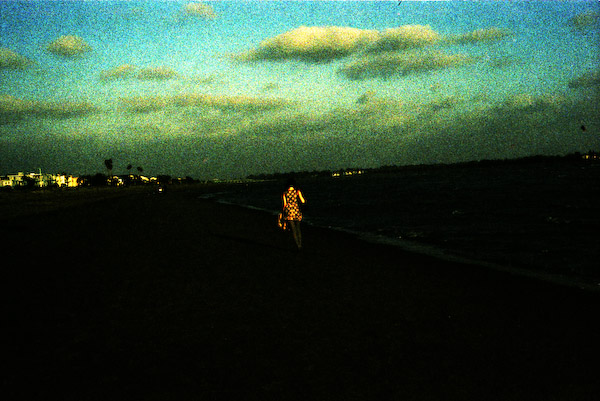

Unmarked fujichromes underexposed 1 stop, processed normally. Brilliant blues yellows, and greens. Exceptionally grainy. I have about ten in the fridge. Doesn't say astia or provia or anything like that. Just fujichrome. And RD 135. Mine expired in 1995, so just look for really old stuff.

attachment.php
That's the stuff I was talking about. It is relentlessly grainy. I made some prints from it, but the prints are too large to scan in.
