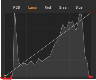

This is another thing I don't really understand about smart convert. There's this gap in the curve/levels, and maybe it's by design but other software doesn't do this so it's one less step of working the image normally.

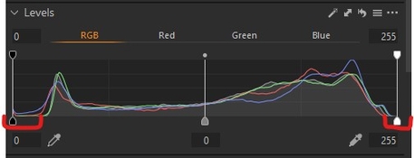

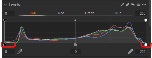

I haven't really liked the results I've gotten from SmartConvert. The tiff files from it don't seem to have the same amount of leeway as files converted using NLP. They also sharpen poorly. I love the way the app works, but I can't use it because of the lower quality output.
I mention this earlier in the thread but I had the same issue. SC output tended to clip the extremes leaving very little headroom for further edits, with no histogram or way of actually seeing things clip before its too late. This is with Vuescan raw DNGs - not camera digitization - by the way.

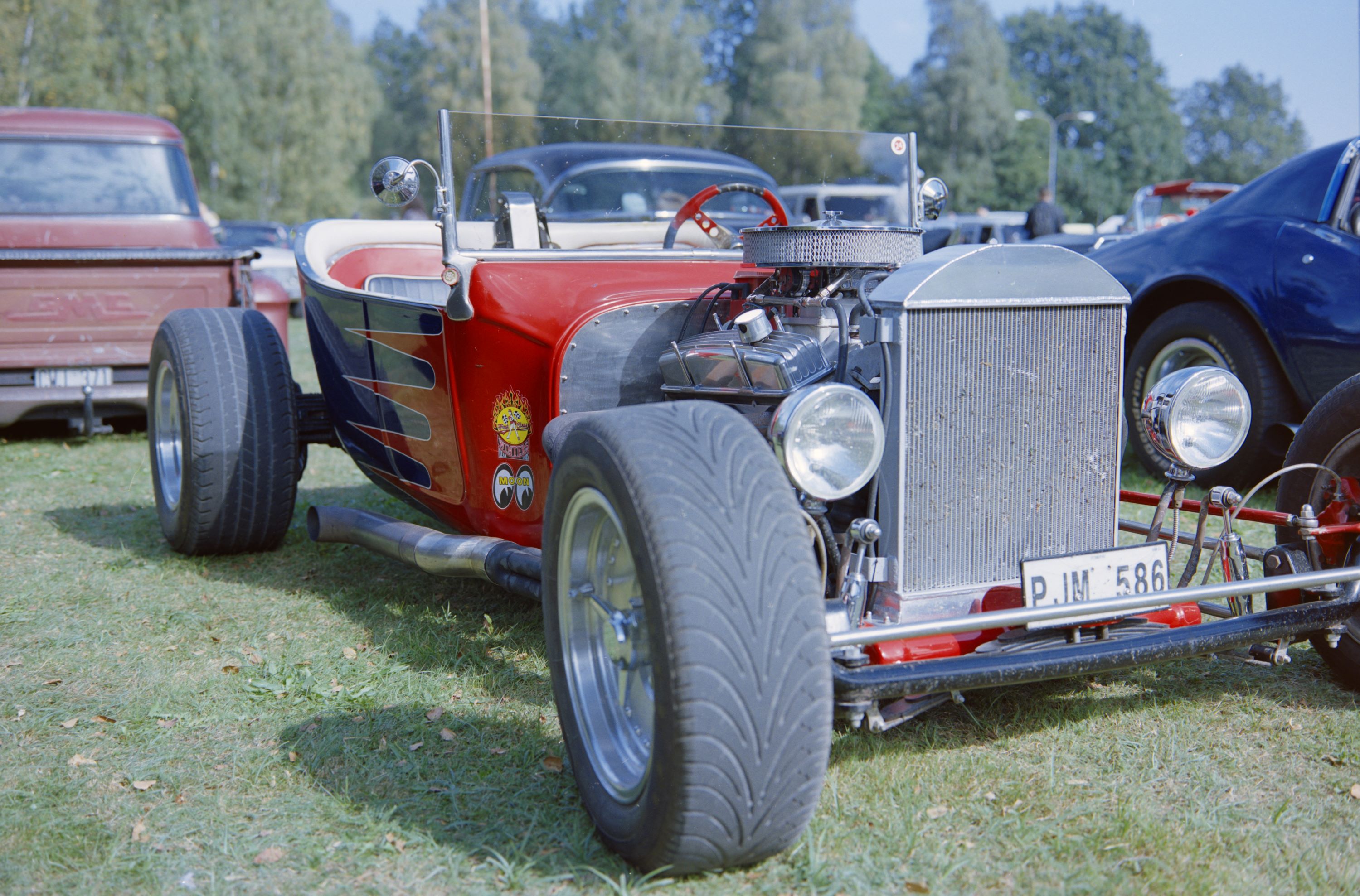

Can you show us conversions with colors that we could see that would be easily noticed if wrong such as blue skies, flesh tones of people, green grass and green foliage. There's little way to tell if the color in your two pictures are "correct".
Yeah, that's pretty cyan. Perfectly correctable to something pretty though.
Yes, I did nothing to it except increase density and saturation by two steps in the software.
