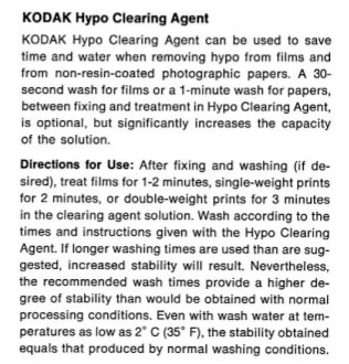

I find HCA very useful for film, and it is recommended by Kodak. Please see the attached clipping from page 34 of Kodak's Technical Publication J1. It shortens the wash time and gets rid of the annoying halation dye.
