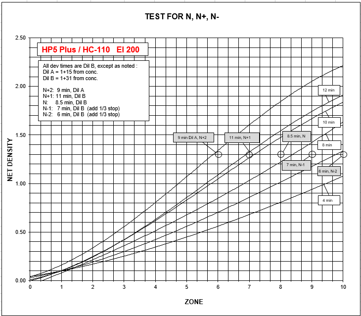

I was sufficiently up on the Excel learning curve from my day job prior to retiring that it was easy to set up my film testing files, which would not be useful to you as something you could just plug your data into. They were set up prior to getting Ralph's book and were based on the step-by-step procedure gleaned from Book 2 in this link:
https://www.amazon.com/Ansel-Adams-Guide-Techniques-Photography/dp/0821219561/ref=sr_1_4?crid=DJKB7D0M8SWE&keywords=basic+techniques+of+photography&qid=1556037629&s=gateway&sprefix=basic+techniques+,aps,431&sr=8-4
I also have Book 1 in the series, which I found useful for tray processing of sheet film, except for his suggestion to have film face DOWN in the tray; I choose to follow AA's face UP suggestion. I set up my white target indoors and illuminate it evenly with a pair of blue 5000K floods to approximate daylight. The camera is a 5x7 Sinar Norma and is easy to use a bellows shade to minimize flare. I also tape a .25" x .25" piece of aluminum foil to the film that insures a spot on the negative to read fb+fog (a tip from one of Howard Bond's articles).
BTW, the target net density for Zone VIII of 1.30 is per AA's recommendation for a diffusion enlarger.
