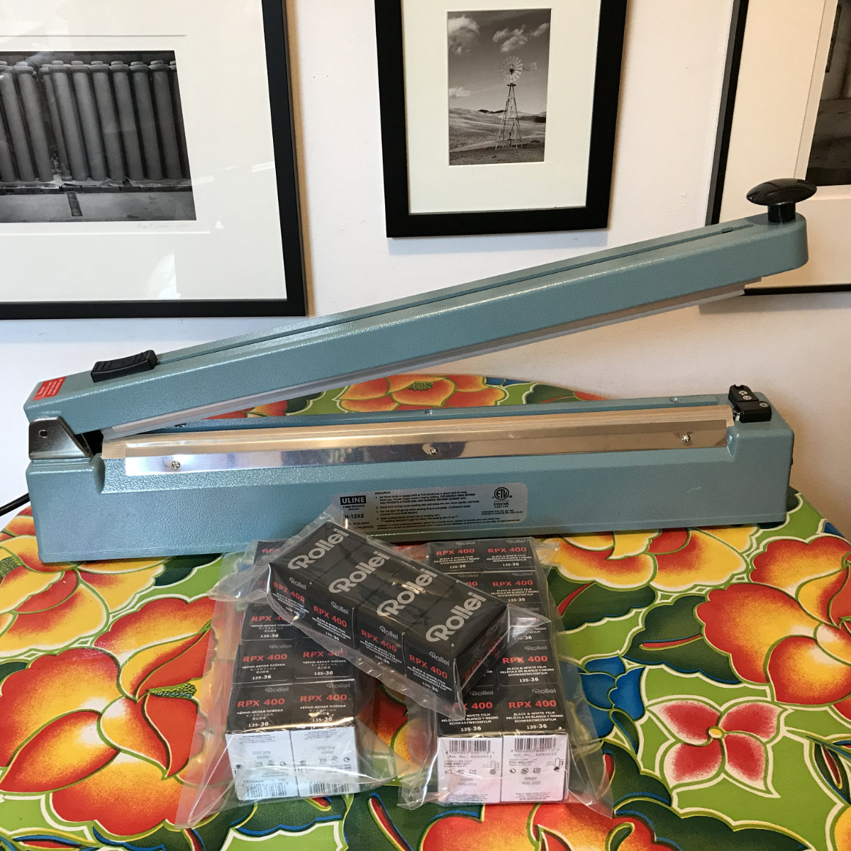

Finally bought an impulse sealer and am using up a stash of 4mil plastic bags that I’ve had for ages. Bought a big enough one to handle sheet film and paper. I’m pretty happy with it so far and feel that it’s a nice step up from ziplock bags.

A lot of my film gets bagged in 4 packs so once they come out of the freezer I shoot them. Doing the the 10 roll bricks is more the exception that the rule. But quite truthfully the impulse sealer is easier than closing a ziplock bag. Helps than my wife seems ok with the impulse sealer living permanently on the table in our breakfast nook.

But you have to reseal a new bag every time you need a box of film. Aren't Ziplocks more convenient?
Yah, I don't get it. Freezer zip lock bags work great and are reusable, and you don't have that guillotine thing sitting there which musta cost some $.

Roger Thoms
Nov 18, 2007
1,788
Flagstaff, AZ
8x10 Format
My method is just one route to go. I like the 4mil plastic and I have a good supply, plus I can size the bags to my needs and the seal is definitely better than a ziplock bag. Lol, that being said I just received a 300 count box of 1 quart and a 200 count box of 1 gallon Ziplock freezer bags so I do find the useful. Now I just got notification from the View Camera Store that that are shipping my 7x17 FP4 film, and that will definitely go in the 4mill bags and with the impulse sealer. As far as cost my impulse sealer came from Uline and cost about $250 so yes a pricey but it’s a high quality unit and big enough to handle 16x20 paper.
