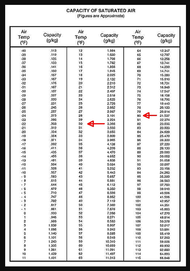

Actually, the air might be at lower relative humidity at higher temperatures. But it can hold more water vapor than at lower temperatures. That's why it always feels so dry in your throat during the winter and you need a humidifier. That's why humidity is always called relative humidity because it depends on what the temperature is. One square foot of air at let's say 30 degree F holds 1 pint of water vapor and reads 50% RH. But at 85 degrees, you can quadruple the water vapor and it will read 50% as well (These amounts are not accurate. I am just showing that there is a huge difference in RH and vapor depending on the temperature of the air).
This is why you have to be careful when you go from outside in winter into a hot house with your camera. The air around the cold camera cannot hold the moisture in your hotter house. So it condenses on the camera's metal or lens. In effect, it's reaching its dew point like dew on the grass on a cold morning.

Here's an interesting chart that show the differences in moisture in air at different temperatures at their saturation points. Actually, my 4 fold estimate was low. It's closer to 6 or 7 times difference between 30 and 80 degrees.
