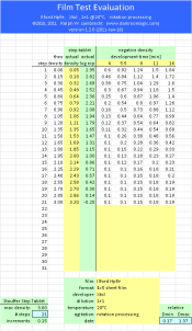

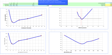

film graphs2.png Hi All,
Need a little help here. I am using Ralph Lambrech's spread sheet to determine my film speed.
A 21 step wedge was contact printed Hp5+ at f/8 .7 seconds in Xtol 1:1 @20c for the 4, 5.5, 11, and 16 minute intervals.
Could someone who is familiar with this procedure look at my graphs and tell me what is wrong? I am thinking my exposure is still too short as I am missing too many data points in the shorter development times?
I have a macbeth TD500 and I zeroed using the instruments light source. A calibrated step wedge indicates measurements are accurate.
Any help would greatly be appreciated.
Thanks

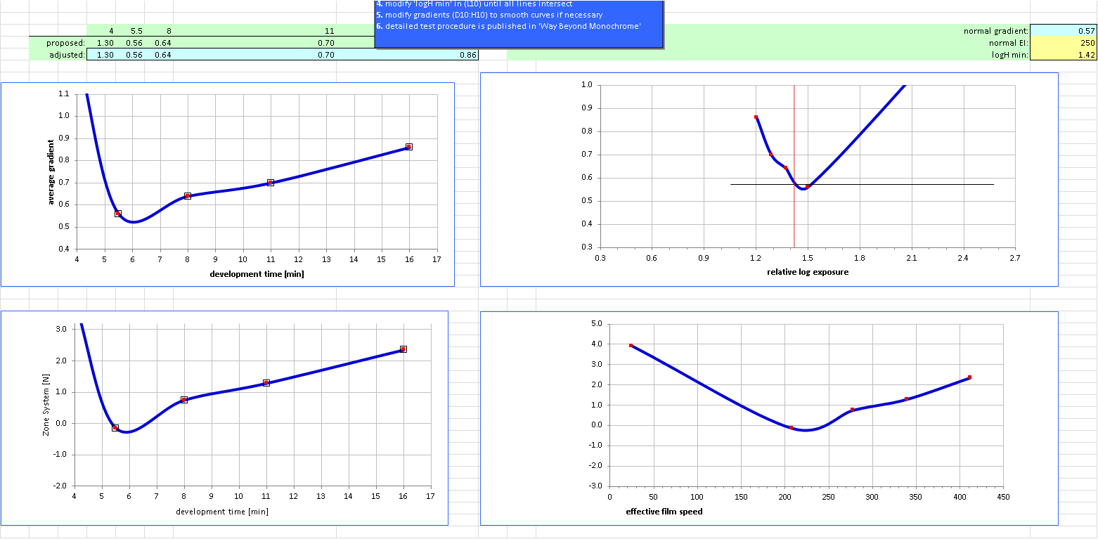

I've not used the spreadsheet you have, but it looks to me that you don't have enought exposure on your 4 min time for the sheet to calculate a valid gradient. Note that the 4 min point on the time vs. gradient graph is way up above the over points off the graph. It looks like that point is calculated to equal 1.90 gradient. We all know it should be less than the 5.6 min gradient.
I suggest rerunning the 4 min test and give the film about 4 stops more exposure to get more steps in the wedge to have usable density.

Looks like your 8 minute time came reasonably close to what I call normal, the curve that most closely fits ASA specifications. Since the spreadsheet shows that near 0.62, that confirms your test is sane.
As Kirk says, 4 stops more exposure would help for the 4 minute test. Next time you do a complete series, I would give 2 stops more exposure to all.
Of course it would have been better if you could see all the data in the highlights. But for darkroom printing, you only need to see what exposures gives you highlight densities around 1.00 to 1.20. You have enough information to make informed decisions about how long to develop your film.
Apart from the 4 minute test, the rest of the gradients look good.

Kirk, Bill and everyone else thank you. Even you pawlow, haters gonna hate. I figured that was the case with not enough info in the 4 min development data set. Smoothing out the curves helped. I am finding I need way more exposure that what has been typically posted to run tests like this. I must say it's quite easy and fast once you have an exposure that works. The data pretty much came in line with what I came up with prior to having a densitometer. It's nice to see the + and - also in one go. I am primarily going to use this for alternative printing in the future and want to have some sort of "quantification" so as not to waste expensive materials. Thanks again.
