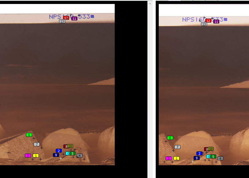

Oh, and the gotcha I mentioned above (in a previous post)? If scanning roll film DON'T include the lettering on the edges. The pano software (all 3 I tried) sees "PORTRA" in one place and two frames away sees another "PORTRA" and thinks that they are matching parts of separate frames, the results are interesting if not that useful :D I was tearing my hair out about this and with the other two programs I could do nothing about it as there was no information supplied. Then I looked at the control points automatically produced in PTgui and saw dozens of them clustered around these letters and numbers and realised the problem.
This pic shows a heap of good control points on the rocks but some up on the lettering as well.
This actual example would be OK because they are adjoining frames, I couldn't find an example of a bad match, but you get the idea.
All that said it does seem to be a problem with using RAW files as much as the lettering, so I just convert them to TIFF and either don't shoot the lettering or crop it out before feeding the images into PTgui.
