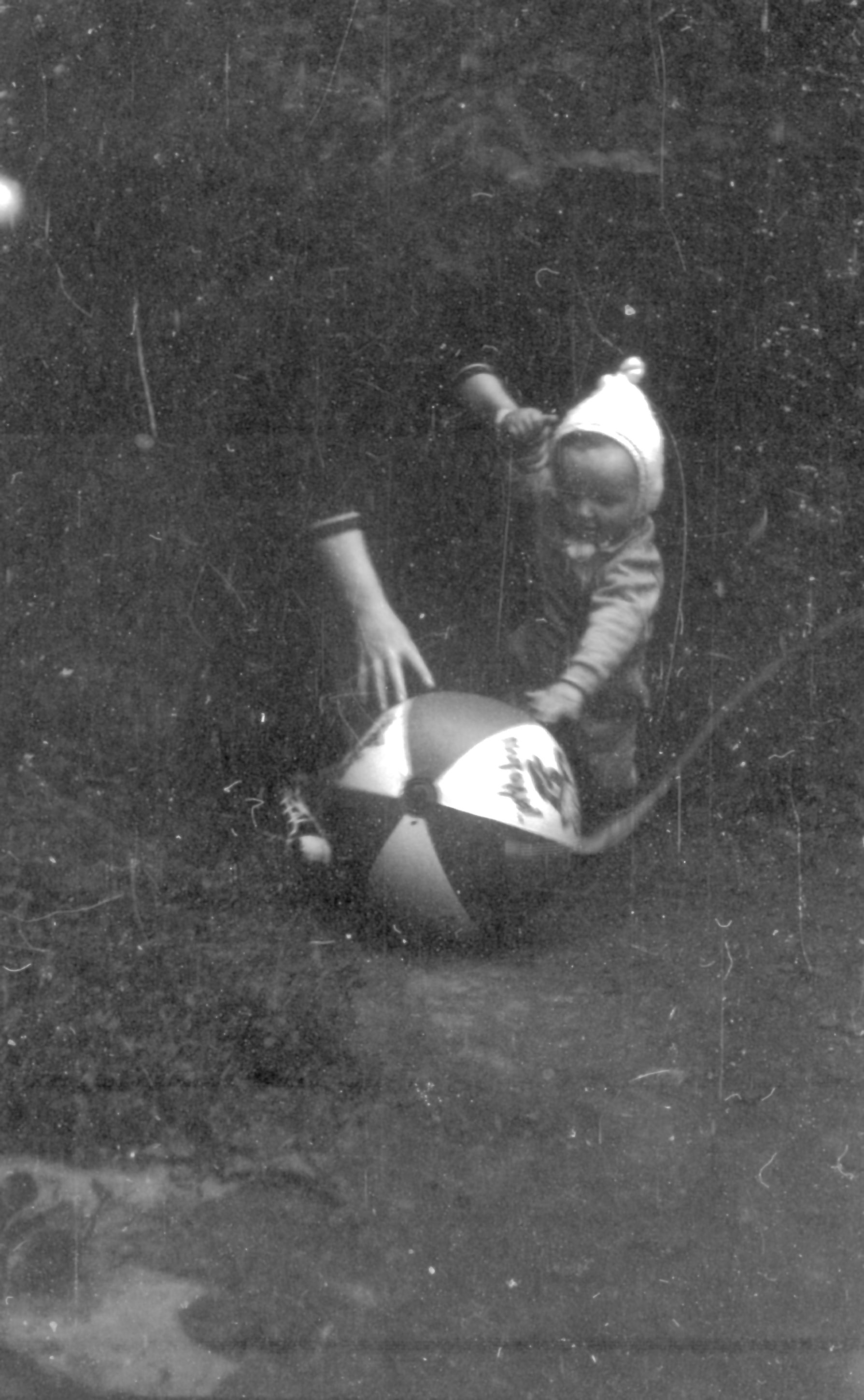

Dear Sirs, I scan my old films with family photos. Scanning of some from them are of ugly quality. The sample is on the photo attached. I heard it can be because of wrong exposition or underdeveloping. I use Vuescan for this job. I want to get as many details on resulting image as possible. Please write me, which scanners do you recommend or point criterias for scanner choice. The list of preferrable scanners is below. I do not want to use chemicals for films, because of no knowledge and equipment.

What did you use to scan with for those two pics you attached?
Are these from b&w film? If so, when you hold it up to the light, do the shadow areas you show here have no detail?
Do you have a local access to a mini lab where they run a Noritsu, Agfa or Fuji scanner? If so you should try them to see what you can get from those scanners and maybe we'll have more info we can provide to you.
Are they 35mm films? Are they regular silver negatives?

Yes, it is black and white film. I used Scanjet 4600 or HP g3010. There were no other accesible scanners to scan the films without cutting. No access to minіlab.If I shall have, I shall write. Nothing can be seen when putting the film to light. When scanning I turned off Restore Fading in Vuescan and got better but not sufficient result. The new result is below.

Given scanners you used, don't be discouraged by shown results, neither is made to deliver quality film scans. Think of them as document scanners with crude film scanning capability, an add on feature to help sell the product.
Although not on your list, I am satisfied with met Plustek 8100i. It works for 35mm, and there are third party holders that allow scanning of 126 and 110 negatives.
Looking at the scans, and especially the large amount of noise and dirt, I suspect that there is probably not much salvageable information in those two negatives. It just looks like a badly exposed negative. A better scanner likely would pick up a little more detail
As for actual quality of information on the negatives, they can be examined with good certainty on a light table with good quality loupe. I agree that shown scans appear to reveal they were not exposed/processed optimally, but scanners used were no champs either.
This is second reason, why I posted here. If Noritsu with some resolution make essential success, I shall have important parameter to chose other scanner for buying or getting in other ways.

@algusev It is a good idea to have same negs scanned by a good lab, so results will show you what can be expected. I would ask for best scans possible, so you can see the ceiling for expectations.
Yes, it is black and white film. I used Scanjet 4600 or HP g3010. There were no other accesible scanners to scan the films without cutting. No access to minіlab.If I shall have, I shall write. Nothing can be seen when putting the film to light. When scanning I turned off Restore Fading in Vuescan and got better but not sufficient result. The new result is below. View attachment 259781 View attachment 259781 View attachment 259781
if you do not see the detail in the film when you hold it up to light, you won’t get it in a scan.
Witold, please write me, how to define good lab. There are 5-7 minilanbs in my city with Noritsu or Nikon equipment. Peoples opinions on them are positive or they are unpopular.
