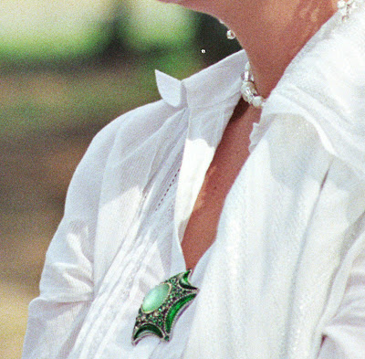

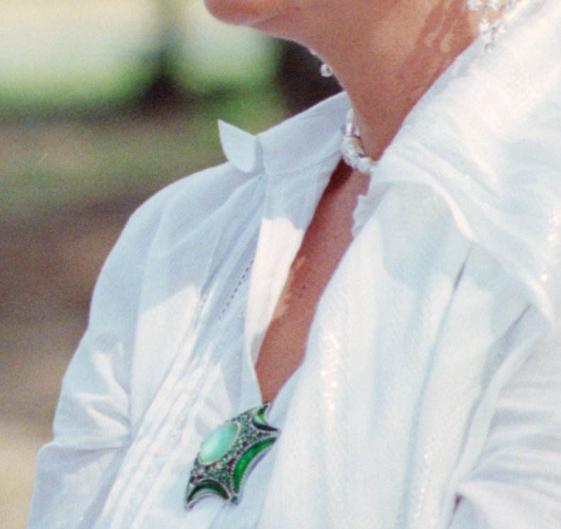

I have to disagree very strongly with the statement that the Epson V700 used for 35mm is "good enough for web sized images but definitely too little for bigger enlargements".
Used correctly, the V700 can produce files suitable for quite large prints. Key factors include getting the height adjustment of the film carrier right, and making sure the film is quite flat. Other contributors to quality are scanning at appropriate resolution, restrained use of sharpening when scanning, and skilled use of sharpening in post processing.
In my experience the V700 is not far off the performance of the Nikon LS4000/8000 series, the difference being that files from the Epson benefit from slightly more sharpening at the film grain/very fine detail level.
Before I retired I made many thousands of scans with the Nikon units as well as with various Epson flatbeds. My work was often used for large exhibit panels, so I know whereof I speak in terms of image quality.
Detail and sharpness are essential to my personal work. I commonly produce prints 18 to 24 inches across, and with particulary good negs can go to 36 inches across with excellent results.
I don't usuallly comment on scanner discussions, but I don't llike to see people discouraged from using a very useful, affordable tool.

Hi. As you did not quote anyone, I'm not certain which posting you were responding to. I agree with you that flatbed scanners are not as good as drum scanners.
On the other hand, it is possible to produce very good results from 35mm with the Epson V700. Not perfect, but certainly suitable for fairly large gallery-quality prints. I consider that acceptable. So did the many people who viewed my recent major show. I did it without oversampling, too.
You could get slightly better results with, say, an LS8000 (which I have used extensively)- and slightly more easily. At much higher cost. It took me a good many hours of tweaking to get where I wanted with the V700- but I did get there.
Unlike you, I do have extensive experience with the V700. I've also done a great deal of scanning with other units- Epson, Nikon, Canon and others- going back to the mid 1990s. On occasion I've had scans done with drum scanners when I considered it appropriate.
As a retired professional, I'm accustomed to having my work evaluated by clients who don't care what scanner I use. They simply want results. I was able to keep top-flight international exhibit designers and publishers happy very consistently over a 20-year film/digital technical career. (i.e. one very minor complaint about quality.)
I have a very cold-blooded approach to image quality, as many years ago I learned to judge my work based on my clients' requirements rather than my belief in a partcular piece of equipment.
In that context, I have to say that those of you dissing the V700 for 35mm scanning are not doing anyone a favour. My hands-on experience has been quite different.
As I said in my earlier posting, I am concerned that this sort of inaccuracy could deprive less experienced people of the opportunity to do nice work for a reasonable cost.
It is particularly frustrating to see very confident comments based on no actual experience with the equipment in question.
I have to admit I'm getting rather grouchy about this sort of thing. I like to see people actually doing things, learning, and having fun rather than being turned off by uber-perfectionists.
