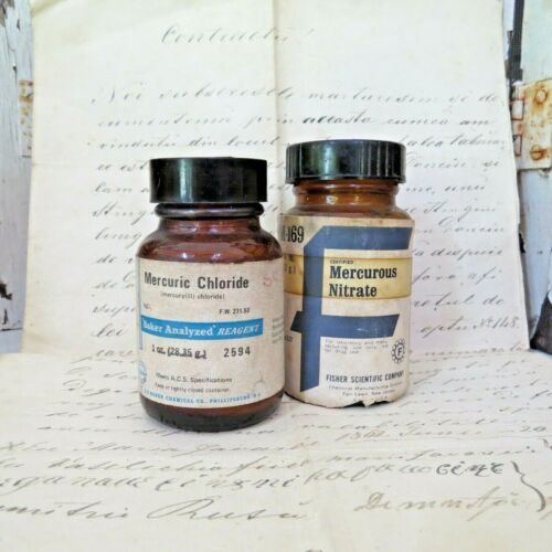

I found these listed on Ebay as "darkroom chemicals " some thrift shop had no idea. I told them to get these to the municipal authorities. There was a big ancient bottle of Calcium Carbide listed too. God forbid that get on a plane.
