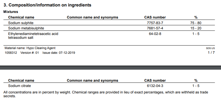

The MSDS for the Kodak product shows this:
The EDTA is the part that deals mostly with your hard water.
As I understand it, the relative proportions of the four listed ingredients aren't as critical with HCA than they are with most photo-chemicals. That is why just keeping the powder shaken up before each spoonful is removed gives acceptable results.

Sistan scavenges free silver-ions, by this covering even decay not related to bad washing.
I came here and posted this after reading parts 1 and 2 of the excellent Mysteries of the Vortex article. While the argument in favor of a short, strong fix and a subsequent shorter required washing time is strong, I have several years worth of Kodak powder fixer squirreled away, and since it seems it's absolutely possible to make fiber prints that will outlive me even with this outdated chemistry, I think I'll work my way through that before worrying about overhauling my entire approach to fixing.
At any rate, I have ordered and received some Kodak Hypo Clearing Agent. It seem it can be mixed one shot per printing session and discarded without racking up a lot of expense. So that's the right solution for me. Thanks all.
