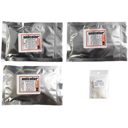

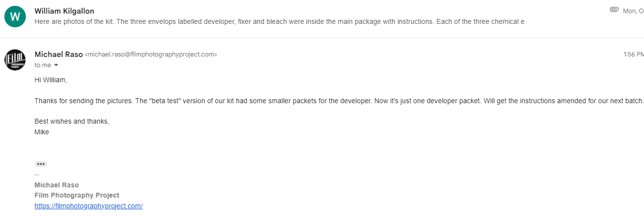

The kit has three packets of powdered chemicals, developer, bleach and fixer. The confusing thing is the instructions said to mix developer in sequence, package one to five but there was only one package.
Maybe another email to the film photography project.
They already emailed me that they have never tested sheet film.

I think when you open the developer packet, you will find some smaller packets that they describe. Same with bleach & fix. At least that's what I think I remember...

Michael Raso did give me contact information to someone who had developed 4x5. that person has not replied to my questions.
