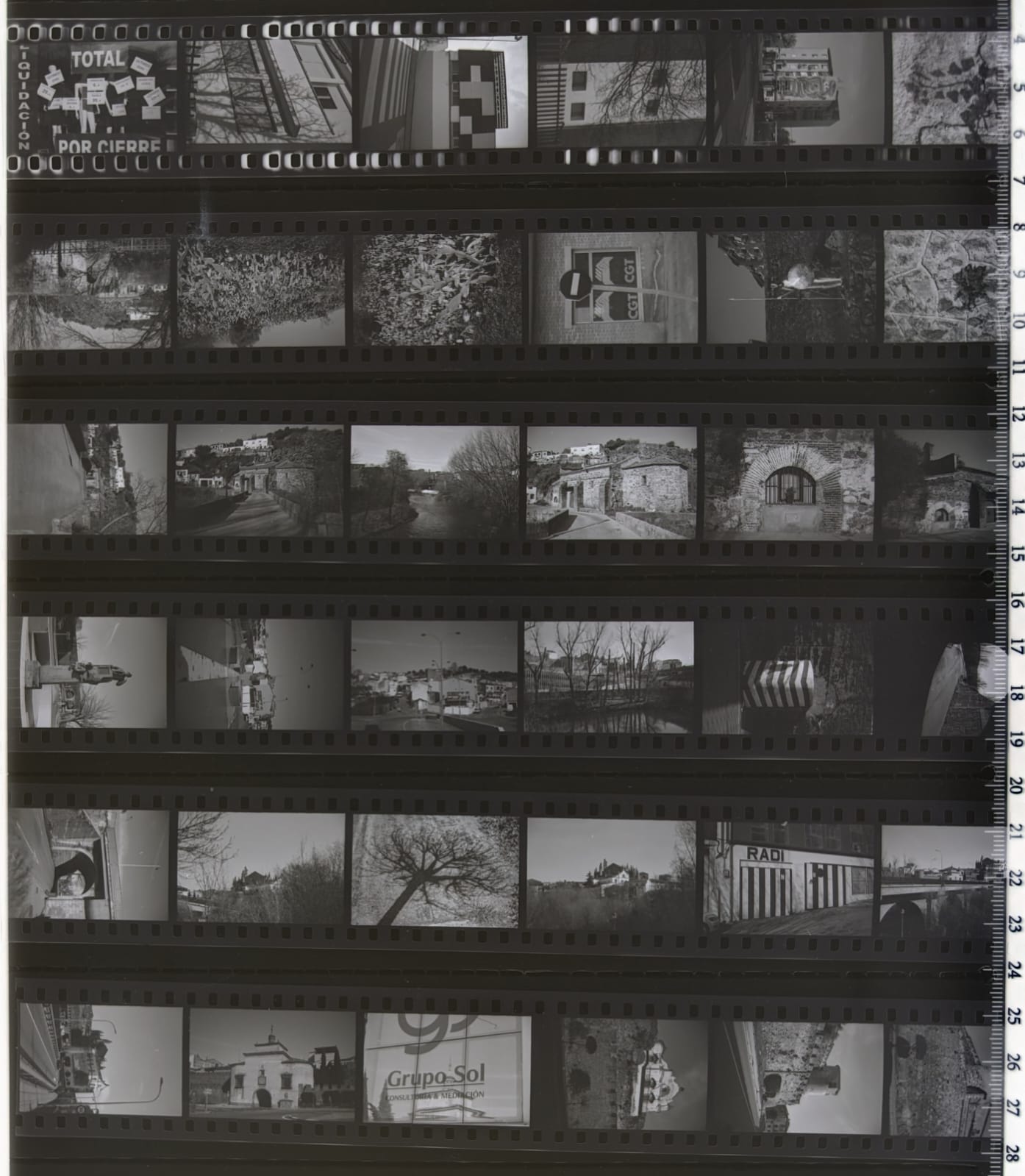

In the end I trusted my intuition and followed the drop test which gave me about 11 minutes. Here are the results. Adox HC-110, 1/31, 20º, 11'.

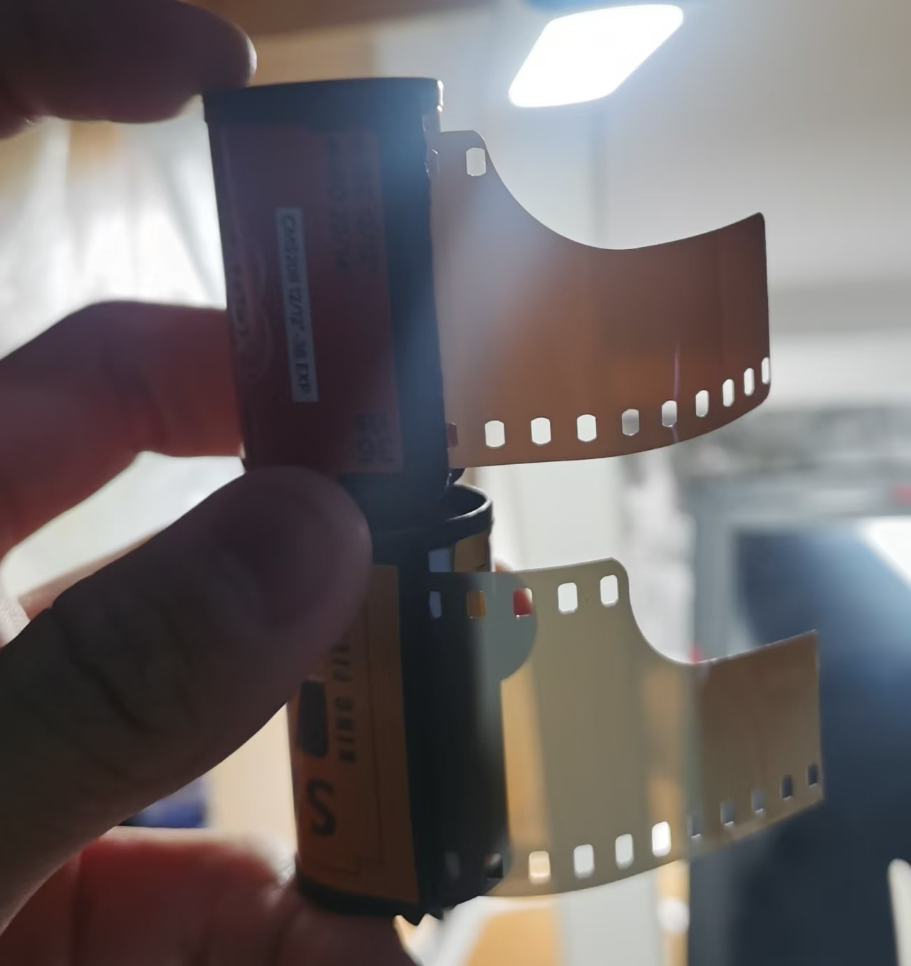

Interesting No edge marking and still film perforations and real continuous tone. I have no idea what that film is.
Look how the film was mounted on the chassis, the old-fashioned way, hahaha
If you peeled up the sticker on the film cassette you might find another one underneath.

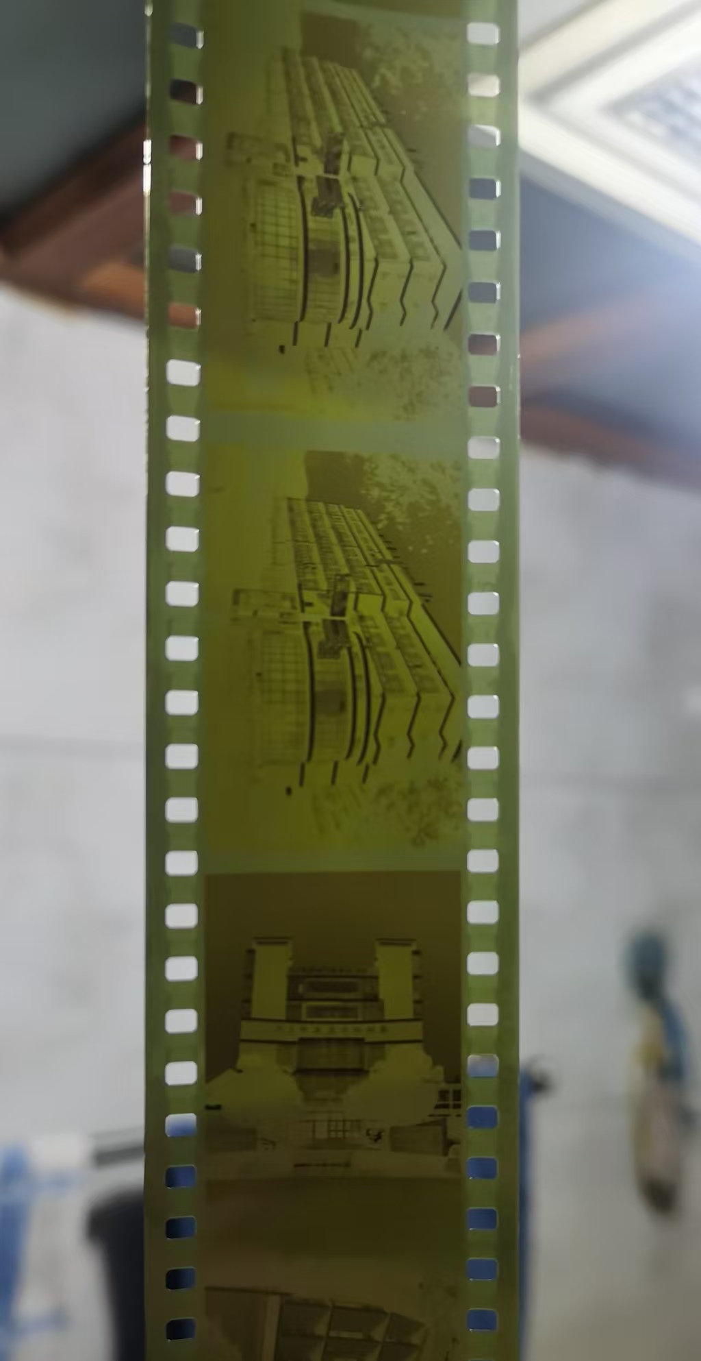

It seems to be Kodak 2383 film as I got some degree of color using a CD4 based low contrast film developer posted here.
That's an interesting thought. If that's the case, I would have expected it to be significantly slower.
Can you post an example of the colors you got?

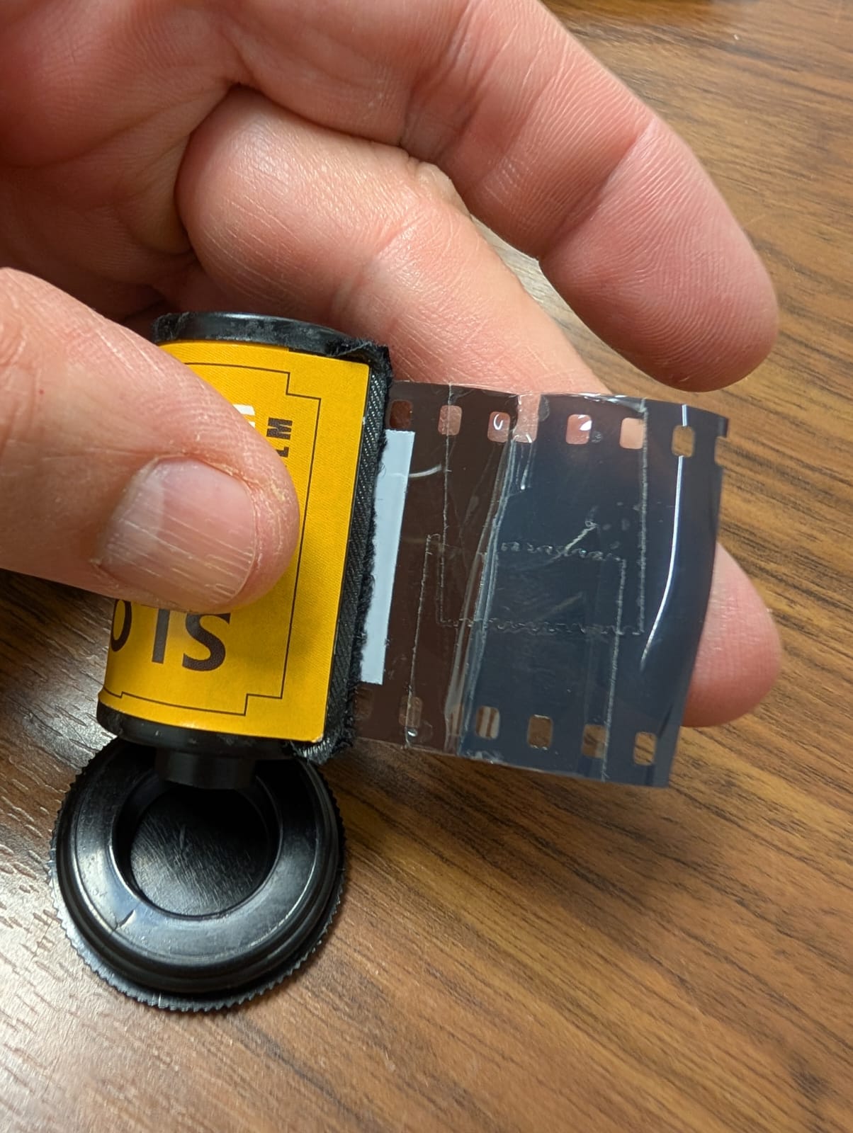

Here is what it came out looking like
I also compared it with a real thin emulsion copy film (CMS20II) as I found the semi-transparent base quite interesting
