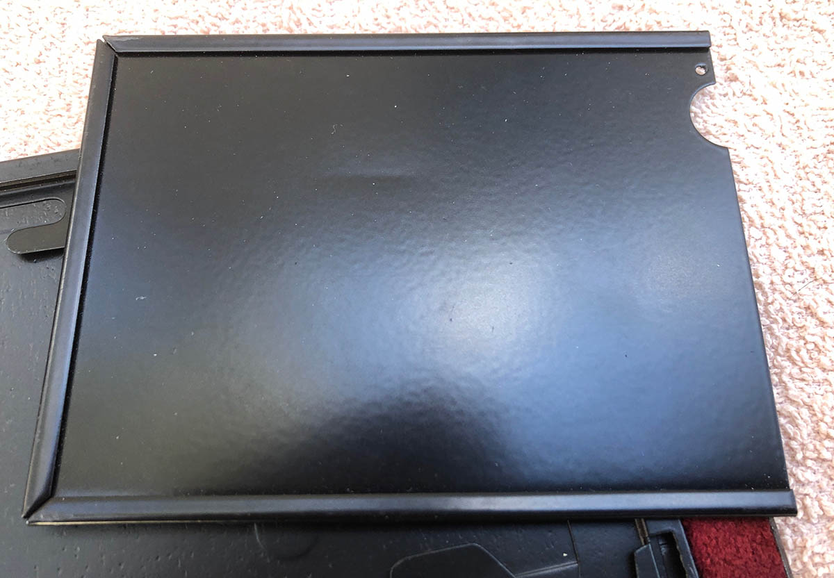

I have a question about these film inserts - please see pictures below.
I bought these film inserts from the
Is this a "correct" design for film inserts for single sided European 9x12 plate holders?

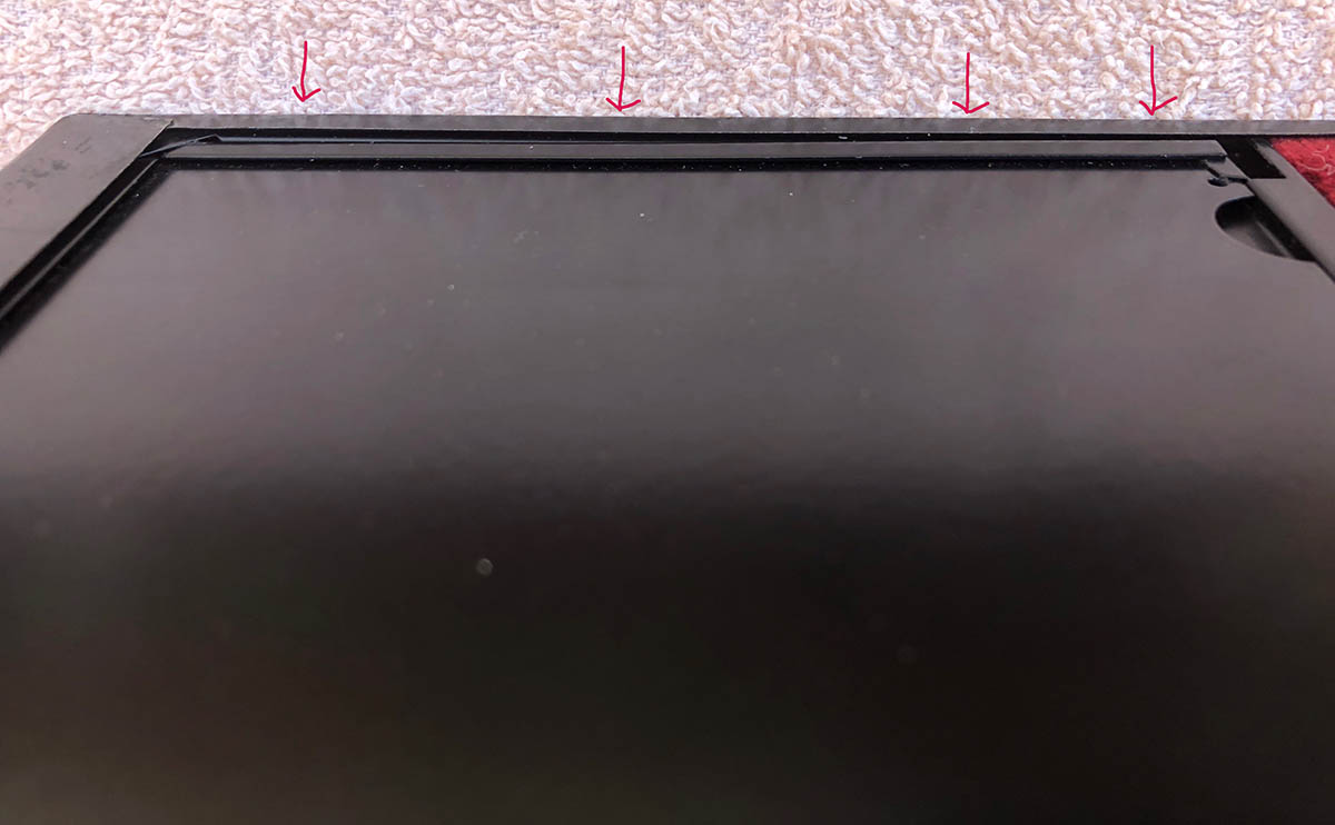

The insert seems to not sit flat in the plate holder - The thickness of the metal insert that wraps around the edge of the film does seem to make the film lay at an angle.

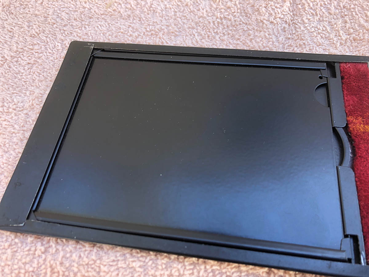

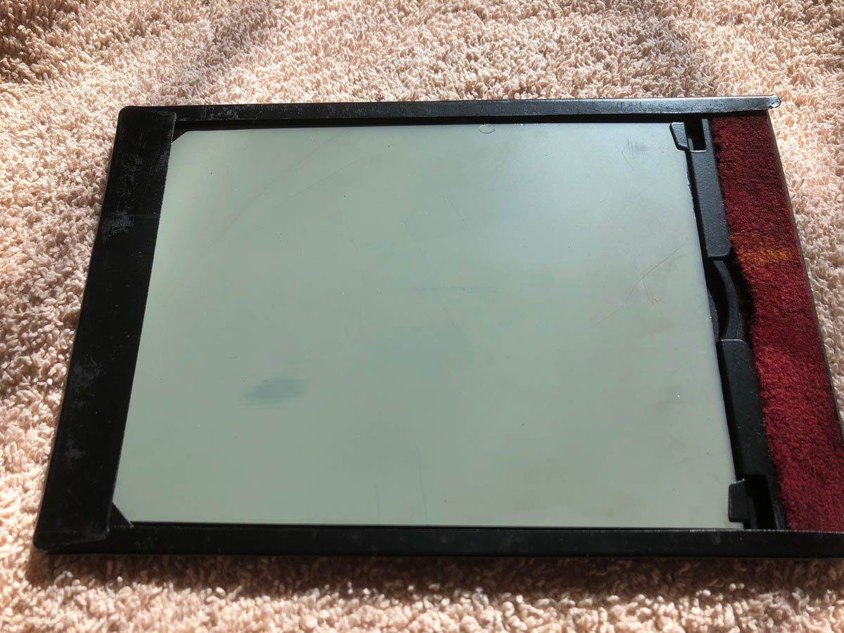

Pictures below show the holder with a glass plate, the new insert, the insert sitting in the plate holder.
Doesn't it seem like any film insert that has a thickness along one short side (rolled edge for holding film) and does not have that thickness on the opposite short side edge would create an uneven film plane?
Thanks,
Robert
Insert not laying flat
Glass plate sits flat
New Film insert from Retro Photo Supply place in Poland
Insert in glass plate holder looks good in general but...

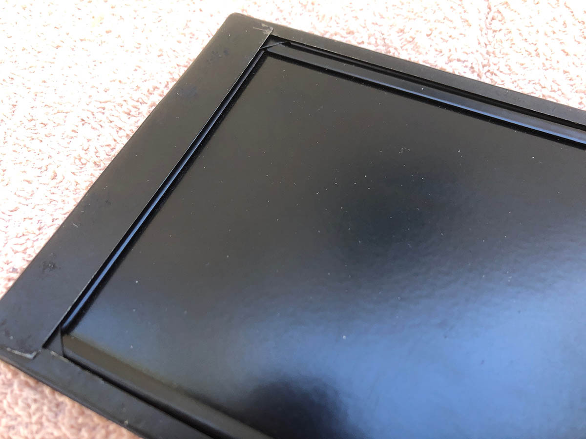

closer look at left end where insert slides under
not laying flat. Is this normal for inserts?
In the upper right of the first photo, the retaining clip is under the rolled edge of the film sheath. It should be over, but the fact it can go under is the problem. You have the sheath in backward.
Flip it end for end, keeping the open side up, and it'll be level. You'll have to load the film into the sheaths, then load the sheaths into the plate holder, with this orientation -- but this is the way I've always done it for my Zeiss Ideal, which has similar retaining clips.

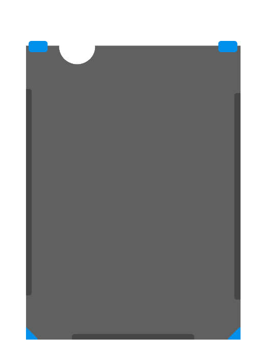

This is how how the film sheath would ideally sit in these holders. (Blue = the clips and corners of the plate holder.) Then the film will sit flat and parallell to the lens, just like a plate would.
I've got a dozen plate holders for my Ideal cameras (9x12) and had three with my Patent Etui (traded away around 2006). I've never seen one with those gaps in the corners of the closed end. I agree, such a sheath would work as desired, and put the film at the original emulsion plane of a plate -- but from my experience, they don't exist.
They are common here in Europe. My AGFA film sheaths from before the war (When AGFA was part of I.G. Farben) and later ORWO ones are all like this.
I got a couple of american KODAK holders, and unbranded ones, that have a pressure plate and hinged frame, so you can use both plates and sheet film. You release the clips holding the frame and it springs open, and then you load the plate or film and close it. But the focal plane is slanted, so they are unusable both for plates and film. And there is no way to fix them. They were made that way.
The side of the film sheath with the cutout should be the up side. You could cut the corners of the folded parts at the bottom so they will fit in these holders. Look at these film sheaths from ORWO. They would fit perfectly in your holders due to how the corners are cut:

I agree that this design with no corners would be the best and put the film in the same plane as a glass plate would have been.
I do have a jeweler's saw so I could cut the corners like the ones that are linked to above and the diagram. A jeweler's saw is an extremely fine metal cutting saw with a wire like cutting blade.
