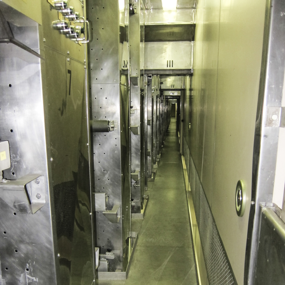

They have added some more photos of the plant along with a blog, very interesting read. This appears to be what i think is the "big boy" coater.
Dead Link Removed

Nzoomed
Mar 30, 2012
1,279
A Dead Link Removed mentioned by @Nzoomed...
Thanks for posting the link, it is a real interesting read, but i have so many questions.
Firstly, there is only so much they can fit into that tiny LRF building, and im unsure how they can modify the parts from the big boy coater and join it up to the small coater in the LRF to make a larger scale production line, even those photos of the packaging departments for each film format, eg 110, 126, 35mm etc looks like they take up a reasonable amount of room for each format.
I would have been hoping they could have taken ownership of the buildings and done all necessary modifications inside without having to strip all the equipment, it looks easier to me anyway, but i dont know what they are actually planning to do with all this equipment, they claim they have salvaged lots of equipment already, and i guess that some of it is what we have seen in those photos, but im sure thats only a small portion of the plant, and how much equipment do they need into the future?
I wouldnt know where to start, there is such a huge amount of equipment in that complex its unimaginable how they would even have the time to get it removed from the buildings, some of it looks so large its possible that the outside walls would have to be cut open (particuarly with big boy) just to remove it. Its almost like the equipment was built inside as part of the building itself if you know what i mean.
But i guess these guys know what they are doing, and alot of the equipment probably is useless for the future market of film, but once its gone, its gone.
I still am unsure if a new factory is being built or not, because as i said, all this gear physically cant fit in the LRF, (with the exception of film perforators and other similar equipment) even modifying their research coater would be a squeeze, its actually alot smaller than what i thought after seeing photos and the walk around video.
If they do plan on constructing a new purpose built facility, all of this just makes way more sense to me.
