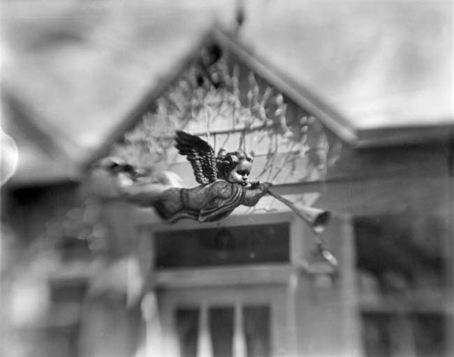

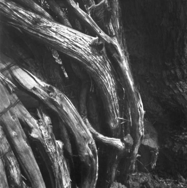

I've been watching this thread with interest, as last week I just embarked on some experiments with APHS as an in-camera film.
For background, I've lurked here for awhile, posted a few times, but spend a lot of time over on F295 doing the pinhole and alternative lens thing.
Last week I loaded up some 4x5 film holders with APHS and headed to Madrid, NM, a former coal mining town on the 'Turquoise Trail', between Abq and Santa Fe. My cameras were a Speed Graphic with a homemade lens, fashioned from a 7x50mm binocular objective, operating wide open at F3; and a pinhole camera operating at F416.
In order to control contrast in bright sunlight with this film, I did three things:
1) Pre-exposed the film in-camera. I have a piece of 1/8" thick white, frosted plastic, which functions to reduce the light throughput by ~2/3 stop. I placed this over the lens or pinhole and made a pre-exposure equal in time duration to the main scene's exposure.
2) Develop using a mixture of dilute HC110 and Agfa Neutol WA. I only used this mixture because it's what I had on hand; perhaps a 3-part developer, as suggested earlier, would work better.
3) I contact printed the resulting negative on VC paper using a grade 00 filter.
The results can be seen in these two examples, the first from the F3 binocular lens and contact printed using a grade 2 filter, and the second from the F416 pinhole, contact printed using a grade 00 filter.
The pinhole negative is intrinsically higher in contrast due to it being a sharper image than the improvised binocular lens image, thus requiring a lower grade of printing filter.
I'm hoping to refine this technique on APHS negatives exposed in high-contrast light, like the pinhole example, so as to enable them to print on a more 'normal' contrast grade of paper.
~Joe

I like the image of the cherub with the horn. Regardless of film or equipment matters, the image just works. :smile:
Neal
