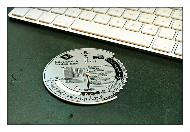

Another way could be a vintage exposure calculator.https://www.google.com/search?q=exp...hAhUEL1AKHR6NBYoQsAR6BAgJEAE&biw=2144&bih=982
I have an AGFA branded one and it's a nice and reliable tool.
You beat me by 6 minutes...
That dial likely is the most advanced amongst the commercial ones. I do not know whether there was an English version of it.
(I did not even come across the German version so far...)

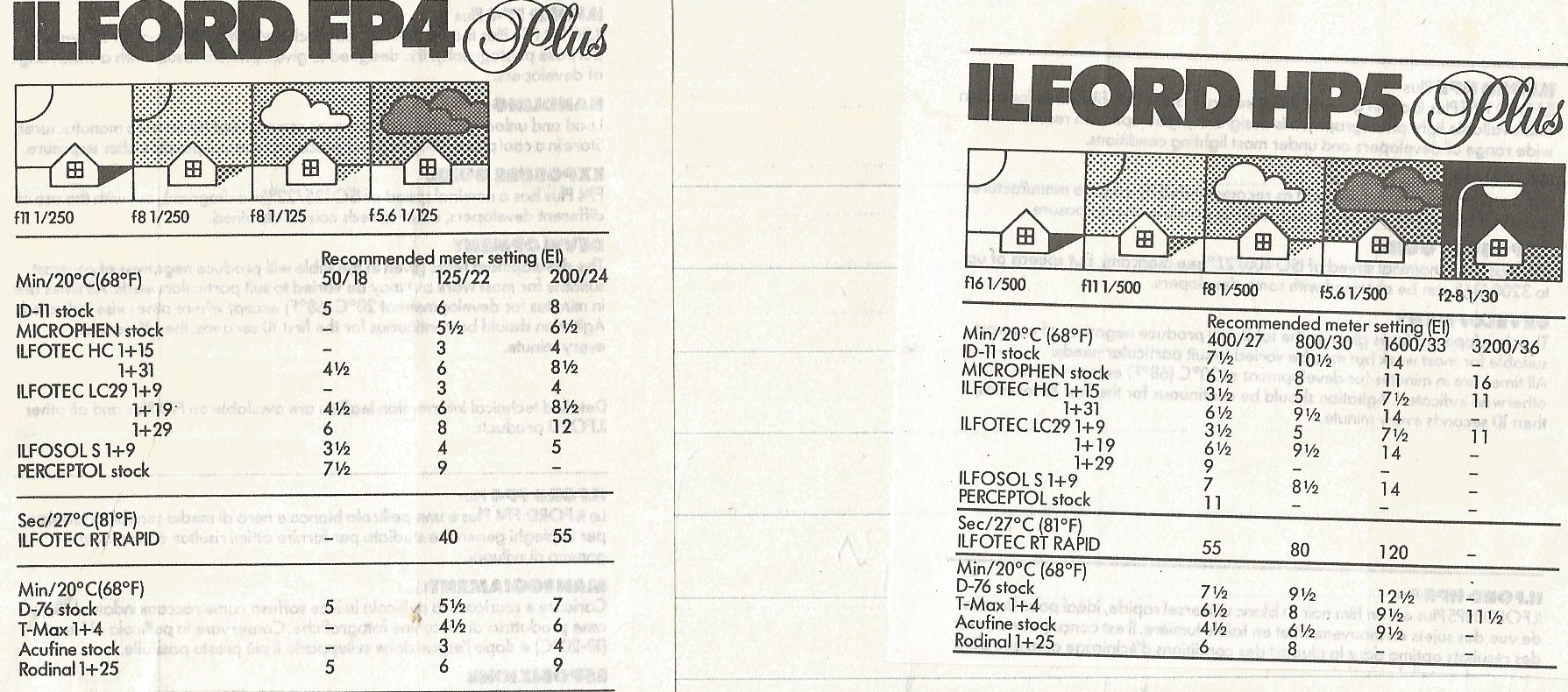

These came with Ilford films with handy recommendations on processing back in the 80s, I think. What more do you need?
