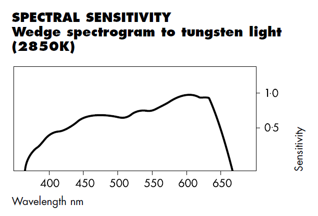

Generally speaking, if the light source has a wavelength longer than about 750 nM then film will not be fogged. Most datasheets have a spectral sensitivity curve. This one is for Ilford FP4+.
Above about 675 nm it's insensitive. Incidentally, a healthy human eye can see from violet at about 400nM through to deep red at about 700 nM wavelength. This also shows why a UV cut filter is useful. The film is sensitive to light we don't see at the UV end, so using a UV cut filter makes the scene more like we saw it.
Also another useless fact, a lot of astrophotograpy of emission nebulae happens in deep red around 656 nM. FP4+ is pretty insensitive there, and wouldn't be a good choice if you wanted to use film.
