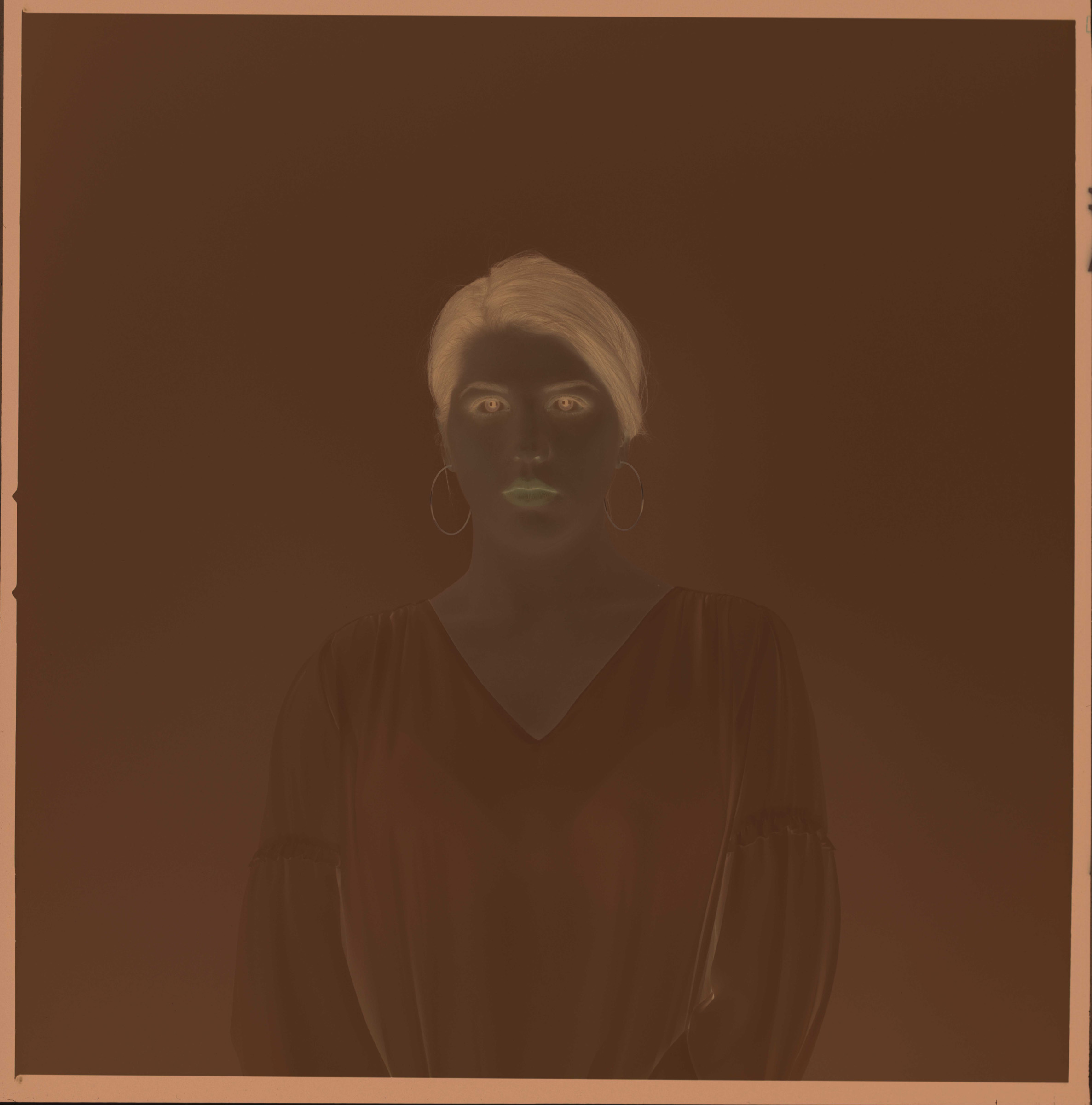

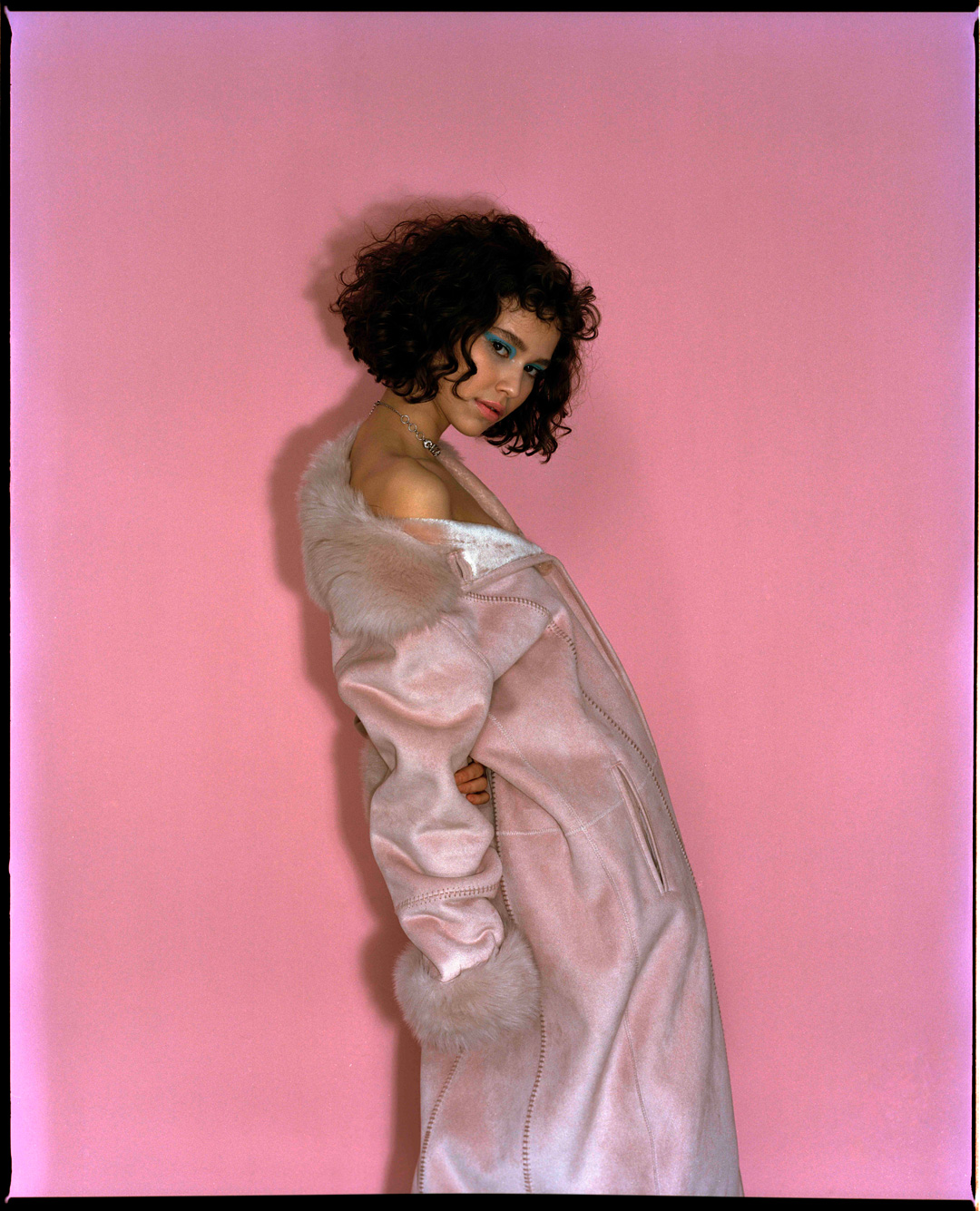

I'm curious to know if the following is an issue that can be fixed by tweaking my development workflow.
I'm experiencing extremely clean results in the middle of my frames, but at the edge of my frames the colour bleeds into a cyan/blue. It is often subtle enough not to cause issues and is much worse in some frames than others. It's more of a minor inconvenience that anything but I'm curious to know if others experience this, if it's normal, and if it's correctable. Please see attached photo for an example (and note that I pulled the density way down to exaggerate the issue).
My development workflow is as follows and was derived from PE and others in this forum (everything at 37.8 C):
Using Jobo CPP2 with lift
4-8 rolls at a time
Either 400 ml or 850ml of chem
2x 30 sec water baths
3:15 dev
1 min stop bath with white vinegar at 1:4
1 min wash
6.5 min Bleach
3.5 min wash with several fill and dumps
6.5 min fix
1.5 min final rinse
Any thoughts as to how to get clean development all the way to the edge of the frame?

Can a processing fault really be excluded?
Otherwise:
Looking at the mounting flange of such back I do not see how light could leak in there. But have a look at other parts of your magazine.
I assume the camera body can be excluded as the culprit.

If you adjust the colour of that shot to render the edges white, you may have a more accurate indication of the problem.
The intervening scan makes it difficult to help. May we see the negatives - film rebates included?

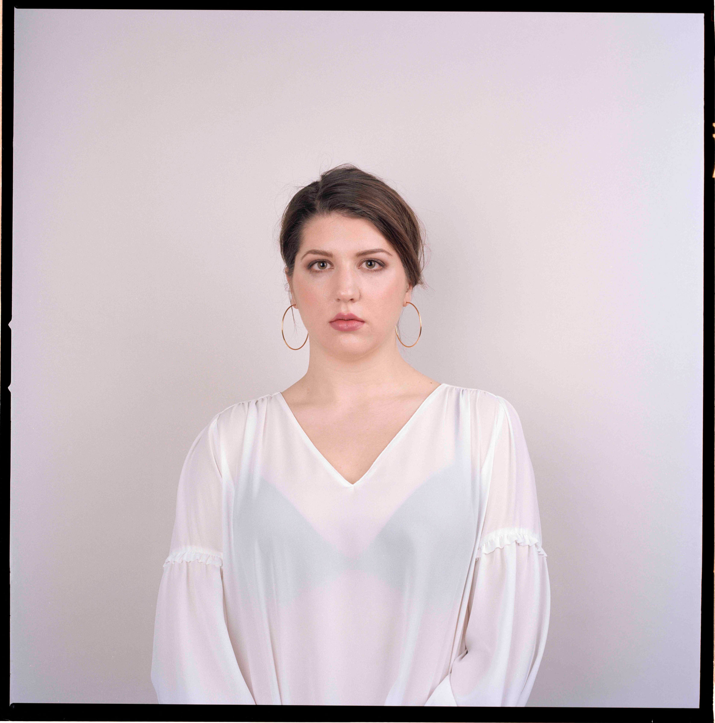

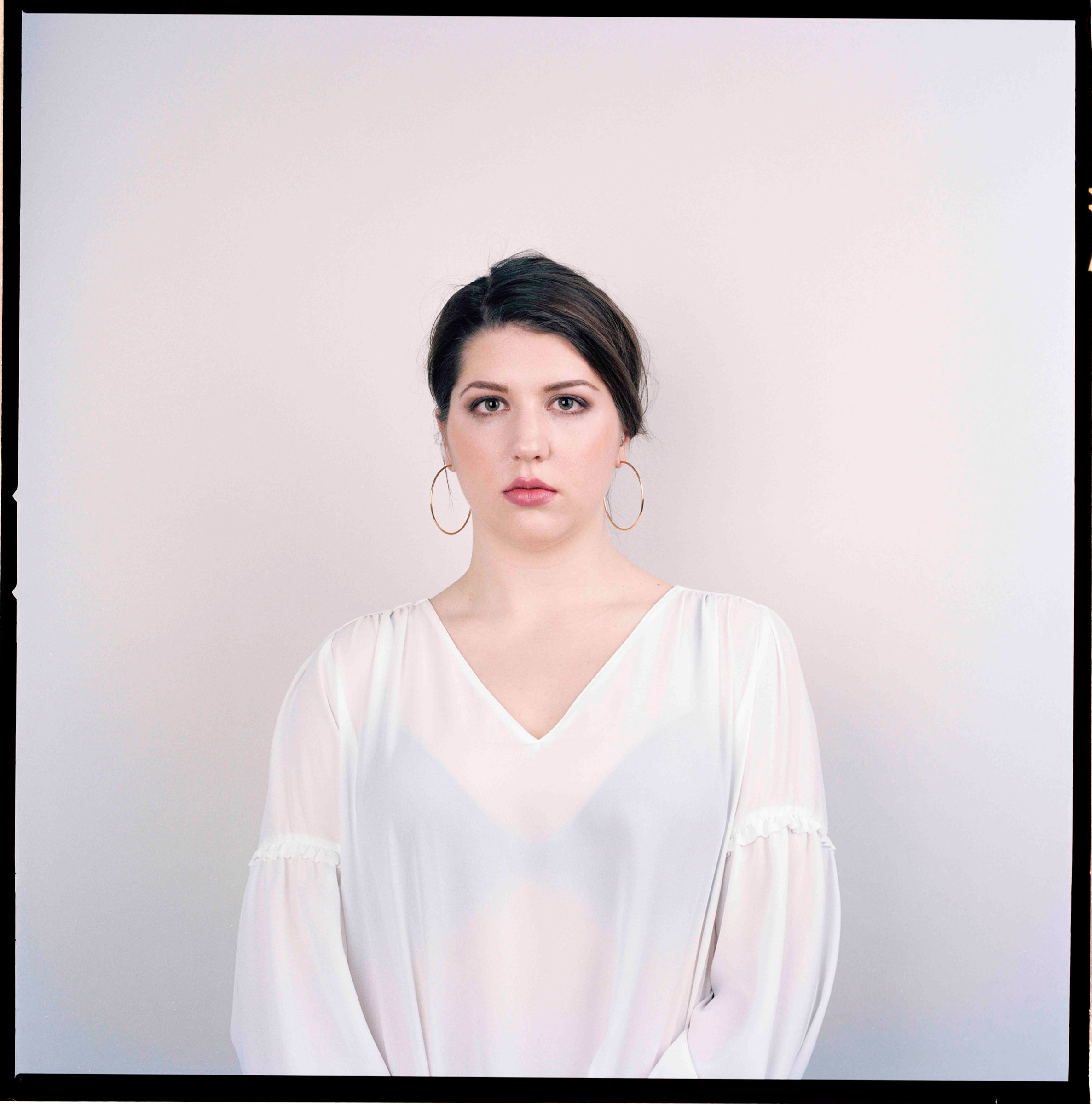

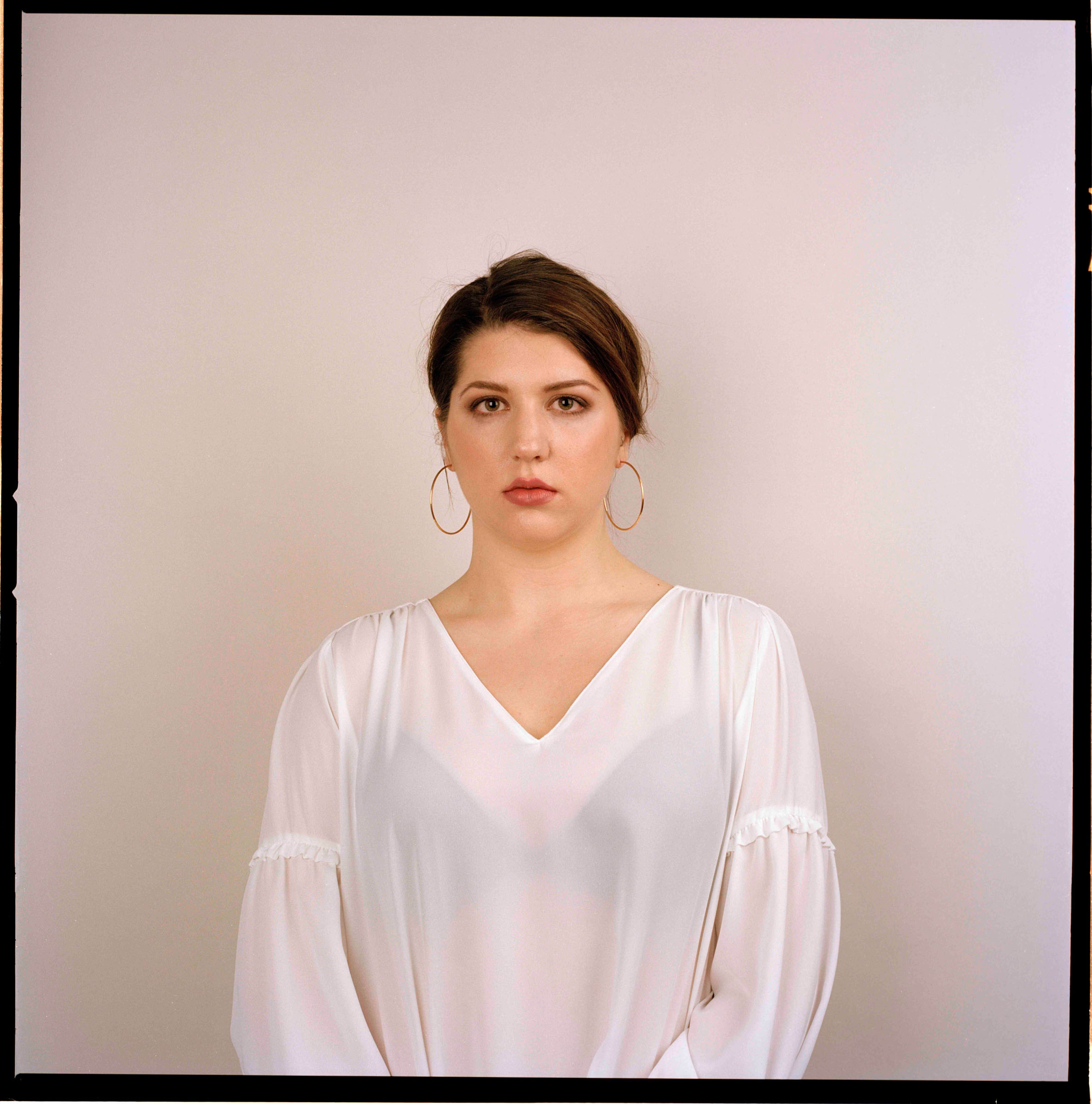

Sorry for the delayed reply. After working on this some more I realized that I am at times experiencing the same/similar problems with my hasselblad frames. So I do think that this is a development issue. Below I have included some photographs that might shed some light.
This is just an "auto" rendering using an Flexcolor with an Flextight. No settings are applied and all it is doing is finding the white and black point within the image.
The second photo I have taken the eye dropper for blacks and chosen the rebate for my black point, but otherwise it is the same.
The last photo I have taken the second image and added a slight curves adjustment to render a more pleasing image. But I find it frustrating that I cannot achieve a pleasing image without adding contrast and crushing the information.
Note that the background is grey with a very slight hint of red, whereas the finished image has large amounts of blue/cyan.

I can pretty much guarantee in that case that it's not the lighting. It's a pink backdrop with a hard flash coupled with big softbox behind for fill. The lighting style here just wouldn't have created that kind of unevenness.

The pink backdrop looks to me to be curling toward the camera at the edges - which with fairly direct flash (note the shadows) can often lead to specular reflection.
And of course a pink backdrop can make scanning "interesting".

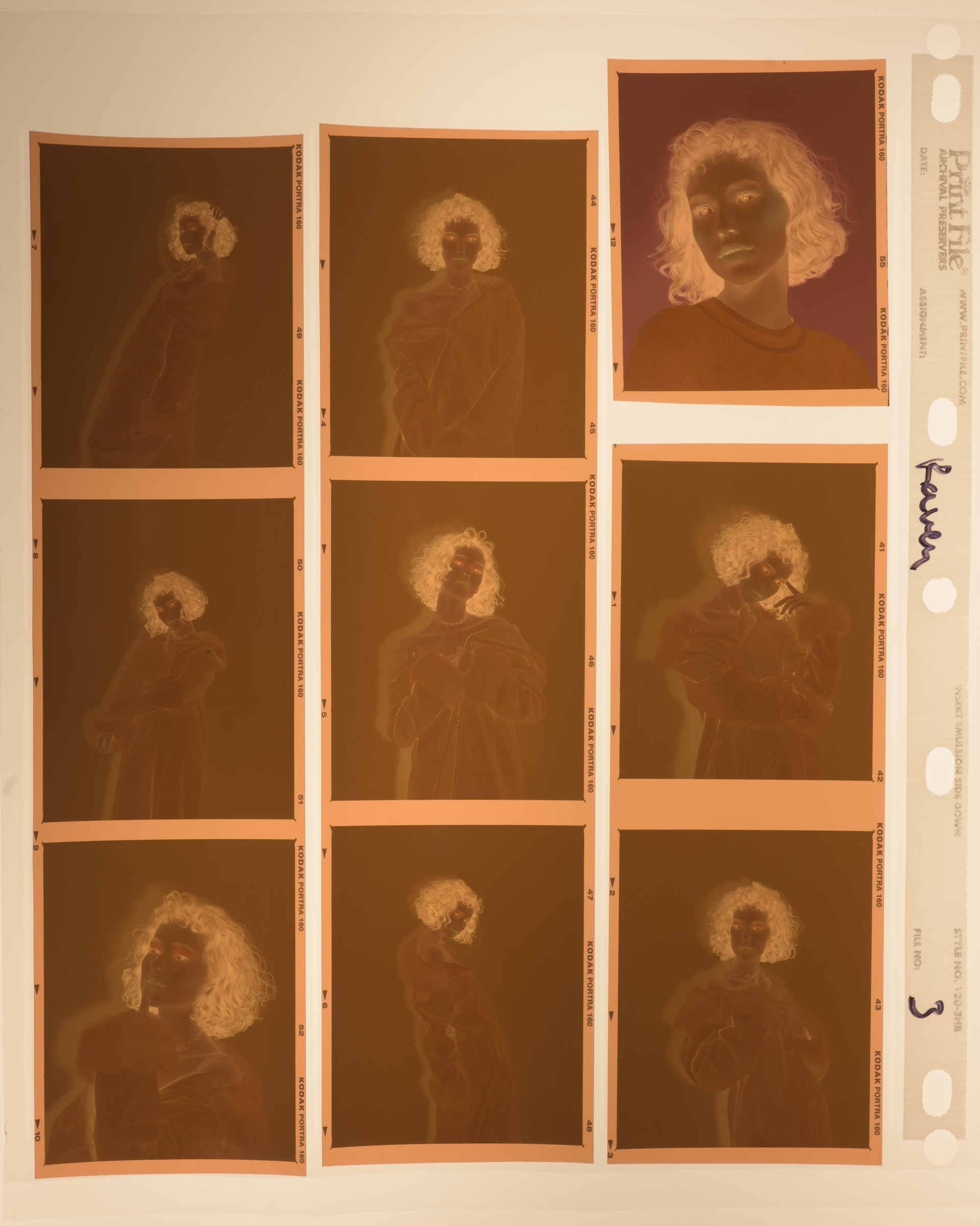

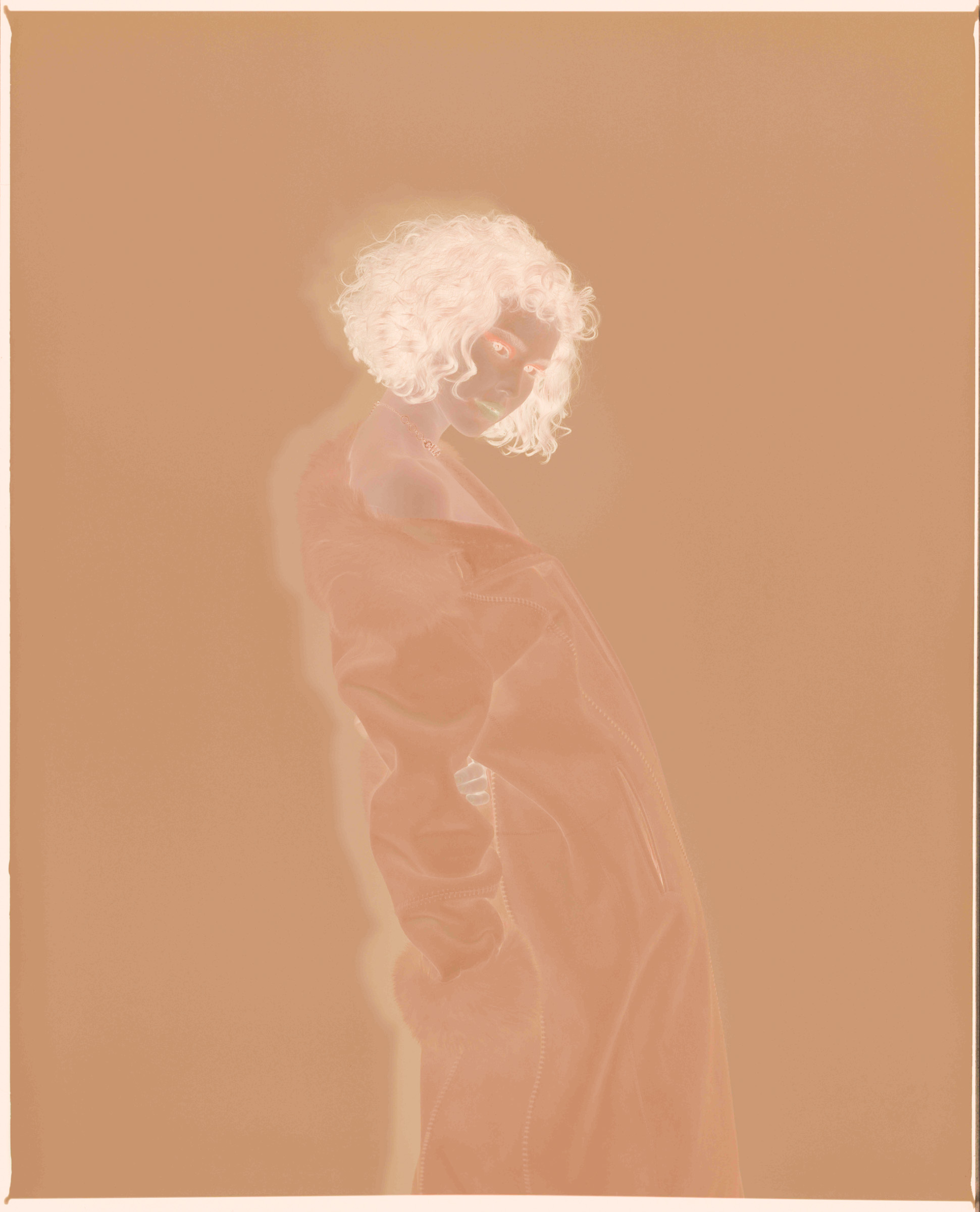

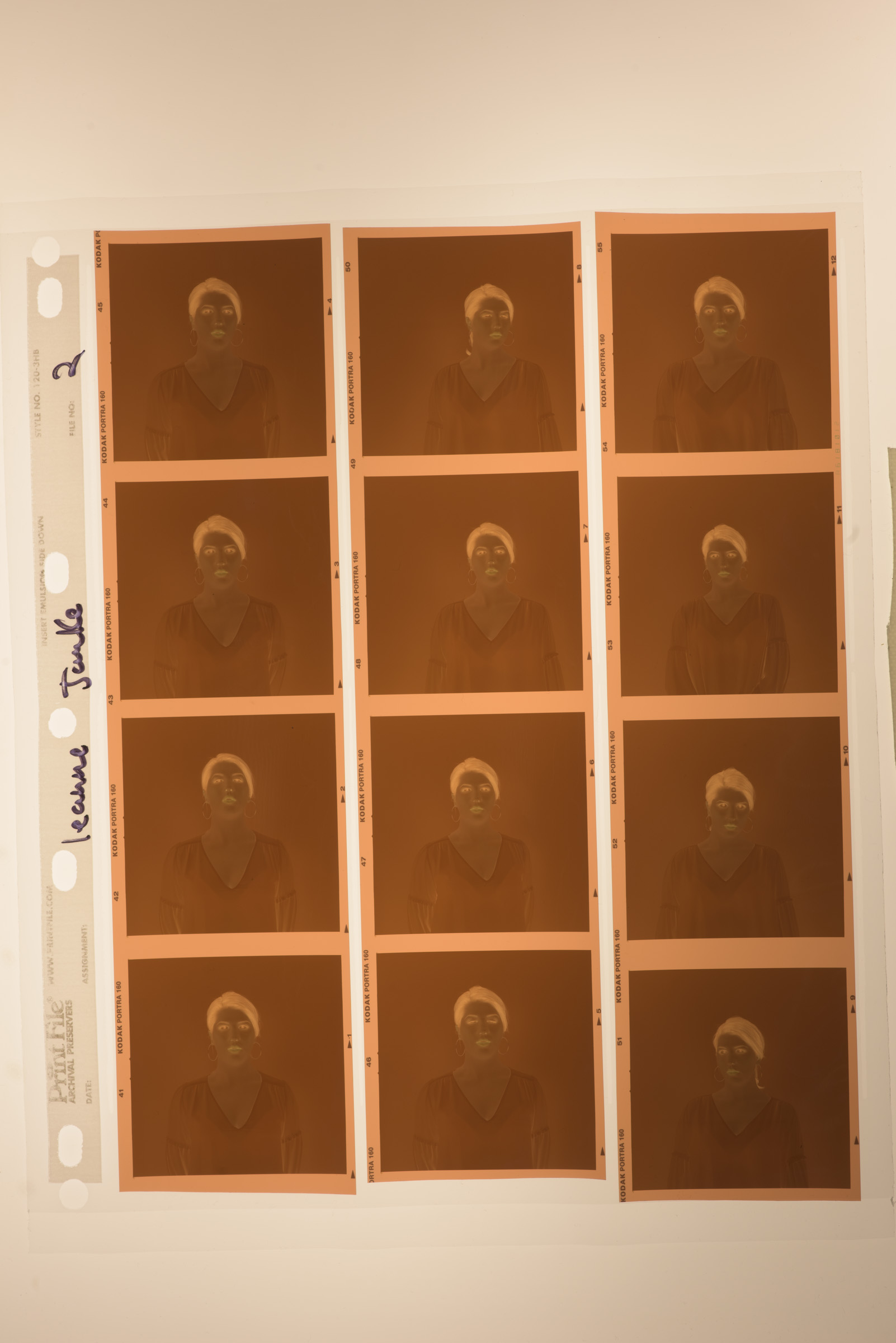

Here are the two negatives in question, both opened in PS as .fff files and then saved as jpegs. Also attached are the contact sheets which hopefully show okay. I have to photograph them on a crappy home built light table and the invert in PS to create previews, because I don't have a flatbed.

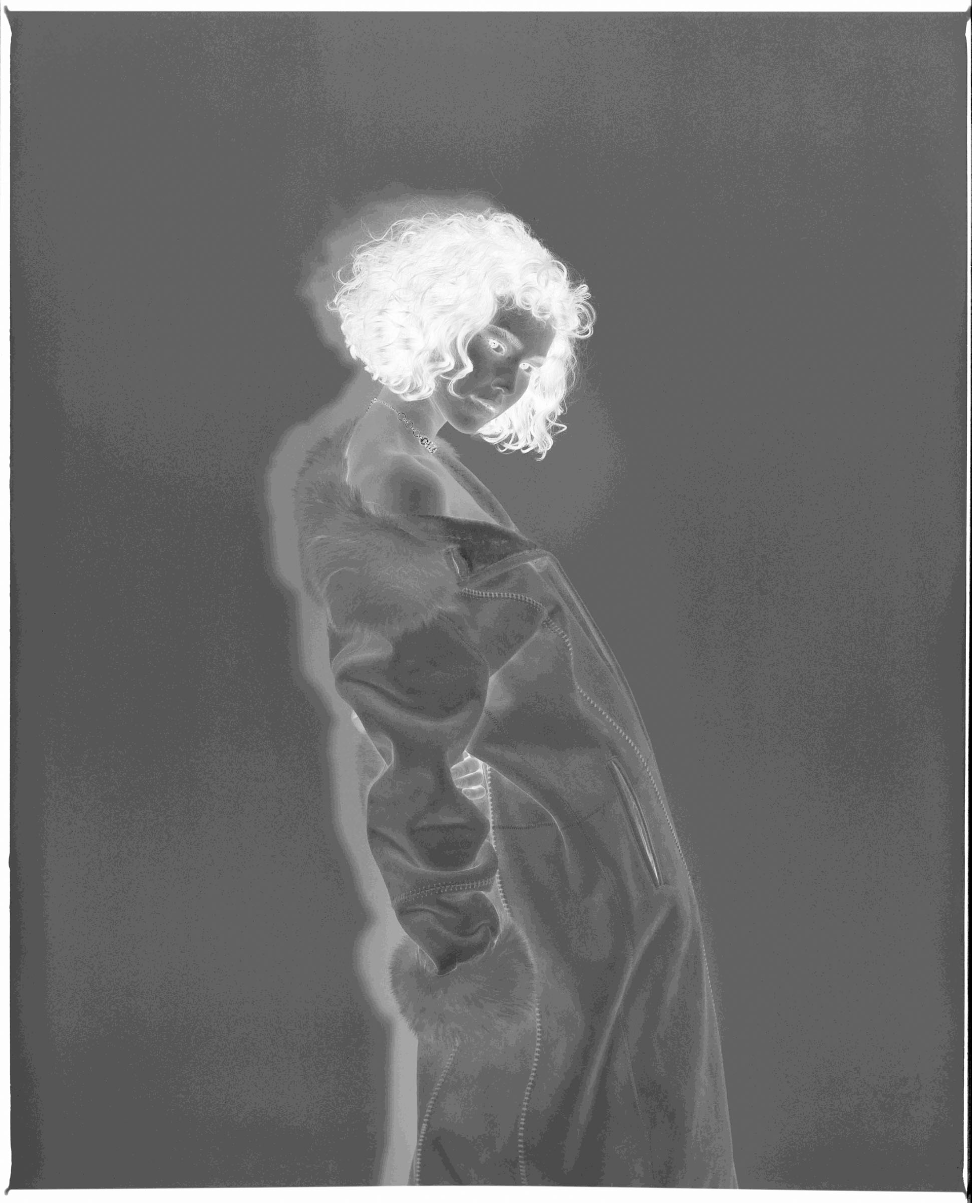

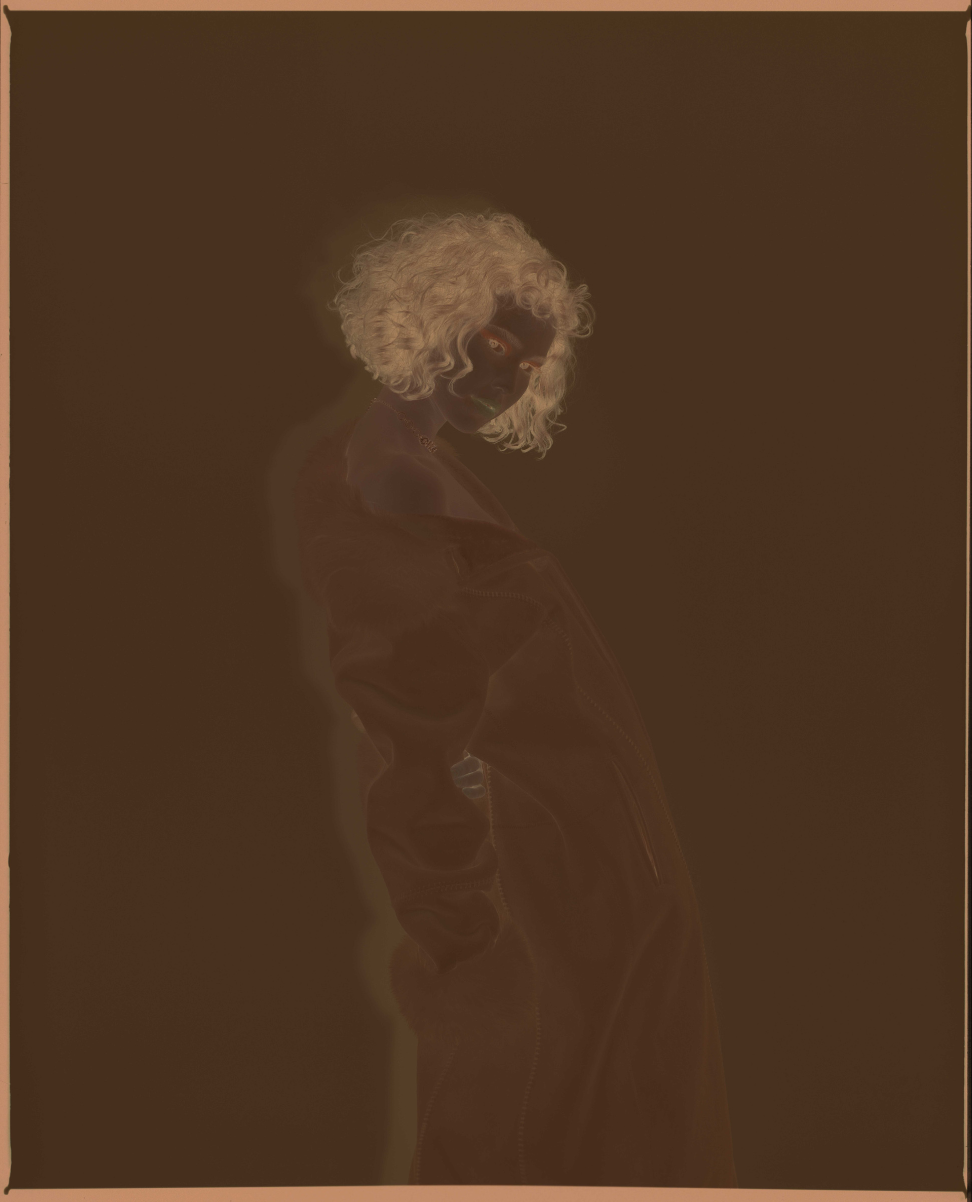

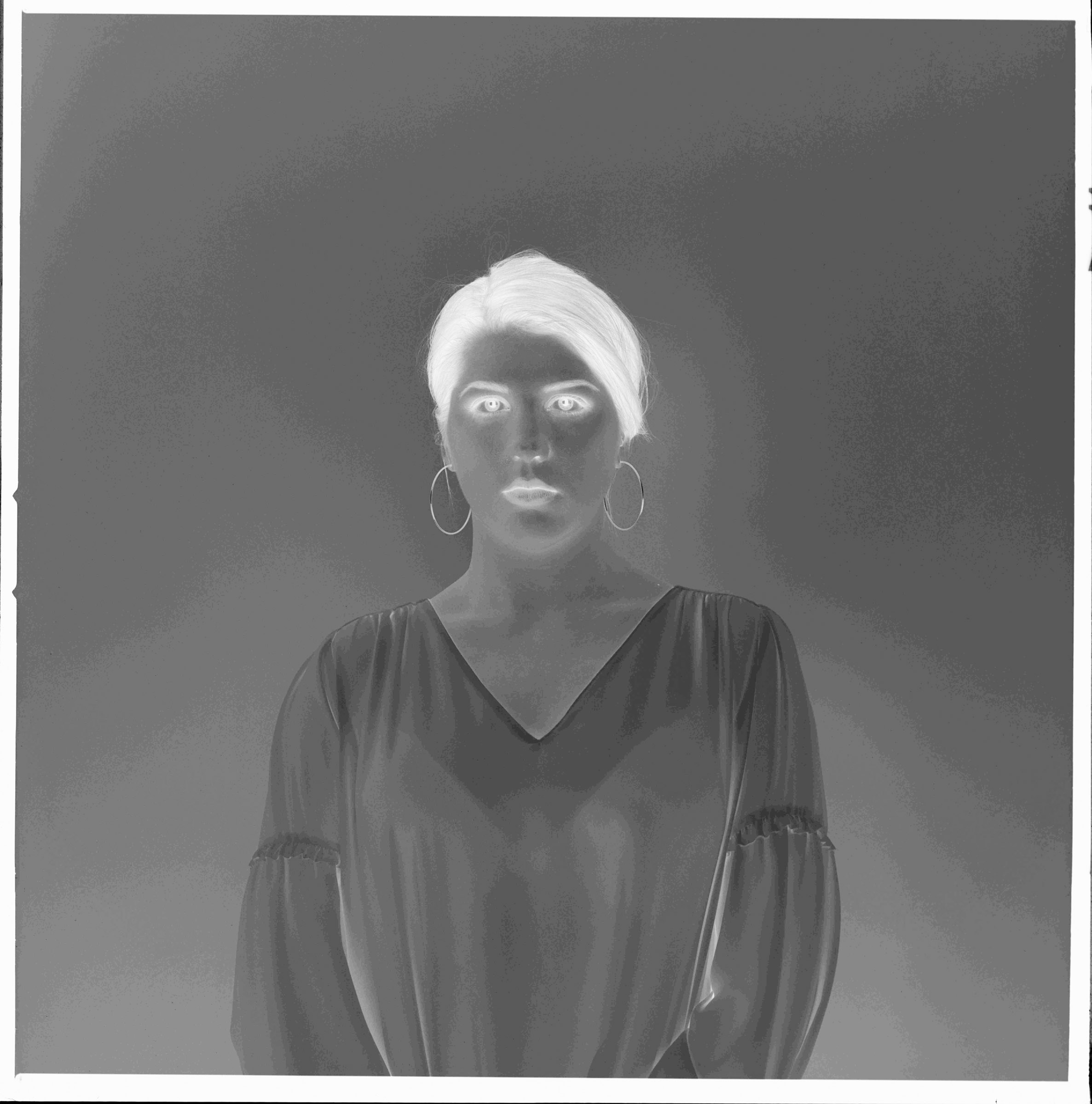

Here's the individual files with a significant exposure increase to help show the discrepancy in development around the edges.

Okay and here I've taken some fun liberties with the negatives to try see what's going on. I think it's helping me understand what's going on but I'd be interested to hear others thoughts.
My take is that the frame of Leanne is just poorly lit (oops). My fill light basically cast a secondary shadow that causes the overall frame to have odd and uneven light.
The frame of Raven to me looks like something else going on though. I see unevenness all throughout the negative which I presume suggests error in development.
Edit: Now that I think about it... the area between frames looks pretty clean on the contact sheets. So maybe uneven development is not the issue and what I'm seeing in the middle of the frame is unevenness on the paper. I'm still confused about the edges, though.

MattKing
Apr 24, 2005
52,157
Delta, BC Canada
I've looked as carefully as I can at the photos of your negatives, and I cannot find any indication of un-even development.
However, I also don't see any evidence of the light being un-even.
I think your problem is coming in at the scanning stage.
