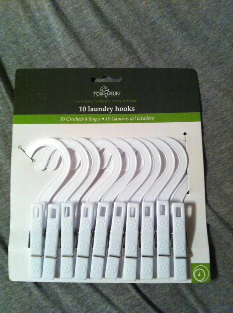

These dollar store finds work great for me:
Whoa!!!! That's great!
~Stone
Mamiya: 7 II, RZ67 Pro II / Canon: 1V, AE-1, 5DmkII / Kodak: No 1 Pocket Autographic, No 1A Pocket Autographic | Sent w/ iPhone using Tapatalk

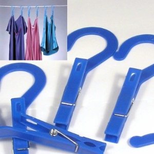

You'll never guess what I saw this weekend at the "Vermont Country Store" on my mini weekend vacation this weekend!!! For only $5!!
Doubt I would have noticed this if I hadn't seen your picture Matt, so thanks!
~Stone
You are welcome.
Be sure that they grip firmly (I had one that didn't).
They are actually heavy enough to work for the bottom as well.
You are welcome.
yea I'm not sure they are the same as yours, as they don't have a cheap feel at all and the springs are really really strong/tight, so I was very excited to find them, I think i'll still use the Paterson if I only have 1-2 strips of 120 as I really like the weight and how the film dries nicely with no worry of a drop of water sliding down from the pins... but if I have a lot I'll use these, they seem perfect for 35mm though. Thanks again.
