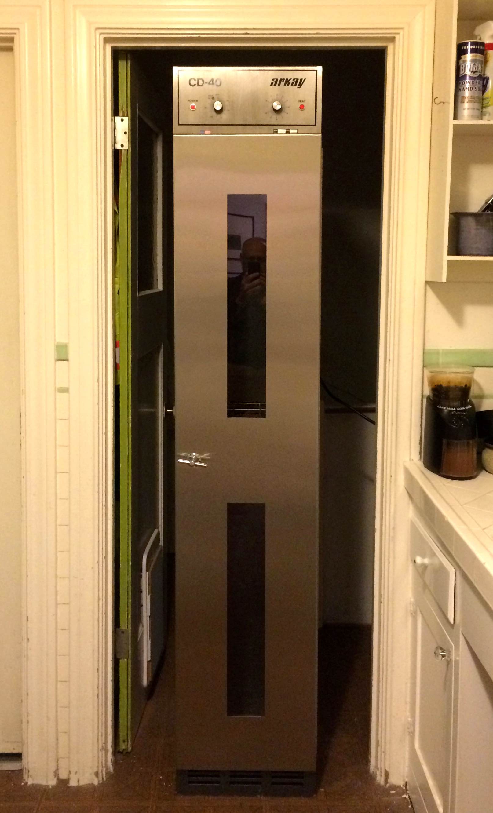

Mine dry in about twenty minutes in my Arkay CD-40 film drying cabinet used the fan and moderate heat. I have a good filter on the cabinet and never open the door whil the fan is running. My negatives are cleaner the if I hang them in the shower. Took me quite awhile to find the cabinet and I had to have a new door fabricated for it, but worthwhile for me.
Good luck in your search for a drying cabinet.
