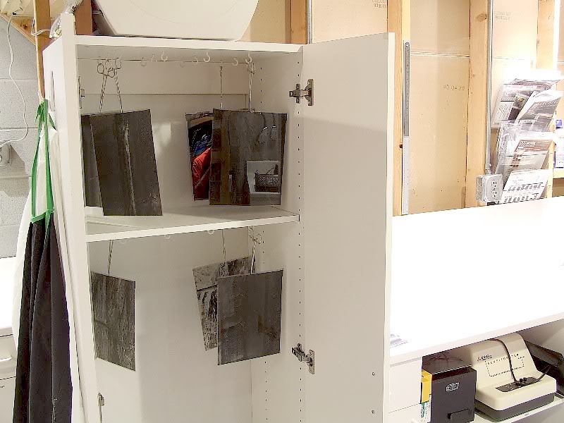

Hi - I built a simple drying cabinet out of wood and painted the interior for easier cleaning.
I weather stripped the door to minimize dust.
I mounted two low volume fans, mounted on the outside.
The low fan pushes air in, the upper draws it out. Both are filtered (I dismantled a furnace filter and reused the material.)
Near the floor I have a bare light bulb to generate a little heat.
Negatives dry in about an hour with no curl and no dust.
On mine, mentioned above, the bottom is open, to allow a slight convectional air movement. There are two cross bars, across which a towel is folded, just to catch drips. The doors have large elliptical cutout "windows" which are filled in with poly "silk" screen fabric, just enough air passage and to filter dust. No dust on anything in 30 some years with this darkroom. It helps that it's in the basement. There is a dehumidifier in the larger basement area, which takes care of the darkroom too, as long as I keep the door to the darkroom open when not in use.
