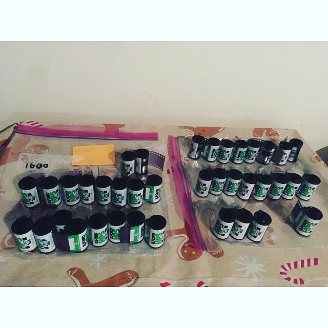

38 new rolls all from this morning. I'd been accumulating these since July. It's all HP5 shot at 800 or 1600 with a 35mm or a 28mm, developed in Microphen. Can't really remember what's on them, other than one trip I took in October. Cutting and filing took two whole hours :D

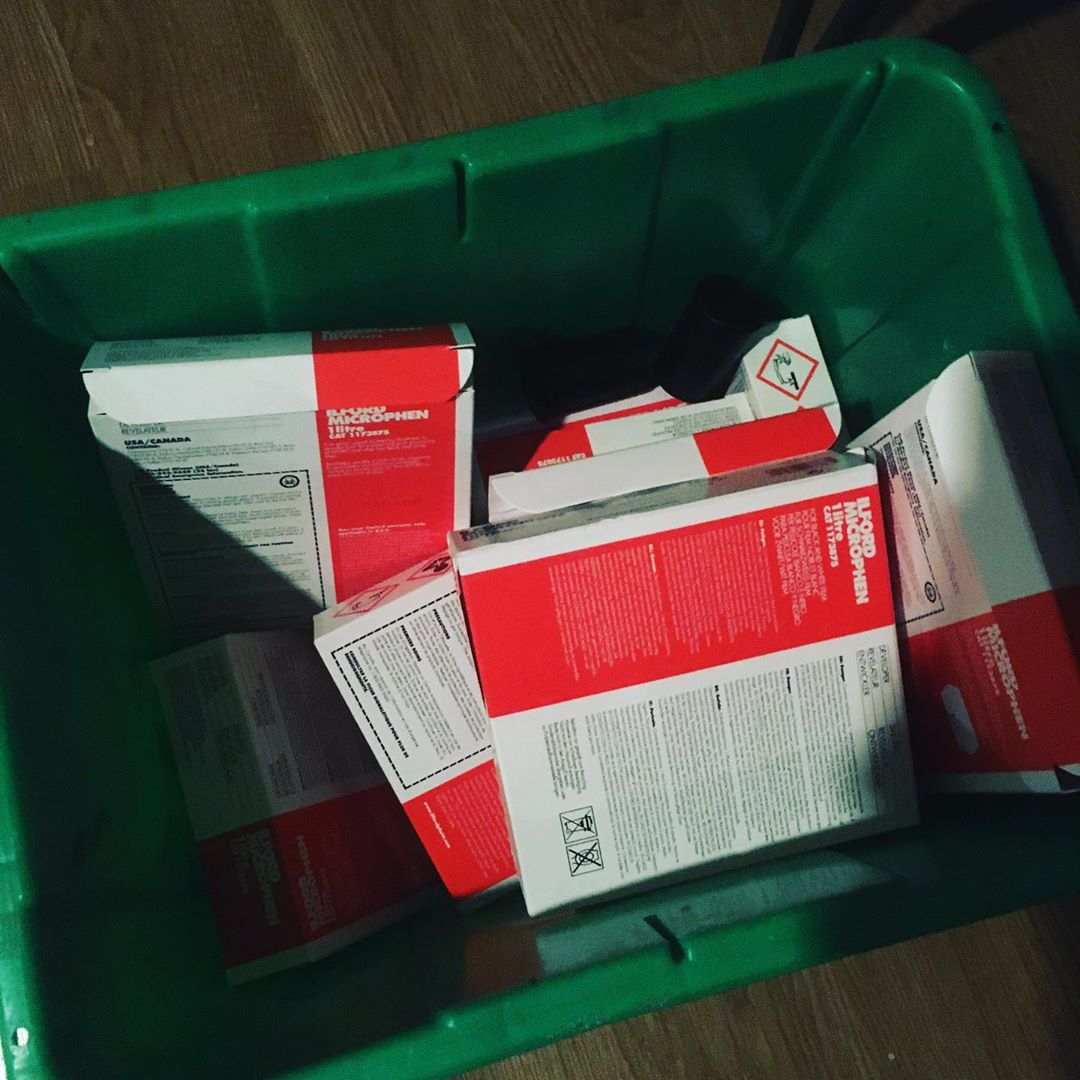

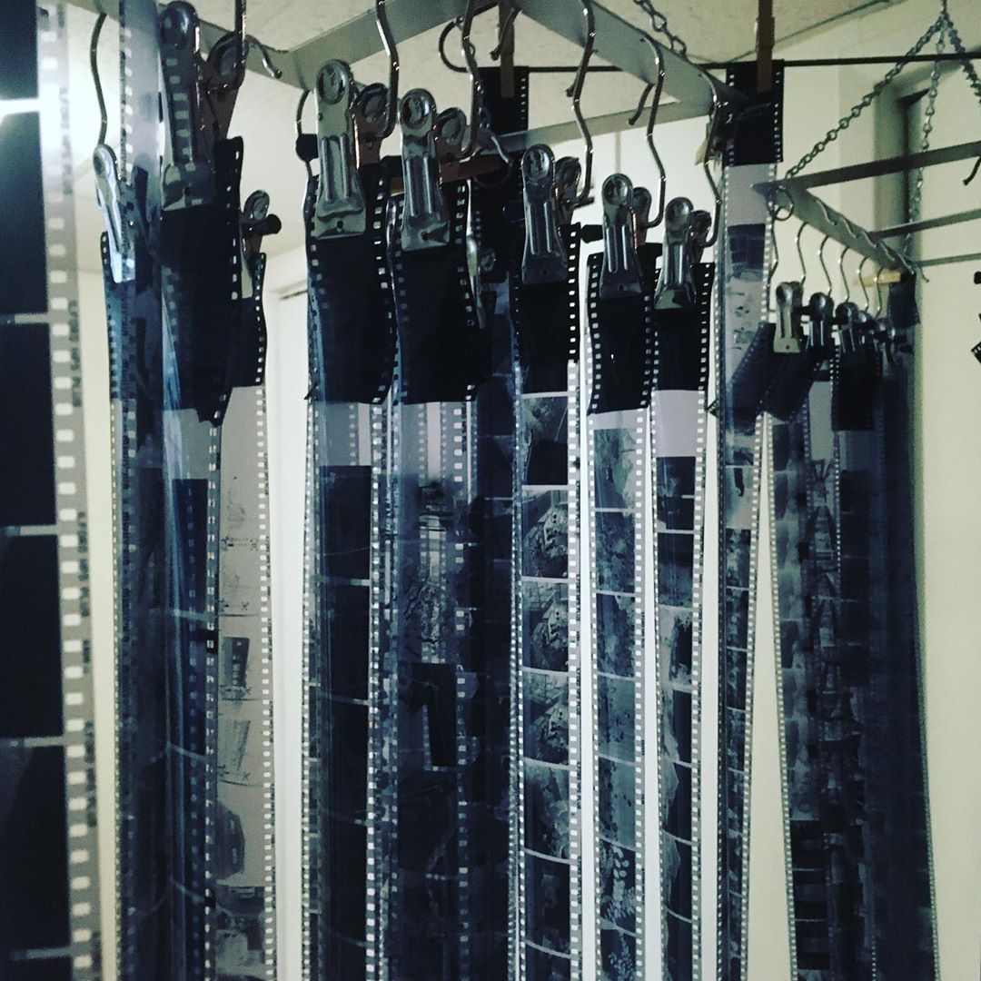

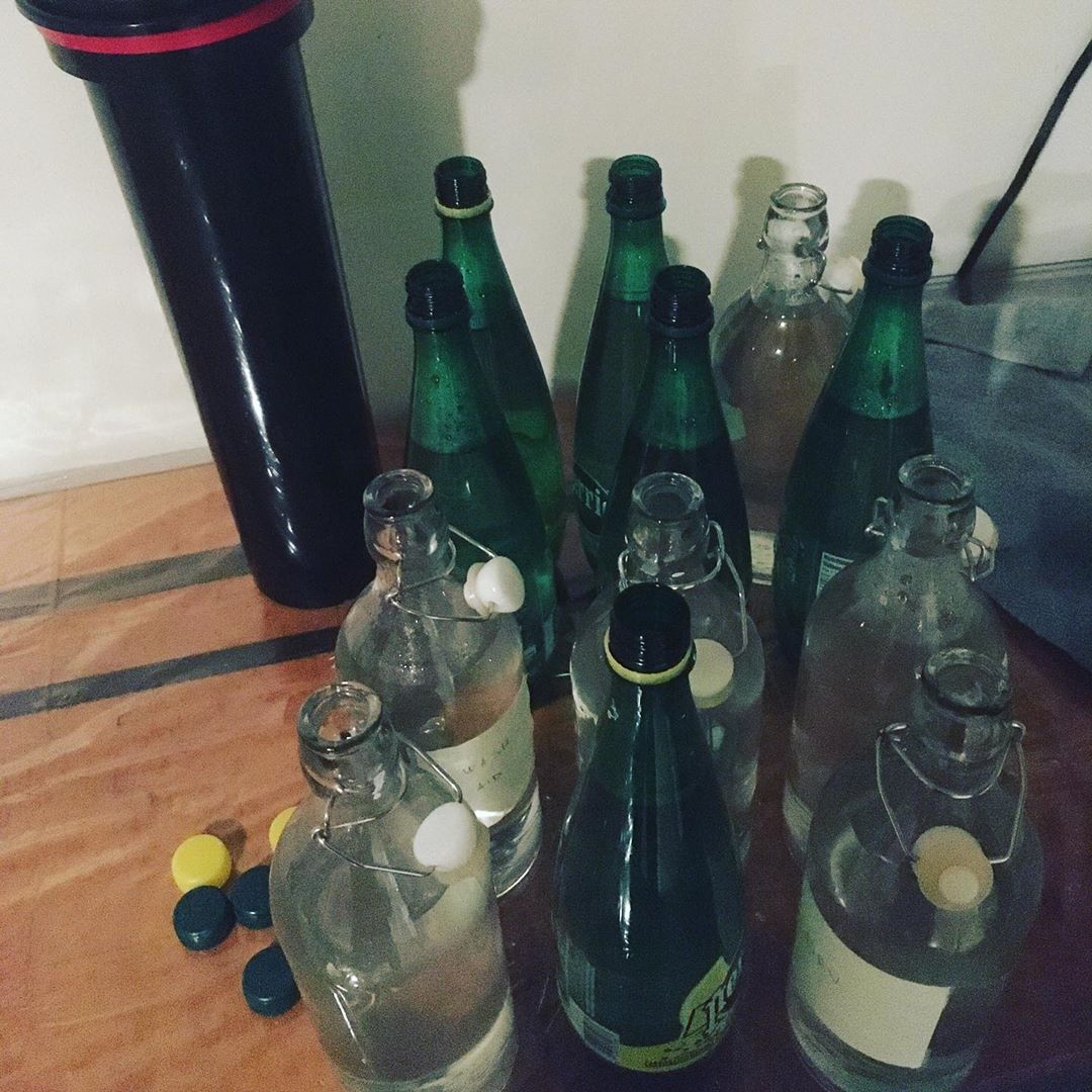

New film drying rack from the fantastic Mod54, you guys should check them out. Mixed 12L of Microphen for this, until a buddy pointed out you can reuse the developer. Anyone ever reused Microphen when pushing? :errm:

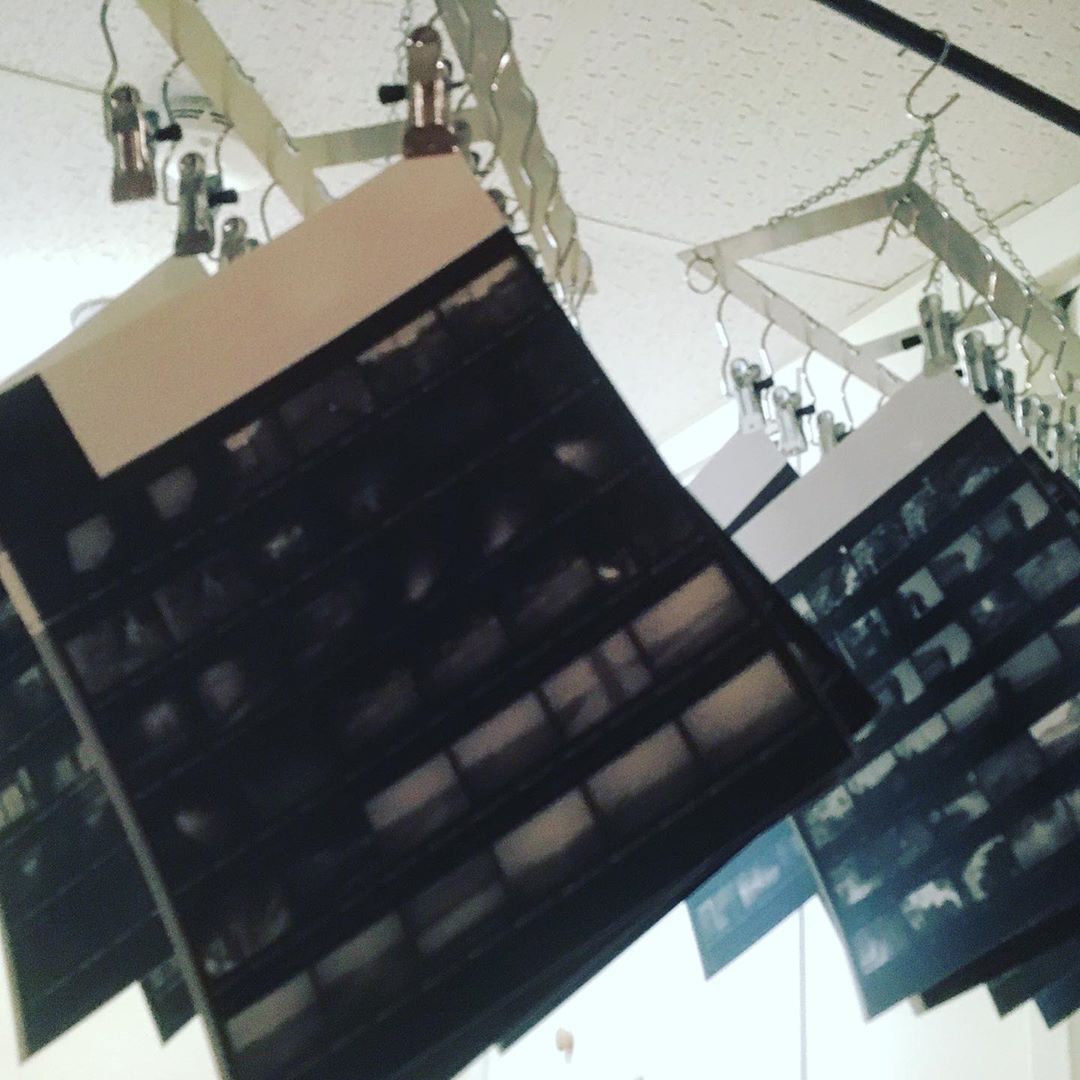

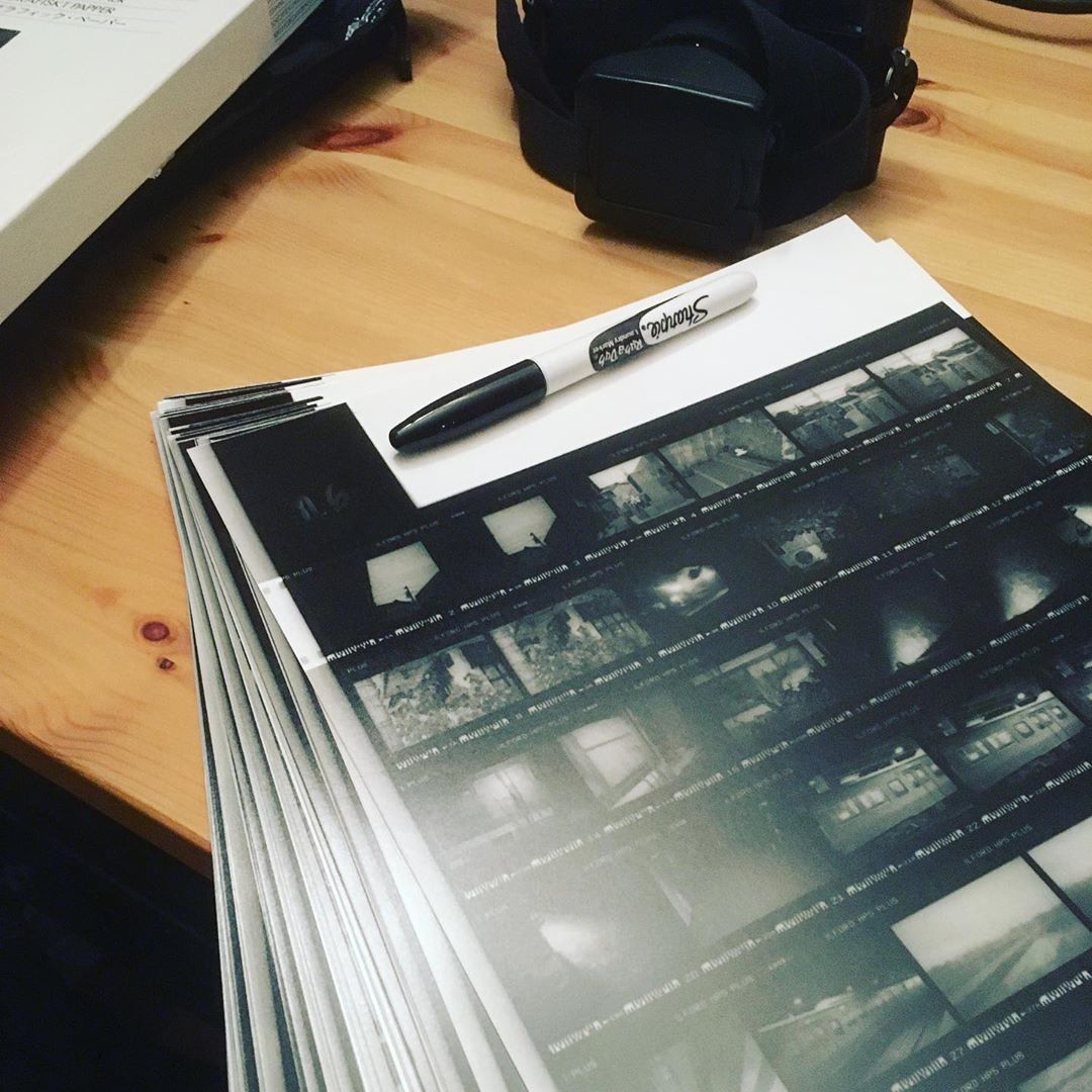

Anyway, tomorrow is contact printing :smile:
Reusing Microphen is fine, my throughput is such that I've kept 1L of Microphen for around 4 months, using it to process 15 B&W films in that time...if memory serves 5 were pushed (HP5+ shot at 1600). I tend to prefer ID-11 however.

Just curious... I see 36 images per film (not 37, 38 or even 39). Is that a deliberate decision?
Yes I only shoot 36 frames per film, it's a bit ocd of me but it makes contact printing easier as it's just 6 strips of 6 frames and they all fit on a 9.5x12" sheet

That is an insane amount of film for one day. What kind of tanks do you have?
I remember the first road trip I took way back when I was young. I think I came back with 60 something rolls of film and I only had a two reel tank. Lol. Took me a couple of weeks to develop all the film.
