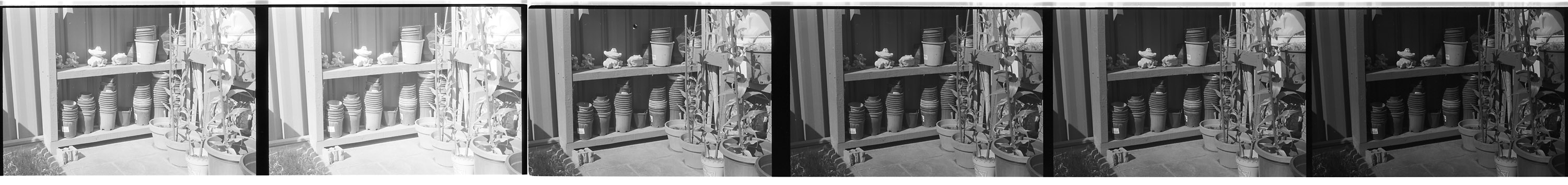

I recently did a test using FP4+ and my first batch of D-23 (teaspoon measured) and developed for 8mins using 1:1 dilution at a fraction over 20C (started lower, finished higher so quoting the average). I thought my negs looked ok but I haven't printed them yet to really decide. 5th neg from the left was the metered exposure (@ 100iso/asa/etc), so the sequence is +4, +3, +2, +1, 0, -1 scanned in one section based on the 0 exposure (I actually took them in +2, +1, 0, -1, +3, +4 sequence but have rearranged them into exposure order)

Just printed my first D-23 negs. The 120 roll of FP4+ had images exposed at EI 100 and EI 50 (using the Barnbaum mantra of then placing shadows on zone 4). Under the grain focuser the edges of the grain didn't have the sharp edges that HP5+ or TX would have when developed in D-76 1:1.
When printed the shadows on the EI 100 negs were better than I was expecting. The mid tones were fine but the big surprise were the highlights, they printed beautifully. I developed in PMK for many years and I have not had highlights like I got with D-23 since my PMK days. I'll try and scan when the prints are dry, the subject was a white horse and my daughter wearing a white top against a dark forest and all the highlights was there, nothing like what D 76 would do to the highlights so I guess Anchell is correct when he says about D-23 "without D-76's tendency to block highlights"
The negs rated at EI 50 exhibited very lively shadow detail and again, the highlights were superb. This subject was dark bluestone bridges on a flat/overcast day.
I developed in full strength D-23 for 11 minutes at 21C, 30 second inversions. I used a water stop bath and Ilford rapid fix.
If I had known about D-23 and how it handles highlights years ago I probably wouldn't have gone down the PMK path.
