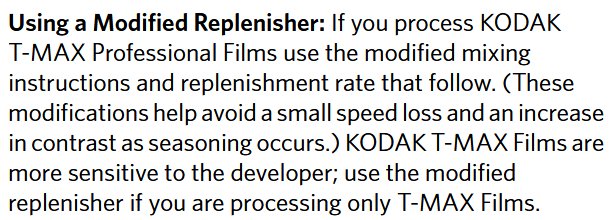

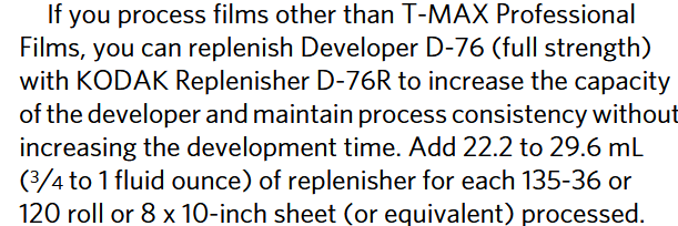

The modified replenisher is for use only with Tmax films.
From the D76 data sheet:
Note the last sentence above. And, from a bit farther down the page:
Keith Tapscott.
Jun 11, 2005
1,842
Plymouth. UK
I see now that it's only for TMax films and the regular replenisher is for other films.
22.2 to 29.6ml for the regular replenisher averages out to 25.9ml, so I would probably start with 26ml if I decided on replenishment.
