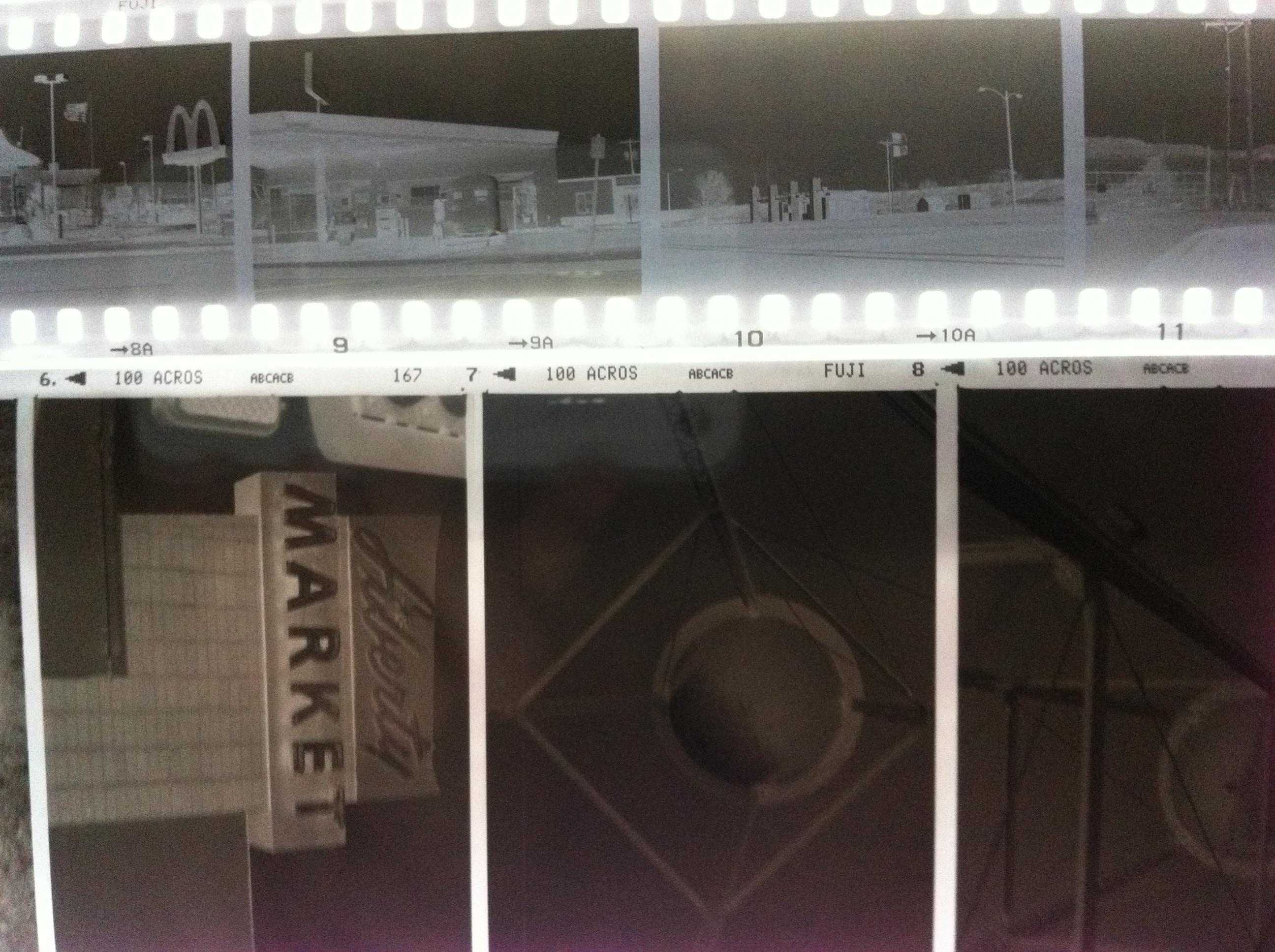

Okay got a Paterson tank and Ilford ID-11 and mixed it up per the instructions, wondering why my negatives seemed to be too flat (grey) when I processed them. Some variables to consider.
New Developer chemicals but kept at room temp for an hour before testing.
loaded film onto reels in complete dark as suggested, processed in bathroom light
followed the instructions with 1+0 rules and then reused the developer with 10% more time
first roll Neopan Acros 100 120mm @ 7 mins
second roll Neopan 400 135 @ 8:15
I used water as my stop bath and standard fixer for 1 min
approx room temp was 72
when I made contact prints, no enlarger yet, they came out really light.
Guess I need some more darkroom tips as this was my first tank developing and it shows noob all over it!
Some more data on the negs, the 35mm roll was auto exposed and the 120 was old sunny f16 +/-

Your 1 minute FIX could be one of the problems.

I use Kodak Fixers and their recommend times are around 10 minutes or so, read the instruction for your fixer.
Not sure abut the question on the emulsion thickness, they just feel normal to me.

Just made a side by side contact print from the 120 and an older lab processed 120, the lab side came out perfect but my own was way too light, It seems I over developed the negatives :sad: Should I be more careful with timing, temperature, agitation, or dilute the ID-11 further?
Yes.
But why don't you expose negs to the lights longer during the contact printing, for the ones that came out light?

Your fixing time is way too short, 5-10 minutes is the recommended time. I reuse my developer and fixer returning them back to the gallon jugs. I also replenish my developer before returning the used developer back to the jug. Freestyle sells a ID-11, D-76 developer and replenisher under the LegacyPro brand. I use a standard (acid) fixer and change this every two months. When fixing the timer is set to 10minutes, after 2minuted the film is checked to see if the film has cleared (milky white gone). If so double or triple the fixing time. I also process at 68 degrees. Have fun, Steven.

Which fixer did you use and which dilution did you do (1+9 or 1+4) and also is the unexposed film completely clear? If it isn't, the film needs more time in the fix. 1 minute seems very short for fixing, i usually do mine for 3 to 5 minutes at 1+4, depending how used the fixer is.

+1 on the fixing time. Also, the top (35mm) section of the scan looks fogged, the rebate (border-sprocket hole area) is not clear, like the lower film. Both show discoloration, which might be underfixed. Also, in the 35mm sample, you can see drag effects (sometime called surge) from excessive agitation motion, where there are dark areas "streaming" up from the holes, giving more agitation than in other areas. We have all had this at one time or another, it doesn't mean too much agitation, just to much movement when agitating.

If you only fixed the first roll for 1 minute, I recommend you refix for at least 5 minutes or more then rewash. I use TF-4 and fix for 6 minutes, which is slightly longer than specs, but safe. You really need to read the directions supplied with the product you purchased for good results.

You definitely should be fixing longer as many have mentioned. Remember too though that Acros is typically low contrast and aside from Acros you should generally be targeting negatives for moderate contrast and not necessarily deep black looking negatives.

as mentioned by Rick (post #15) you can refix a second time. I've done that more than once when it turned out my fixer was worn out and the film was streaked or stained because not enough fixed. But I don't know if there's a time limit beyond which you no longer can refix.

It is not how the negs look that counts. It is how easy it is to produce good prints from those negs. Negs that look better as negs are often overdeveloped which can make good prints more difficult to do.
Good negs often look flat and grey. Judge the negs from the end product which is the print.
You certainly need to fix for much longer if you want the negs to last as others have said.
Compared to what?
A 'normal' negative will have about six or seven-tenths the contrast of a print or transparency.
The negatives posted look Ok. I'd print them and see.

As a guess, I would suggest your development time is about 4 minutes short and you should fix for about 6 minutes.
