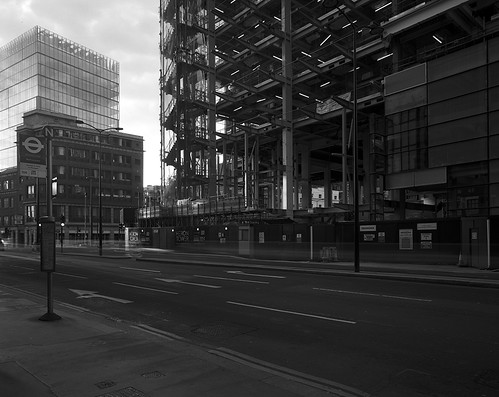

(click for Flickr page)
That's the FP4+ at 1:100. Perhaps slightly too little contrast in the midtones for me, so perhaps some split grading to get that right. A yellow filter would probably have helped as well.
Lots of detail, fine grain, though still noticeable compared to the mushier grain of the Tri-X.
Overall: Happy! I think I'll standardise at this for a while until I feel an urge to explore elsewhere.

Since you're comparing FP4+ against Tri-X in sheet films, you're comparing FP4+ against Tri-X 320. It's no surprise that you're finding result that you like better with FP4+. Tri-X 320 is a film that has a very long toe, and is really designed for and best used under lighting conditions that allow for complete control over light values. It does not start separating out shadow details until it is pretty far along the contrast curve. Now, does this mean that Tri-X 320 cannot be used under uncontrolled daylight condition? No. I and many others have used it that way, but one must give special considerations for the film's properties. Extra exposure will open up the shadows considerably, but then one must consider cutting back on development to keep the highlights from becoming too dense. A more valid comparison would be to test FP4+ against Delta 100 or TMax 100. If you really want to see something special, try it against TMax 400. You'll get plenty of shadow detail with good contrast, and two stops more speed, at its ISO speed without the need to worry about blown highlights. You can do this with nothing more exotic than D-76, and by following the manufacturer's recommendations to the letter. I can practically guarantee that if your meter, shutter, and development techniques are reasonably withing spec., you'll have negatives that are easy to print. Lighting conditions that would present difficulties with other films are easily handled by this film.
A light yellow filter would only deepen the shadows more in the example you've posted. Yellow filters remove blue light, and shadowed areas are relatively richer in blue light than are areas lit directly by daylight. Remove some of the blue light and you force the lower values even lower down the scale, and the lower to lower middle tones further into the mud.
