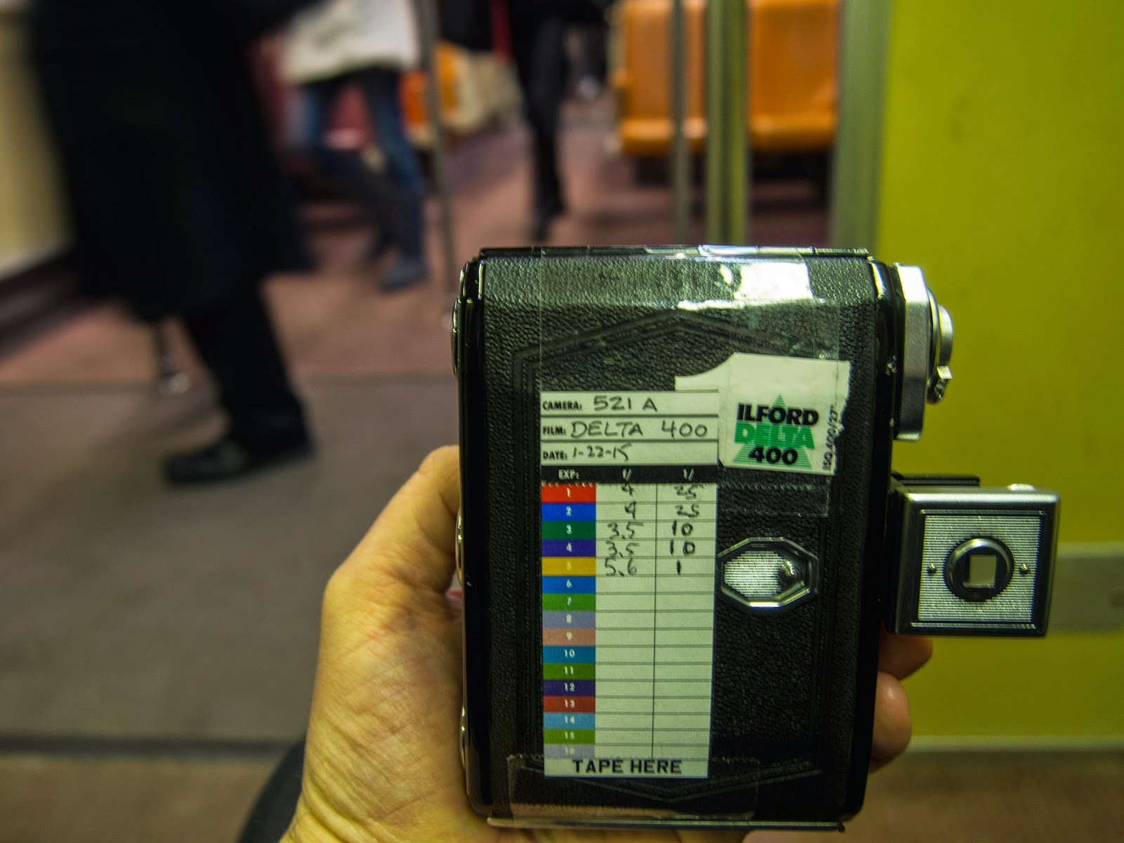

find an dead SLR, pull one off that back, glue to camera or even better glue to self adhesive vinyl then stick this on the back. This is what i have done on my autocord, works for me.
regards
CW
A 120 film box end is only about half the size of a 135 one.
