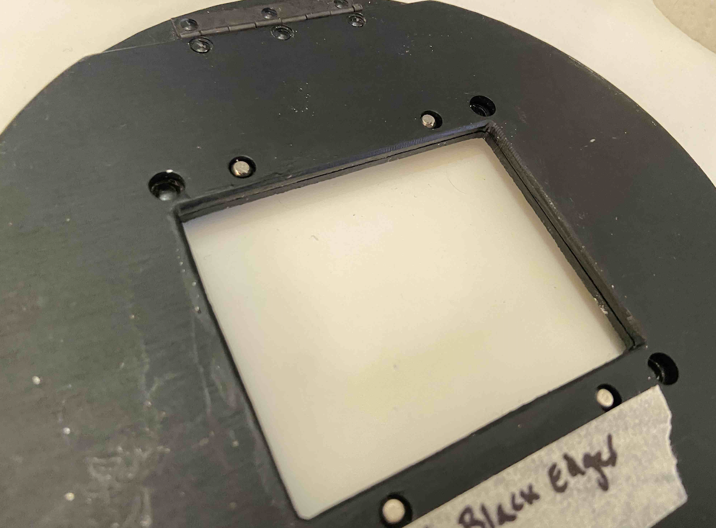

I'm filing out a spare negative carrier in order to slightly expand my edges and create a rougher border (intended effect similar to this )
I'm having an issue with this beseler 6x7 carrier where I am seeing this "double edge", occurring both on the projected negative+final print:

I tried filing down the bottom layer so it is slightly bigger than the top layer (the top layer just overhangs on the edges), and for whatever reason it seems to have pushed the "double edge" effect further away:
Has anyone experienced this or might have any advice for achieving a smoother file / removing this edge?

Painting the exposed edges black solved my "double edge" reflection issue, though now I'm getting these strange light brown markings around the opening.
Wondering if anyone has any advice on how to further clean up / align the rough edges - in an initial ref I had posted, some of the edges are appearing more teal, not brown - wondering what would make them reflect that way? And what would be the best chance for appearing as solid black ?
I'm aiming for a more "uniform" rough edge look - i.e. more solid edges, not wispy edges, but having trouble achieving

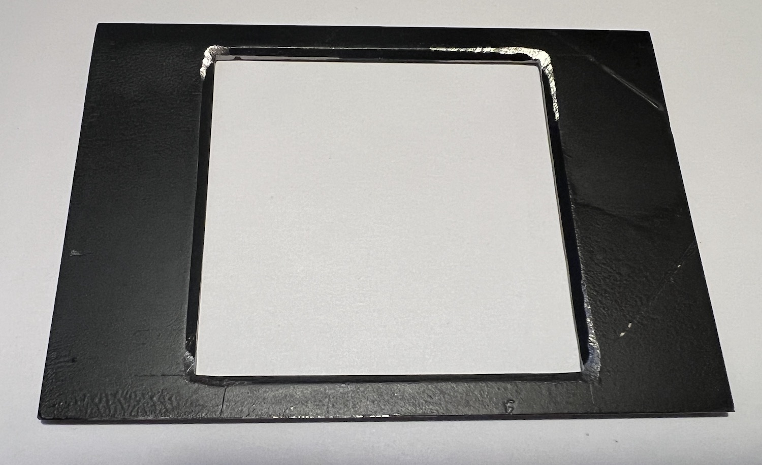

I did go ahead and bevel the edge, though the print is coming out exactly the same, with the brown dirty edge. maybe I'm beveling in the wrong direction / not large enough of an area ?

You need to bevel it much more and wider. You barely took edge off.
In my case I use top Anti Newton glass and glassless bottom, so I leave maybe 0.5mm straight right under the negative and bevel much more than you did and than I should paint it with black. It's never ending process. It can work nicely with Hasselblad negatives but for Rollei TLR negs you need bigger opening. Check with your negatives.
In your case, with both glassless holders I would file it both sides and make it bevel profile look like "hourglass".
