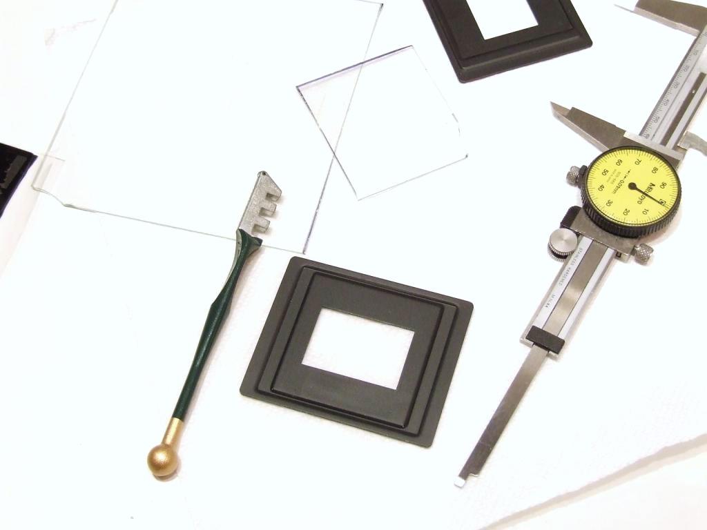

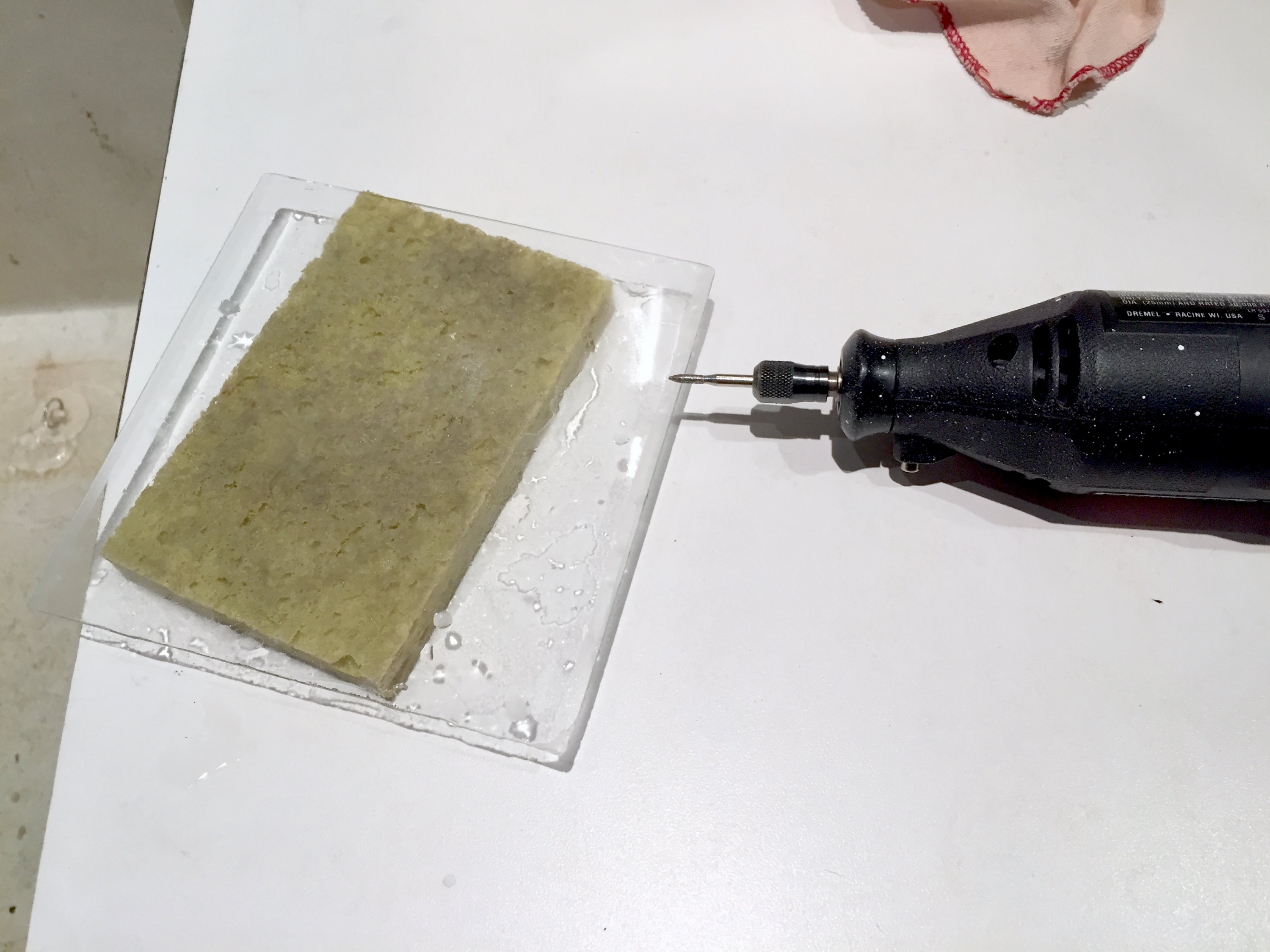

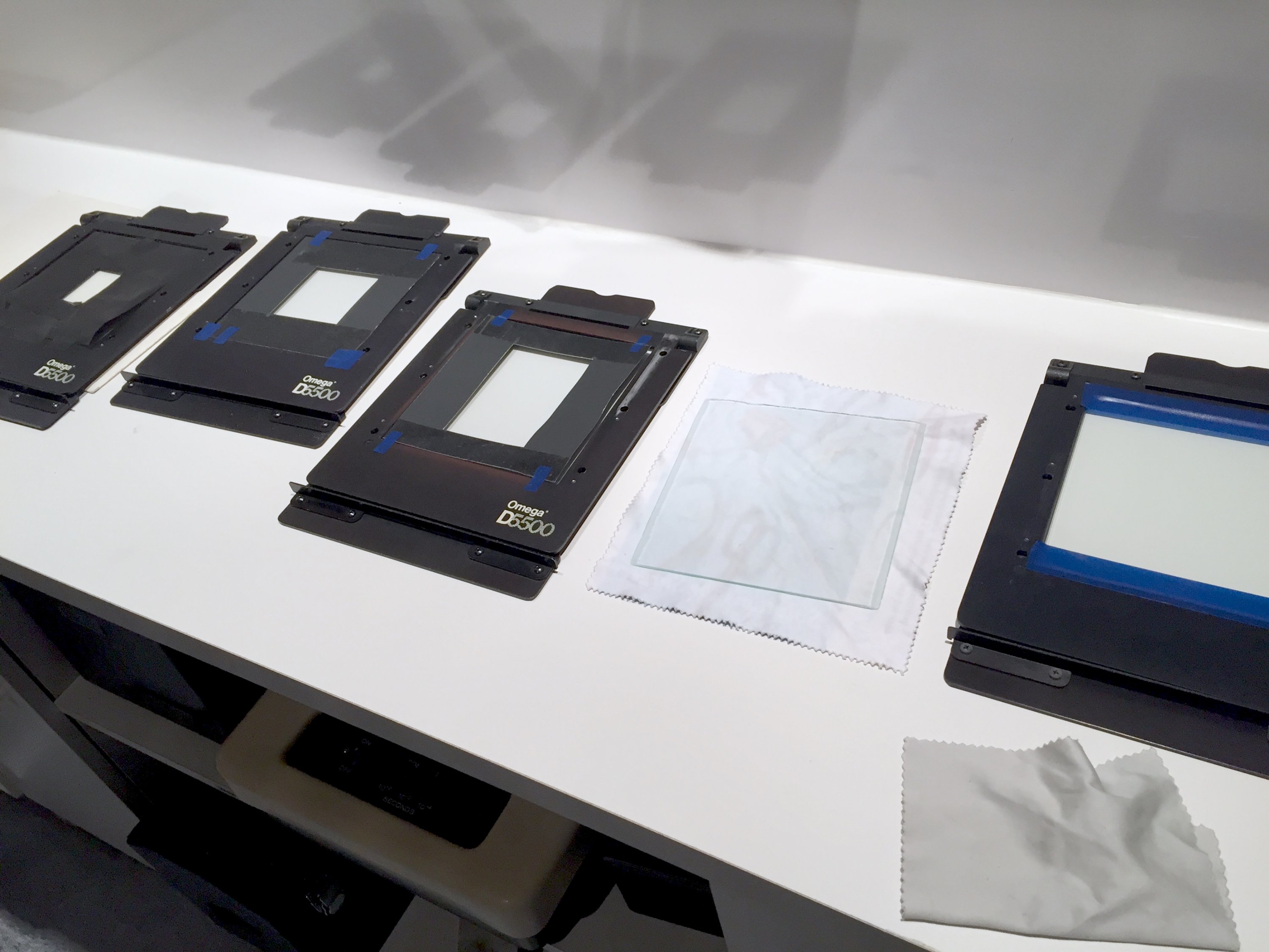

After I discovered the benefits of glass carriers, I stopped filing and started cutting and beveling glass....

Nice! How do you avoid Newton’s rings?
Good question. I was gifted some original Durst 5x7 Anti Newton glass (the best; per Drew..) and cut it down to for my smaller negative carriers that originally had smooth glass on both sides. That is what is going on in the pictures.
