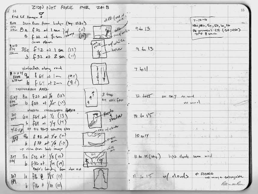

Rite-in-the-Rain notebooks.
I believe the image (a pt/pd print) is from holder 5x7 8b on the sample notebook page.
I have been filling these books up for so long that I really do not need a pre-printed form. My notebooks have become a diary of my (mis)adventures since I began using them in 1980.

Sometimes I wonder if I know what I am doing!
On the image...5x7, 210mm lens, FP4+ film...metered with a spot meter (Pentax Digital Spot) and that gave me a range of reading of 12 to 15. Because I was so far away, even with the 1 degree spot of the meter, I could not read just the darkest area of the scene. From previous readings that day and checking on light values nearby, I figured the deepest shadows would be around 10, maybe a little higher. So my actual range of light values in the scene ran from 10 to 15. I exposed two negs, one at 12 (f22@1/8 sec) and the other at 13 (f22 at 1/15 sec). Even though the scene had an 'average' range of light values, I gave the film a lot of development for the contrast I wanted for platinum/palladium printing.
If I had used a filter, I would have made note of it. The most important info for me is the SBR -- scene brightness range (that 10 to 15 above) and where I exposed within that range. That will give me all the info I need to determine processing (which developer, dilution, time, temp, and aggitation) for the print I want to make in whatever process I will be using.
I transfer the info onto the paper envelopes the negatives are stored in. Also included on the envelope is the development info, and the negative's printing history. In theory...if I remember to do it.
