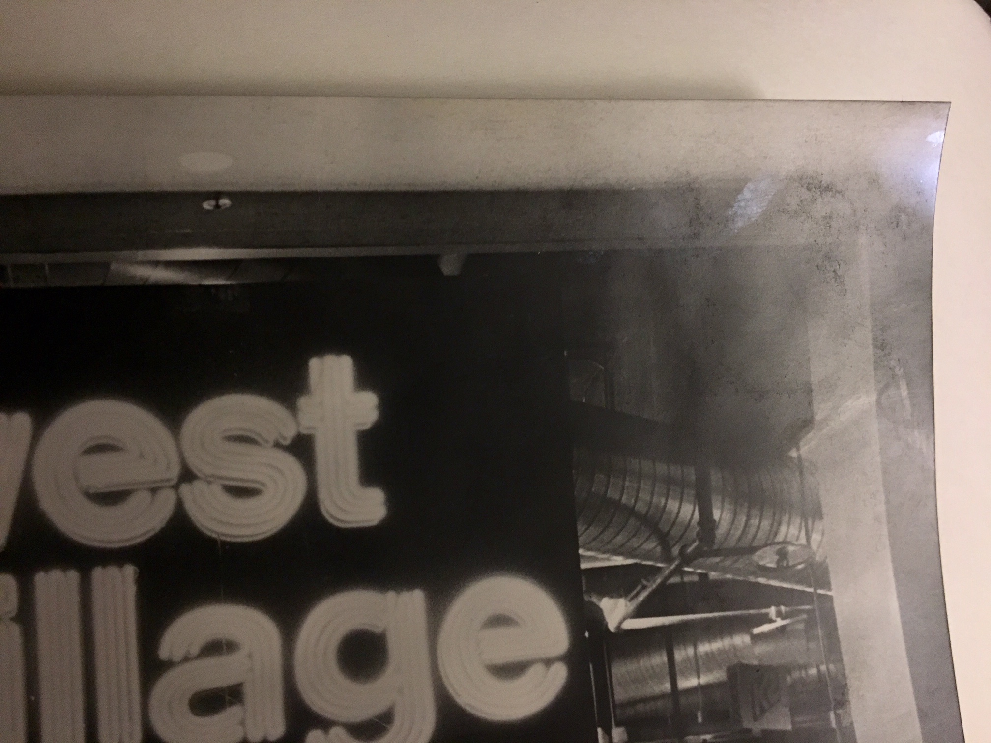

I started darkroom traditional printing around 1972. The oldest RC print I have is one I made on Kodak Polycontrast Rapid RC N 8x10. I share this as an artifact of RC paper longevity from 1972.
Thumbnail below.
This print has had less than ideal storage and handling in 45 years, and my processes wasn't close to archival, really I bet many things like weak fixer, lack of good wash were present in making this.
Yet this print is still presentable, I would say 90% fine, but the print isn't very good of the negative (man have I learned alot in 45 years).
Some of the de-silvering mentioned is happening near the edges, upper right hand corner of the photo, mostly where it has been handled many times.
Thumbnail below.
