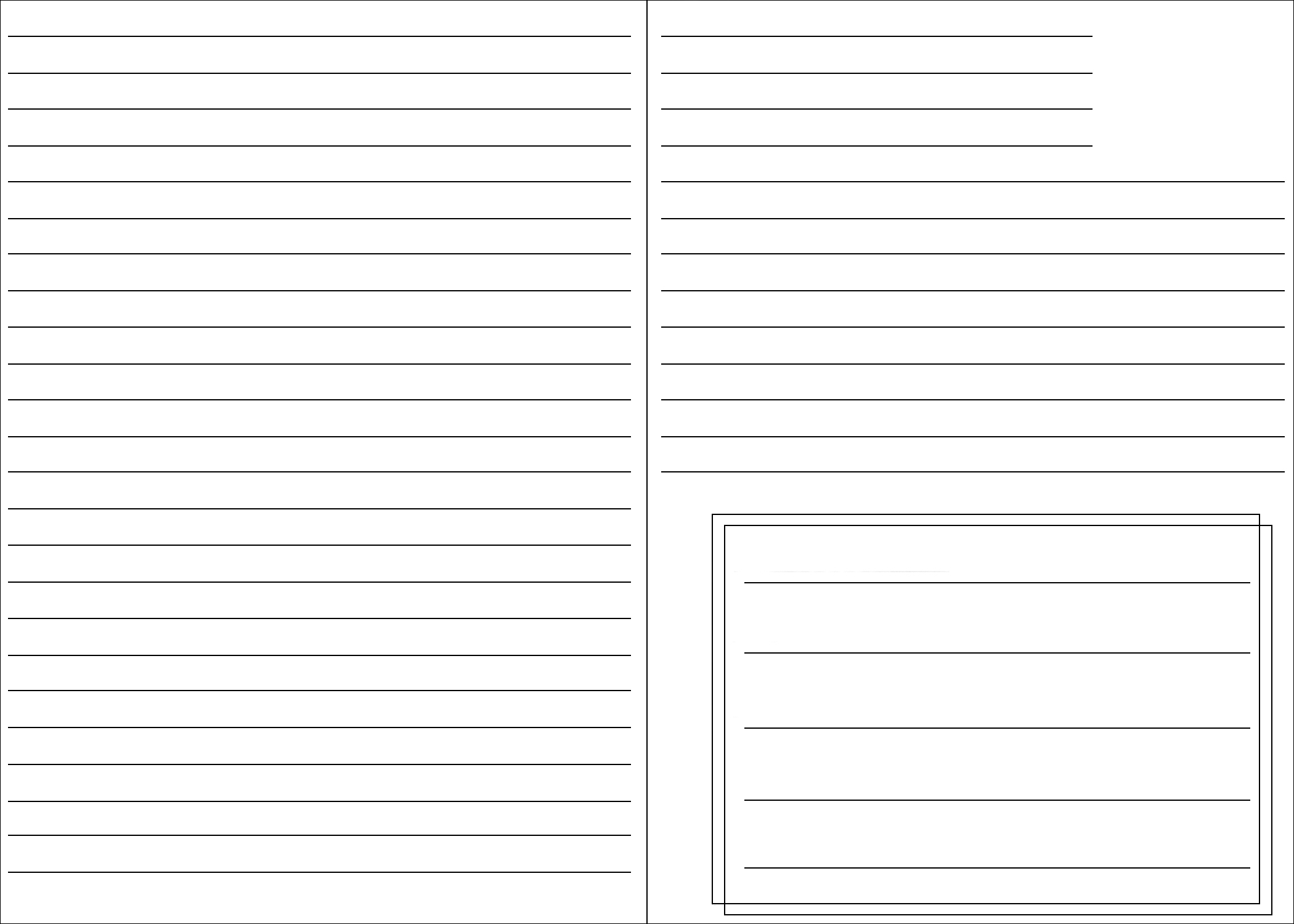

If you want to thicken up your paper slightly and also give yourself an easy surface on which to write, feel free to print out my DIY postcard back. It's sized to be glued to a piece of 5x7 paper, but you can resize it to whatever size you need. Have fun!
File attached:
