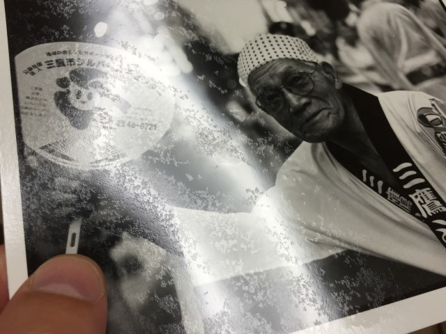

I've been down this road and gave up. Have gotten myself a nice old print dryer that dries on both sides up to 11x14 each and have one ferrotype plate for it.
I have cleaned it immaculately and my results were always the same. The prints look amazing from afar but when observed from a close distance - there are all these holes in it.
I never went down the route of trying to wax it etc though....
See two sample photos I made during the process.

More than likely those "holes" are from steam forming pushing the print away from the dryer surface.
I have seen ferrotyped prints turn out well with the old hand fed rotating drum dryers, but not with the canvas clamshell type dryers (I have one). I have never had a good ferrotyped print from the clamshell dryers, though they are great for flattening prints. I would have to conclude that if I can't get a good ferrotyped print out of a clamshell heated dryer, you may not be able to as well. But all is not lost...
If you really want a ferrotyped image the best thing I have found is plexiglass (better than chromed plates even), well cleaned with a tiny amount of wax applied (I use Butcher's Wax). Not too much, not too little. Put a cloth or something over the print to prevent it from drying unevenly (i.e. from the edges) which can make lines on the print when the dry part lifts. If you are using a chrome plate or heated dryer and you hear a "pop" the print will almost always have a line. You really want the print to dry sloooooowly. The static in the plexiglass keeps the print in contact with the surface and the print always comes out perfect if it dries slowly, unless there is a spec of dust on it, then you need to start again, so make sure everything is clean. I use a brayer over the print to press the emulsion into the plexiglass and get the water out, though you could probably use a squeegee as well. I have found it pays to put a little "mustard" into it. When the print is dry you will think it is stuck to the plexi, but it is just the static. I use a guitar pick to loosen the edge, then it peels right off. The only downside to plexi is if you scratch it you can't use it again, so be careful. Make sure you wait for the print to dry as well.
I ferrotyped some papers years ago that weren't glossy to begin with, but they never really came out that well. The only one that sometimes did was Agfa 118 put through one of those super hot manual feed drum dryers. Even glossy papers are a bit of a pain to get a consistent even finish, so stick with the glossy papers. Life is short.
And there you go. That is about all I know that is relevant about getting a successful gloss by ferrotyping. I am probably the only person to ever ferrotype a print on plexiglass. I am sure the first time I did it was more or less a "what the hell, can't be worse" type moment but that was years ago and who knows how I thought of it. It probably involved beer. All my great ideas are beer related.
