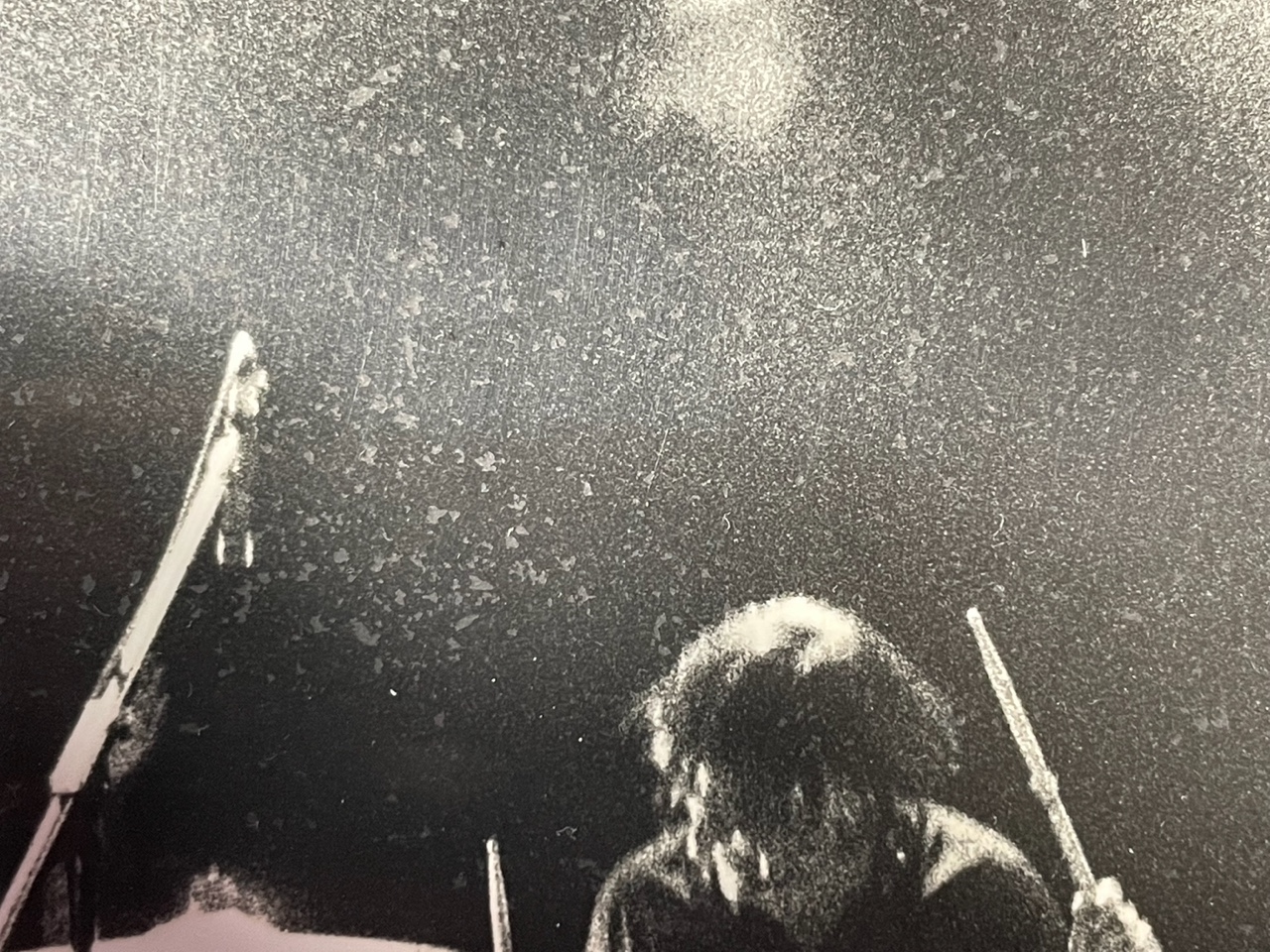

Hi! I am unable to use the ferrotype technique of drying the paper emulsion side on a plexiglass without those imperfections showing each time (see picture). I use clean unscratched plexiglass and I do get the lustre finish from the technique but always with those patterns. If anyone could advice me on how to best avoid it. Thanks!
I tried just about everything I have been able to find out, but I only managed to get a good ferrotyped print once or twice. Either I get the kind of zits you've got, or (more likely) everything just remains stuck together with no way to get the print off the plate. I've tried stainless steel, plexiglass, regular glass/mirrors and some types of film/foil. So in short, I think I don't really have any useful advice to you, other than perhaps take the easy way out and print on glossy RC paper...not quite like a ferrotyped FB print, but it gets close.

The artefact at the OP to me seems patches of supercoat being ruptured off the paper.

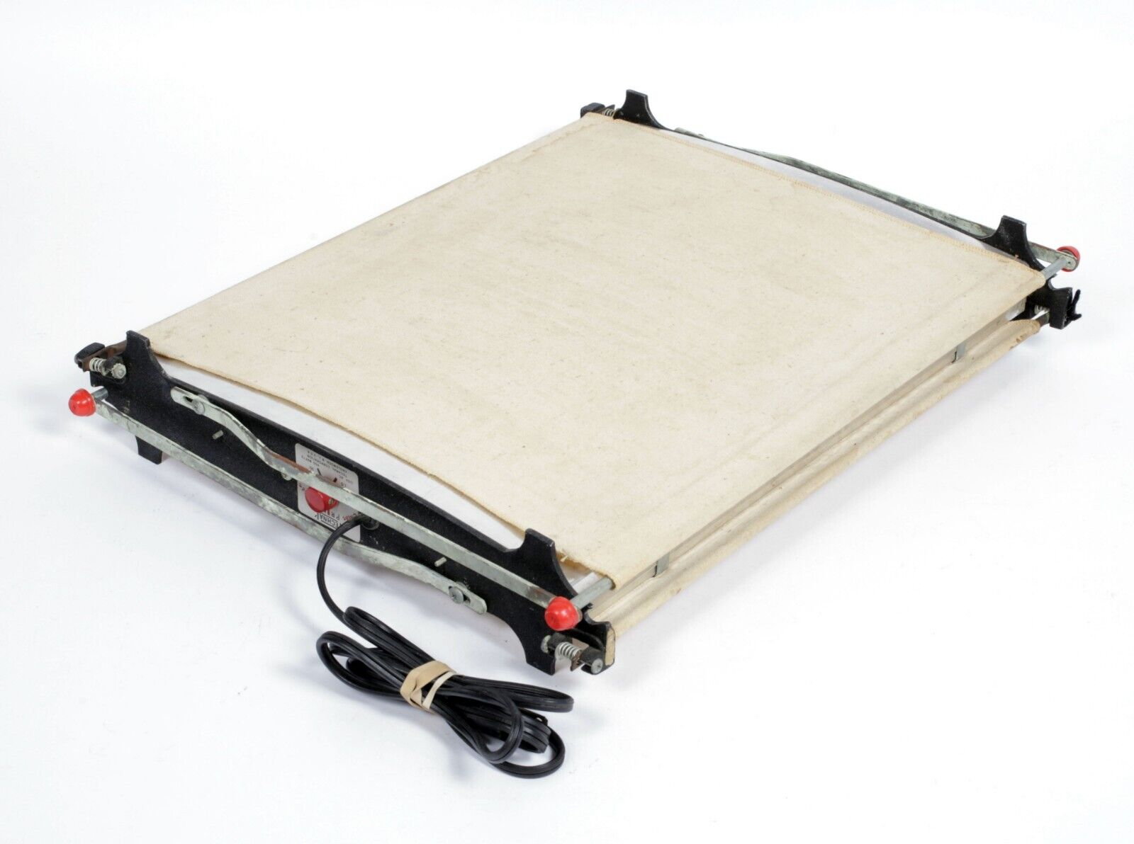

My ferrotype is an electric print drier, I rarely used it that way. The canvas is not great for archival, needed to washed after each use. Without plugging it in I put the pints on the plate and let it air dry until it popped off. In the "old days" before RC became popular commercial photogpghers used powered print driers, large ferrotype drums that could dry face up to the drum for glossy and face down for matt or simi matt with glossy paper. In the 70s I had a large drier, took up to 16X20, sold it when I hired on by UPI. Today I dry FB on large fiberglass screens, I can stack up to 8 high up to 16X20.
The pattern you are getting is most likely from imperfect contact with the plexi, or water has been trapped between the plexi and the print.
I originally came up with the plexi idea after trying ferrotyping plates and a few other ideas people had back over a decade ago. Everything else was just frustrating. The plexi idea struck me out of the blue because of the static that plexi has. I gave it a try and it worked. I threw it out onto the interwebs at the time and since have seen people reference it but no one does it right. One person even made it a video and mucked it up.
First off the plexi needs to be really clean and free from scratches. Use plastic polish to clean it. Then you need to put a very light coat of wax on the plexi. I use Butcher's wax but someone told me recently that it isn't available anymore*. You need a pure wax, not a silicone wax made for cars. A pure carnauba or beeswax should work. I thin the Butcher's wax with turpentine to get it to be as thin as I can get it. Soak the print in warm or hot water (I use hot tap water) then put it down wet on the plexi. Use a brayer to press the print onto the plexi. Don't be afraid t really press on it. I use a hard plastic brayer as well, not a soft one. If you use clear plexi then you can verify by looking through it that the print has perfect contact. Let the print dry. I put a towel over it so it dries more slowly and evenly. When it is done it will look like it is stuck to the plexi, but that is the static from the plexi. You'll never get the oyster shell patters from plexi like you will from chromed plates. In my experience you won't get any of the problems outside of imperfect contact like your print shows. You'll need something to catch an edge to get the print off the plexi. I use a guitar pick. Peel the print off and if you did it right it will be perfect.

For the price of a sheet of plexiglass you can find old electric print dryer, with a ferrotype plate. Polish the plate squeezy the print on to plate and let it day and pop off. If you wash the canvas cover you can try plugging it in as well.
