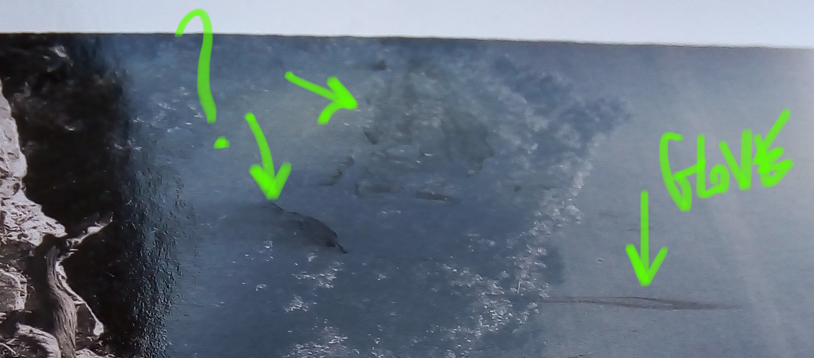

The title pretty much says it all. For the past few months, I’ve been focusing heavily on toning, but I’m finding it extremely difficult to leave the darkroom with a sepia-toned print that doesn't show even the slightest mark on its surface.
I’m sure you know what I mean. The defects I’m talking about aren’t visible when looking directly at the print, they are surface marks only visible when observed at an angle, where the gelatine looks as if it’s been etched.
There is literally zero margin for error: if a nitrile glove brushes the emulsion while the print is in the tray—at any stage—that’s a defect; if the print rubs against the side of the tray while washing, that’s a defect.
Handling the print by touching the emulsion in any way—whether with gloves or tongs—is simply out of the question.
I’m experiencing this with both Ilford and Foma papers, when using a ferricyanide bleach. I’m sure some of the experts here can explain the physical and chemical reasons behind this.
I personally print my 6×6 negatives in the centre of the sheet with wide borders, as I prefer framing without a mount. Even the smallest mark on the white margin is a dealbreaker for me.
All this is to ask: What is your level of tolerance regarding these defects? Is there a chemical solution to mitigate gelatine vulnerability?

Good point. I suspect what the OP sees are traces of fixer residue. @OP: Is your fixer clear, or do you see a light milkiness?
No, definitely no fixer residues—I’m certain of that. I always use sodium sulfite and then wash my prints for at least thirty minutes. The deposits we were talking about are a different matter, they appear as a fine white powder.
The marks I am referring to, when observed at an angle clearly affect the emulsion, which appears slightly etched. They only show up during sepia-toning sessions. Every time I accidentally brush my glove or anything against the emulsion, I can clearly identify them once the print is dry.
I use the classic formula (Anchell’s “Formulary Thiourea Toner”). I’ll try diluting it, the redevelopment is extremely quick so there might be some margin to reduce the concentration.
It's certainly possible that the high pH of the sepia toner is ultimately related to your problem. However, I doubt that diluting the toner will be the solution, for two reasons:
1: Diluting the toner will not drop the pH all that far. It'll still be fairly alkaline.
2: If you dilute the toner, this will make the toning time longer, which means the gelatin is exposed for a longer period to the alkaline environment, giving it more time to soften. So this may in fact turn out to be counterproductive.
The problem with a thiourea toner is that it needs to be very alkaline to produce a satisfying chocolate brown tone. If you were to adjust the thiourea:hydroxide ratio (in order to make it considerably less alkaline), this will dramatically shift the image tone and also final density. At a lower pH, thiourea will become a yellow/tan toner.
A more promising avenue IMO would be to use a hardener after the toner; something like an acidified bath of alum (the common hardener used in conjunction or even as part of paper fixers) should help.
However, I'm kind of puzzled about this problem to begin with, since I've never noticed emulsion damage as a result of toning. My normal workflow (mostly using Foma papers) is to actually squeegee the prints after washing them. That's a heck of a lot more aggressive than just brushing a glove across the surface. Yet, I don't see any effect on the emulsion. So I wonder if perhaps something entirely different is going on.
A picture showing the problem might help.
Here it is.

I do wonder if this really isn't the same issue as also discussed in the thread, i.e. white precipitate that creates a subtle veil over the print, that brushes off readily, leaving 'spots' on the print that are actually as the print should be. Can you try processing one example print and in the final wash, wipe the print surface underwater with a non-abrasive cloth? Do this only on one half of the print, leave the other half untouched. Then dry as normal and inspect the result.

Although it is difficult to really tell, the picture you posted looks like the print might have a scum on it. You might try cleaning it off if that is the case. I don't recall ever getting a scum with Thiorea but other toners such as Hypo Alum will leave a scum. It is possible that the water you are using combined with the toner is leaving a scum. Easy enough to clean off if that is the case. A cotton ball with alcohol will do the trick usually. Or if that doesn't work, a weak acid like stop bath should do the trick. Just throwing it out there in the off chance that is your issue.
