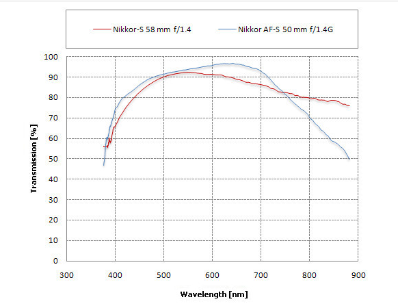

To summarize my previous post, let's see this graphic:
Light transmission of the 1960 Nikkor-S 58/1.4 (single-coated)
versus the circa-2010 Nikkor AF-S 50/1.4G (nikon modern super integrated coating)
More than 50 years of diffference... Yet the light transmission is the same at the 500nm wavelength (see my previous post), and even better in the older lens from 800nm onwards.
The modern lens seems to have been optimized for max performance at the green spectrum (again, see my previous post), and to try to supress infrared radiation.
BTW 91-93% of light transmission for a normal lens is pretty similar to what many multicoated lenses in the 1970s would achieve. See 2nd picture for an example.
Source:lenstip.com

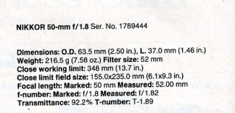

Late 1970s test, Pop photo. See "transmittance". Multcoated lens.
