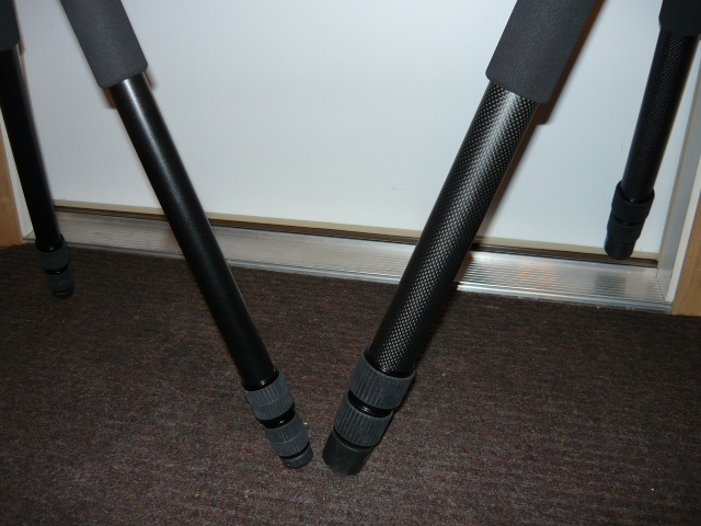

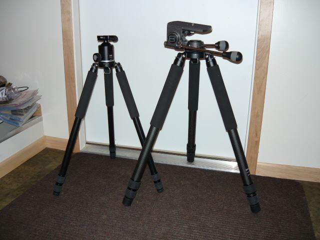

jeroldharter
Nov 6, 2005
1,955
Wisconsin
Pics
Here are some pics of my gear which might help you compare.
