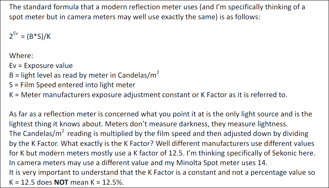

There's a difference between how to and why. RobC misinterpreted what K was and instead of getting into a unsubstantiated he said, he said discussion, I went to the source material.

Rob, didn't you use formulas in your paper? I guess you misinterpreted them because you weren't really interested in using them. BTW, it was Jones, not Mees. Mees edited the first two editions of The Theory of the Photographic Process, but Jones wrote the papers and wrote the chapter on Tone Reproduction Theory. And the definition of plagiarism is when someone takes credit for another person's work. I reference and quote the papers I use. Don't you get tired of always being wrong?

Bob, the example with flare that I gave shows how 12% scene reflectance is the middle of the Illuminance range at the film plane. Part of the topic is what is the middle, and that addresses it. I also quoted Jack Holm as a source to support the idea.

You've got the intellectual capacity of a fart. You still think this topic is about you and what you say. I have repeatedly told you its meant to be a simple method of undertstanding what a grey card really is and what it means and yet in your moronic and delusional state of mind you think I'm in the slightest bit interested in proving you right or wrong? You are sick or a complete arsehole. I thought the latter but I now begin to think both. No, on reflection I think an arrogant and delusional little shit who hasn't offered anything to the discussion except confusion.
Keep going and you'll get me kicked off the forum...
Correct me if I'm wrong but didn't you write this?
My response defining what K really is was a response to what you wrote. Let me get this straight. Your using the calibration equation from the exposure meter standard is the simple method but anybody else uses it, it's not?
