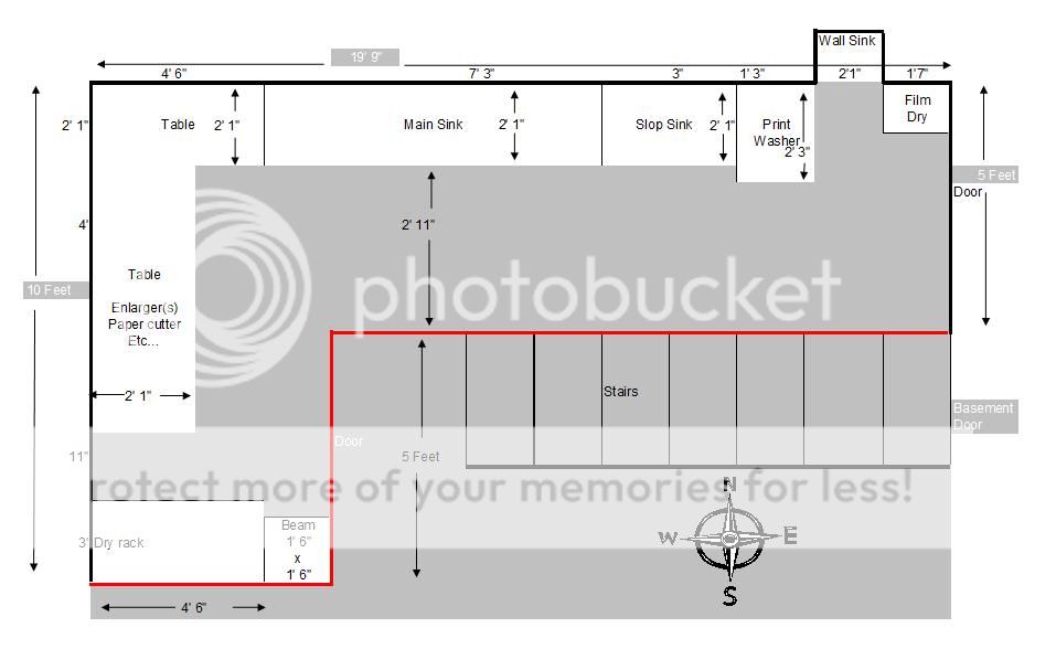

Folks -
I am considering building out a darkroom in my already finished basement. My wife and kids kindly allowed me to annex about 1/3 of the basement to my hobby. I shoot 35 and MF and print up to 16X20. I have a 7’ 3” photo sink and a 3' deeper Kreonite fiberglass darkroom sink that I call my “slop sink”, a 16X20 washer. My space already has a small built in sink but that might just be re-purposed since I will have the aforementioned sinks already. The bold areas in red need to be constructed (drywall, door). The areas in gray are where you can walk.
Flow goes from the SW corner to the NE corner and back to the SW corner to dry the prints. Film drying area will be in the NE corner.
Any thoughts on layout? Any pitfalls you see here?

Congratulations!
I would suggest doing a drawing that is to scale. Hard to envision things as it is.
Looks quite workable.
Are you sure that the "table" for the enlargers and paper cutter is deep enough? 25 inches of depth isn't a lot if you are printing 16x20, and it is really shallow if you should ever try 20x24.
2F/2F - Thanks, yeah jusk kinda 'hacked' it in Excel. Dont know CAD or anything like that. There a freeware or anything you recommend?
Matt great point that west table prob does need to be a bit deeper, 3' could easily be done there is room. My max footprint of enlarger is 2' 1" but why not give it some more room if I ever want to do a larger print - 3' or so seems great!
I wouldn't make the tables any wider than they need to be. Looks slightly cramped to me. I wouldn't make it any tighter. Instead of using a wider table, you can make the one you are planning now a drop leaf table like we do at the lab where I work. You can install mounts in the table itself to mount the column, instead of using the baseboard. We have it set up so you can enlarge onto the normal table, remove that table and enlarge onto a lower shelf, or remove both and enlarge onto the floor.
I have even seen single-column enlargers mounted directly to the table at a 45 degree angle to the corner. Not sure that is the best way to go here, but it is something to think about. It takes up more space laterally, but it can give you a bit of extra depth. In this case, it would give you about 35 inches from the corner, instead of 25 inches from the wall. Maybe it wouldn't be a bad idea to just install the mounting hardware in the corner. Use the factory baseboard most of the time, square to the wall, but move the column over for times when you might want to make larger prints. This is all only if you have a single-column enlarger, however.
You can also mount the enlarger on a raised platform if you have the headroom.
Personally, I think the dropping leaf design is the most simple, elegant, and effective way to go. You may or may not want to combine it with a slightly raised enlarger. (We use both methods at the lab.)
I don't know any computer programs for drawing. Pencil and paper is how I usually do it.

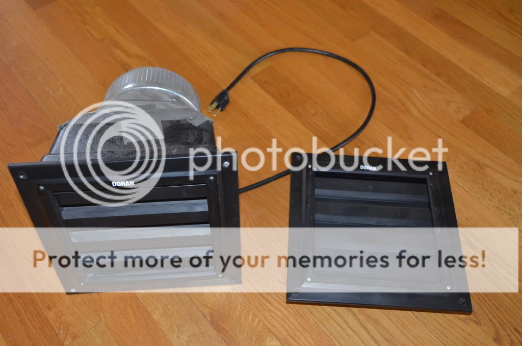

Be sure to have a proper active ventilation system. Also make sure that you have a filter built into that to help with dust.
And make sure you have a safe (dark, cool, dry, but not too dry) spot to store your papers and films outside of the darkroom. The darkroom itself is not the best place to keep your papers, films, prints, and such.
Also, I think you need much more room to maneuver in front of the print drying cabinet. 11 inches won't be enough.
Over all, I would sacrifice a little bit of table surface for a bit more maneuverability. Table space is overrated in darkrooms. You can build shelves, cabinets and drawers to help with storage. Sink space and moving about space are not overrated, however, especially with larger prints.
A proper viewing hood is lacking in most darkrooms, and one's importance cannot be overstated. Try to set up a space that will most closely simulate the light in which the prints will be viewed. Overhead tungsten spots seem to be common in museums and galleries.
P.S. Where on Earth are you going to put the Kreonite? :D

2F/2F - Great idea re drop leaf, well see if contractor can do something. Yep ventilation is in the the bid. My main bid is walls, move light switch into darkroom, door, plumb sinks, venting. The rest I might do (tables, dry spaces (film and paper). It all depends on what the cost for the 4 main things I want (elec, exhaust, plumb, walls/door). Thanks for the heads up about the clearance re the 11” infont of drying rack, will think about that more! Viewing hood, humm will have to investigate, thanks for a thought re that!
Re the the Kreonite, it is in the orig drawing, I refer to it as a “slop sink”. My main sink is your typical wood 7 foot not-too-deep photo sink. My Kreonite, is deep, maybe 9 inches deep and 3 feet wide. It is where I plan to clean my trays, etc, that will contain splashing, etc.

Jeffreyg - Great idea re sink lid, will have to look into! Yes exhaust is in the bid (see my reply above to 2F re my main specs (basically walls/door, elec, plumb, vent).

Silveror0 - I agree with you completely re it being too early for getting bids. But I gotta plead my case. I am getting new siding/gutters/roof/windows as we speak so my contractor and I got to talking about all that stuff in my garage that I have been collecting for my eventual darkroom. I showed him Apug's darkroom gallery to show him what a darkroom looks like, then I walked him through what I believe I mainly want (walls/door, elec, plumb, exhaust) and asked for a bid on that. Then a bid on building tables. Then a bid on building out all (cabinets, shelving, drying racks). So while he is around my house I got to thinking it might be best to have him ponder the costs, etc while he is here. I told him that I might not build till April or whenever I can pay for it because all the housework here is already doing is enough as it is!
You say: "Plumbing - behind the walls vs. accessibility for repairs, supply/drains" Why would I want behind the walls? If I sell the house I can tear out, re-mud, paint, re-carpet and be done. I cant see a reason to plumb behind the wall? Anyone disagree? My family wont really be in the room so they wont object to unsightly pipes.
Floor yeah was thinking those floor grids in restaurants? Thoughts?
How to best block light leaks around doors/windows – Yes I am with you, in the NW corner is a window that will either be blacked out or used for the venting/intake, I asked contractor to bid it both ways (use the window or vent elsewhere).
Ic-racer – table top cabinet is something I am considering. Heck every few days on Craigslist someone will post some cabinetry for free, might just grab some? Your darkroom is a palace!

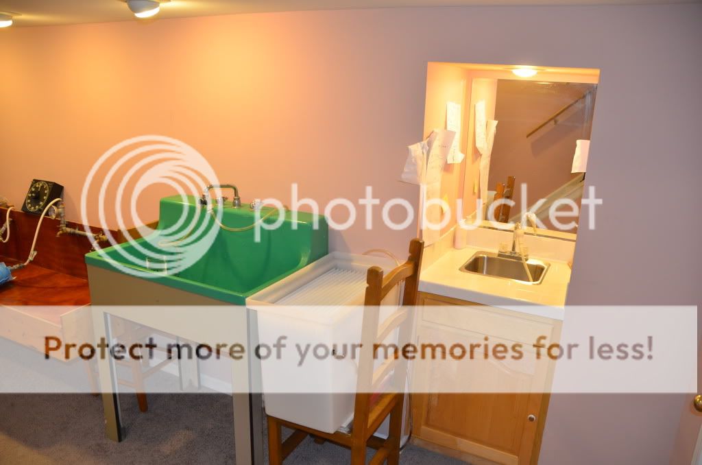

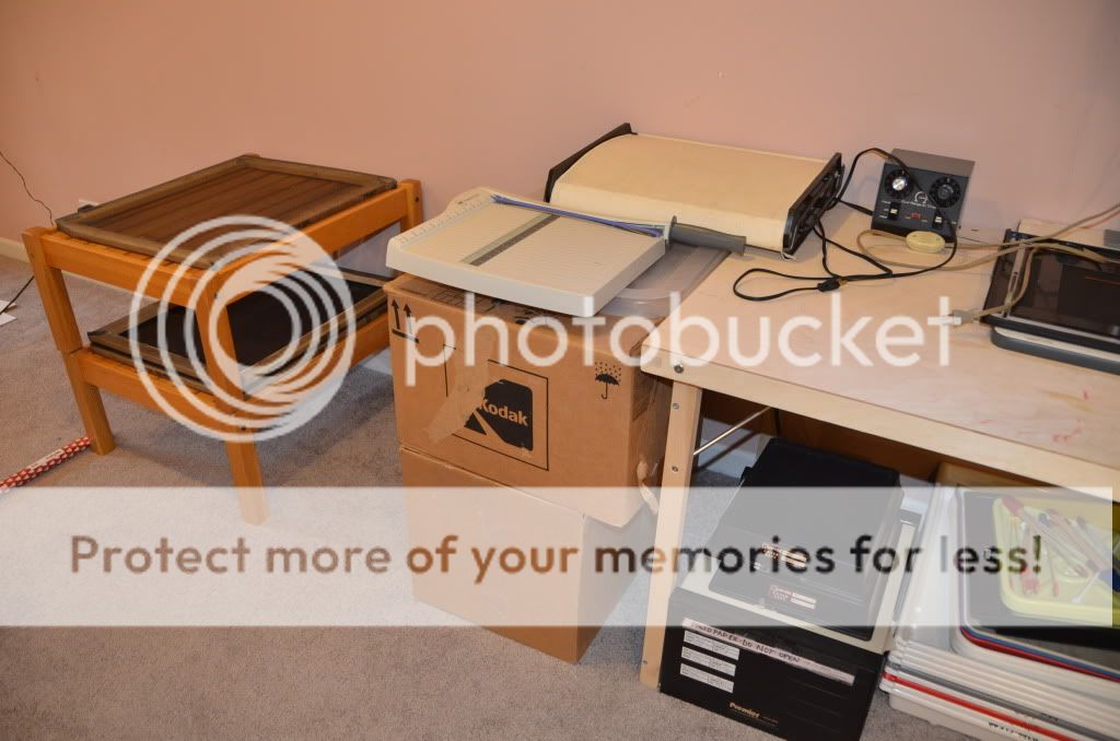

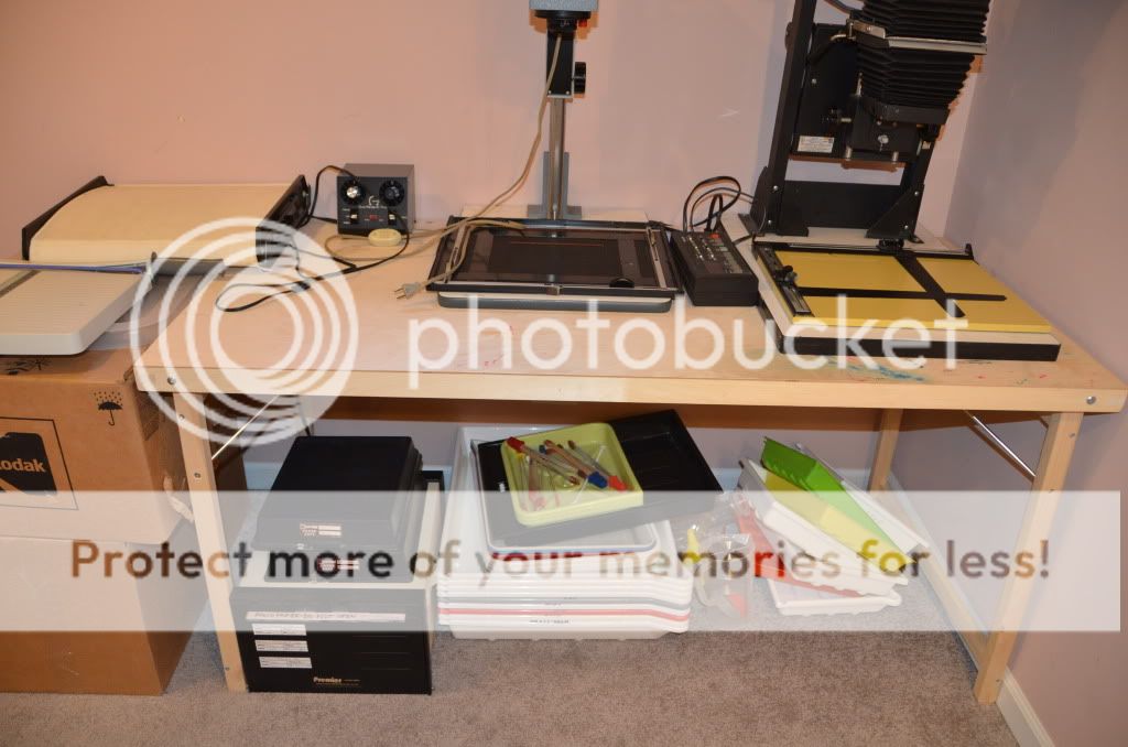

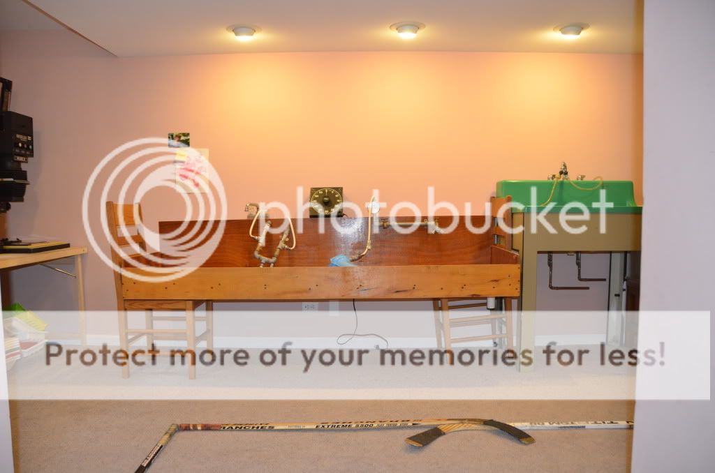

Alright folks, I did a dry run, set up everything. Before anyone comments, this is a dry run, I have never printed here on carpet and never will, carpet will go. I think after all the wonderful comments re realism, I just set her all up and I LOVE it. The 2 hockey sticks will be the walls and the single hockey stick a door.
Note that "print drying rack" is really just two pieces of furniture I stacked for illustration but the size is roughly what I am thinking. I threw some drying racks on it so you get the idea. 2F/2F, thanks for the 11" comment, I now am thinking maybe 1.5 feet or something. The roll of wrapping paper is wall that will extend from the beam to the already there wall by my "pseudo drying rack".
Also the Kodak box and dryer/paper cutter on it represents how far I am thinking the table should extend. That table the enlargers are on is 2' 5". I cant see going bigger, but pondering drop leaf like 2F/2F thought of. Note that table you see is a $30 Ikea table that I will never use, it is for illustration.
Still trying to digest all this, but I am now starting to think that I dont want a table butting up to the main sink (NW corner) like my orig drawing showed. I never would have realized this without doing a dry run, thanks so much all for your comments encouraging realism!
So now you have a better sense, any comments? You are all so kind!
Chairs that hold up the main sink and print washer are illustration only.

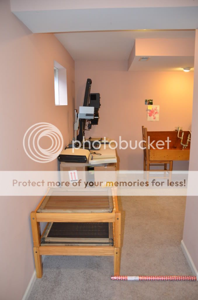

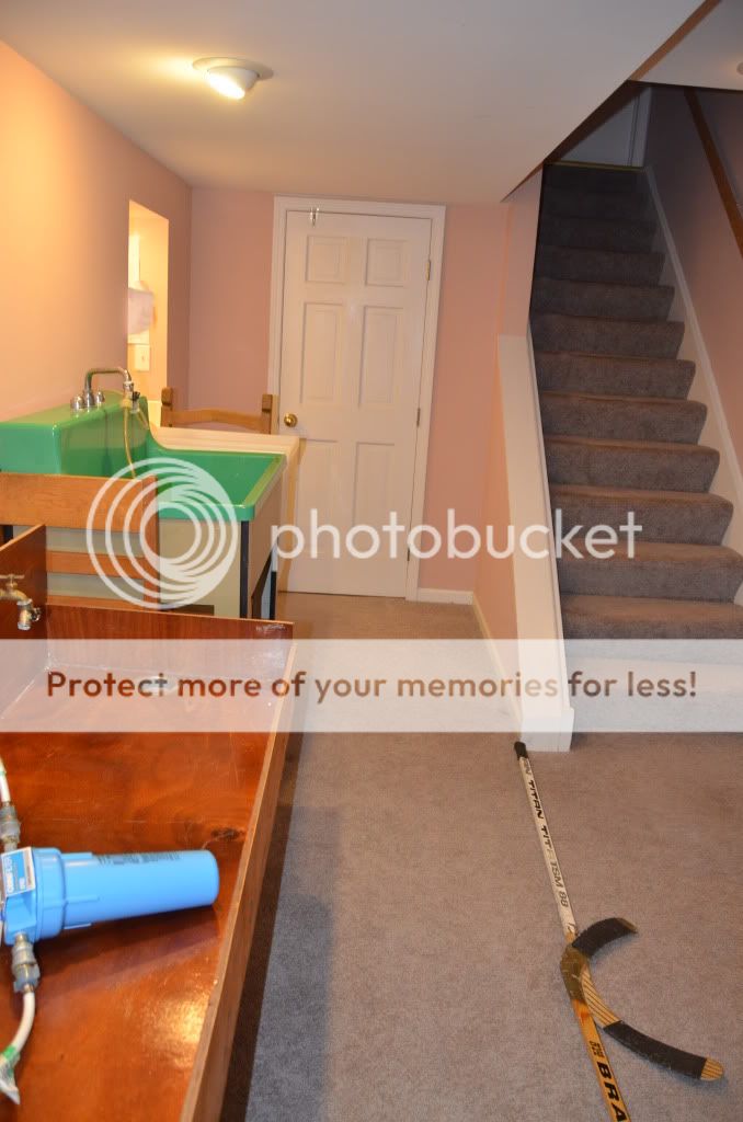

Shot from basement stairs:
Shot from inside furnace room:
Shot towards stairs and furnace room door:
Oh and before anyone thinks of it - the house came with the pink walls (prior owners had a bunch of girls). Pink will go, prob white liek 2F/2F thougt, unless anyone has any other paint thoughts?
Need to ponder some of the recent above comments after the dry run...will reply later...but thanks all for your comments and especially Mark for the invitation, think that might be in order. I have no 'analog friends' in IL.
Nothing like mocking up with real stuff! Looks like you can make it work. Remember, the items will be back from the wall a bit if you have open plumbing. For purpose built darkrooms, drop tables are nice, as said, so you can have the enlarger up higher like 32 inches or even 36 inches rather than the 26 inches which is common table height. If you mount it too high you can always build a low 3 inch box to stand on if you need to. I built a workbench high, the height of which I found by the best combination for close work leaned over only very slightly plus my natural bend of arms while planing. I'm very glad I did.
Re paint: I'd suggest light bright spectrally neutral gray all over, but 4 feet and 2 feet of matte black in the enlarger corner. Reduces splash of light while burning and dodging.
