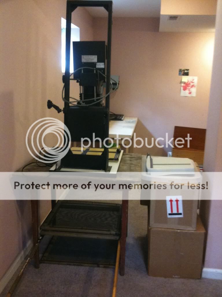

Can you do another diagram/sketch, so we can compare the original with the new?
I ask, because I'm getting turned around as I try to orient myself in your dry run.
In particular, I'm wondering whether the nook that is delineated by the wrapping paper might make a perfect location for your larger enlarger.
My only hesitation to that is if the dry rack gets ever near the main sink then splashes might get on the prints? Or can that be mitigated by making a contained covered dry rack or does that promote mold? Will try a new sketch but might take some time as my pc is tied up for a bit. (sent from phone)
Splashes should be no problem - If you are concerned a short piece of easily retracted shower curtain between the two should do the trick.
The sketch is always handy - a "birds eye view" reveals some things that photos can't (and vice-versa).
Matt - Ohhhh, I am liking this! I think I can have my cake and eat it too. What if I moved the larger enlarger to the SW nook like you thought and then on that nook, built a dry rack???!!! Seems like this would work. And it opens up the darkroom a bit more!

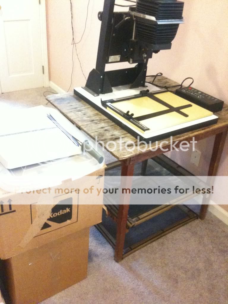

Think the Kodak box would be more table. Mod'ed the table with the hockey sticks of course to show a dry rack (note this rinky table wd never be in my actual darkroom):

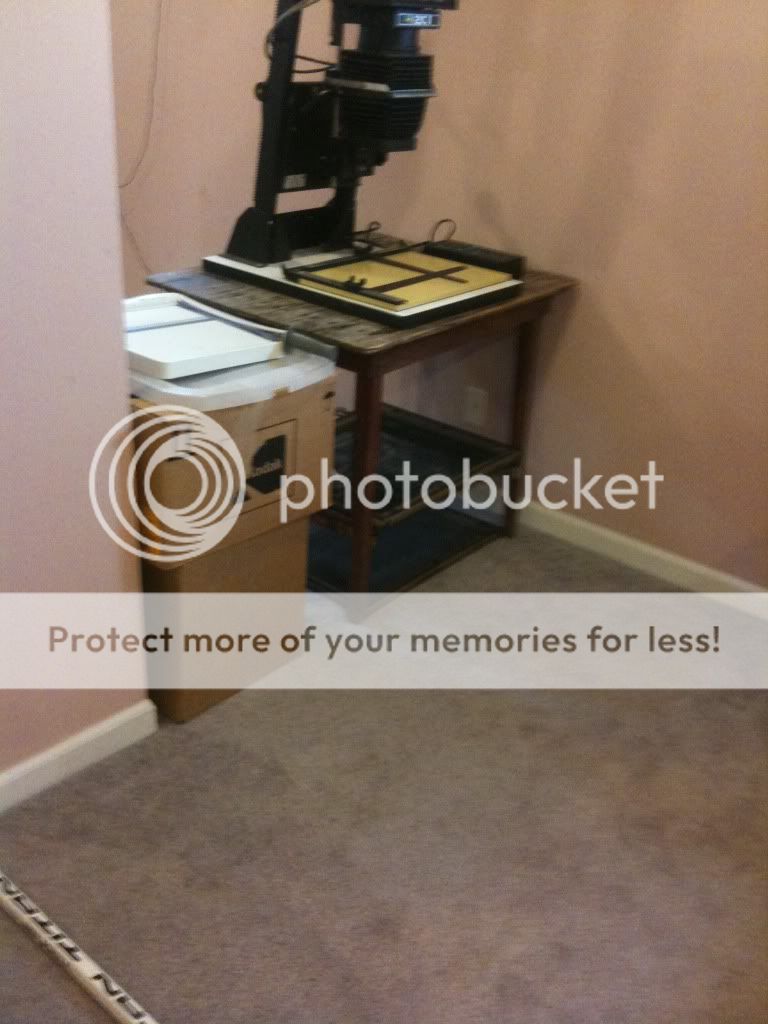

Rear view, this would be wall:
The white hockey stick on ground on below photo would be door:
Humm...liking this, not as cramped!
You need to layout to scale.
Second is a corner table upper right. Ok for storage, not for work as reach is too far.
